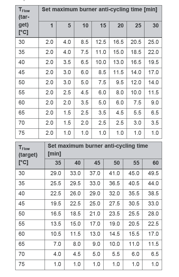

You also said you "have upped the 5 min timer to 15 mins", is this the overrun timer d.001 or the anticycle timer d.002, the overrun timer is a fixed time, what ever you set to, but the anticycle timer uses a look up table based on the set time + the target temperature.

You are getting S.07, pump overrun, this normally only happens if the boiler is programmed to stop it, or you stop it, some fault conditions may also probably flag it, otherwise, if say the flow temperature exceeds the target temp by +5C or the flow/return dT exceeds ~ 30C then it shuts the burner down and runs the anticycle time but you should get S.08 in this case. The default anticycle time is 20 mins but the actual time is based on the table, below, if you find the boiler has difficulty in getting away after a recycle then you may need to increase this time, to give say the equivalent pump overun time of 15 minute which you have set.

If d.002, anticycle time, is set to its default of 20C then the actual anticycle times at boiler flow target temps of 50/55/60/65c are 9.5/8.0/6.0/4.5 minutes, if you require the burner to stay off for 15 minutes after every (anticycle ) trip then for boiler flow target temps of 50/55/60/65C set the anticycle time to 30/40/50/60 minutes.

Currently 51C, as it was overshooting so badly before I set it lower to give more headroom before it kettles. I have set 35 instead of 20 mins for the d setting
