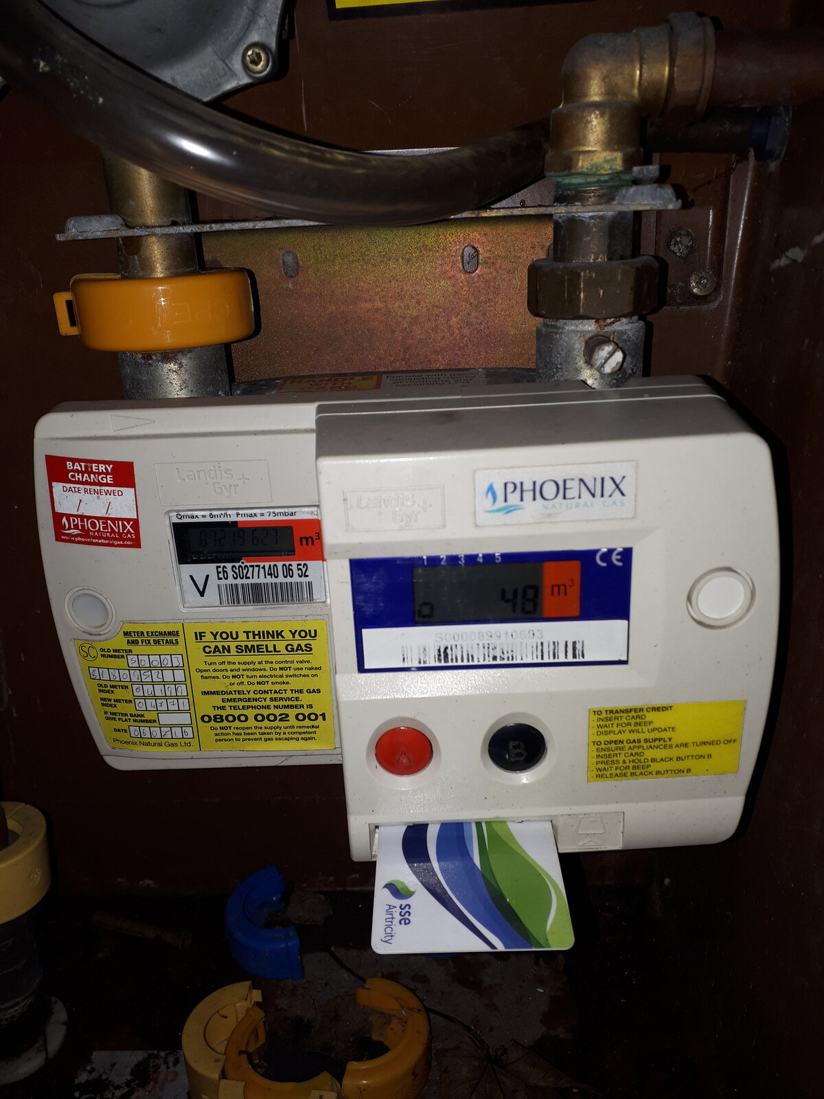

Hi recently my pre paid gas ran out. I checked and I had 15 credits. I know my mums boiler had the same issue where it shuts off if there are only 15 credits left. She tells me an engineer comes and does something that takes 2 seconds and its working but he never told her why. Its a Vaillant boiler I tried topping up another £10 and put the card in to release gas and gas meter shows "o" which I think means on. No gas appliances in house to check gas supply. Anyone any ideas?
Post a pic of your meter and the display also your boilers display
There you go. Hope they are clear
Yes the A button doesnt seem to do anything. If I press B it tells me to hold it then says release for gas. Tried this several times and doesnt seem to help.
Does it state anything after releasing for gas? Eg opening valve?
It just beeps when I release it.
According to the manual the o in the bottom left shows that the gas valve is open so I dont think its the meter.

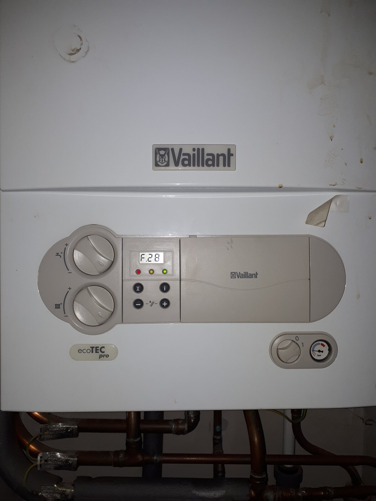

Top up the water pressure on your boiler using the filling loop ,till the needle is in the middle of the grey area on the gauge.
think OP is confused. he only needs to press reset on the boiler ( top left button). He thinks the problem is still with the gas meter!
Ive tried many times to reset the boiler but getting the F28 error. Can anyone advise how to top up boiler pressure? Thanks
I’m not sure why topping the pressure up on the boiler is required? I’ve not had to do this with an F28 error code before (n)
Is the condensate trap blocked, pipe blocked or frozen?
Can you post a phot of gas meter from a bit further back? It looks like an upso/opso setup, which may be the issue.
What do you do to reset the boiler ,and exactly what happens after reset ?
Find your filling loop to top up boiler pressure

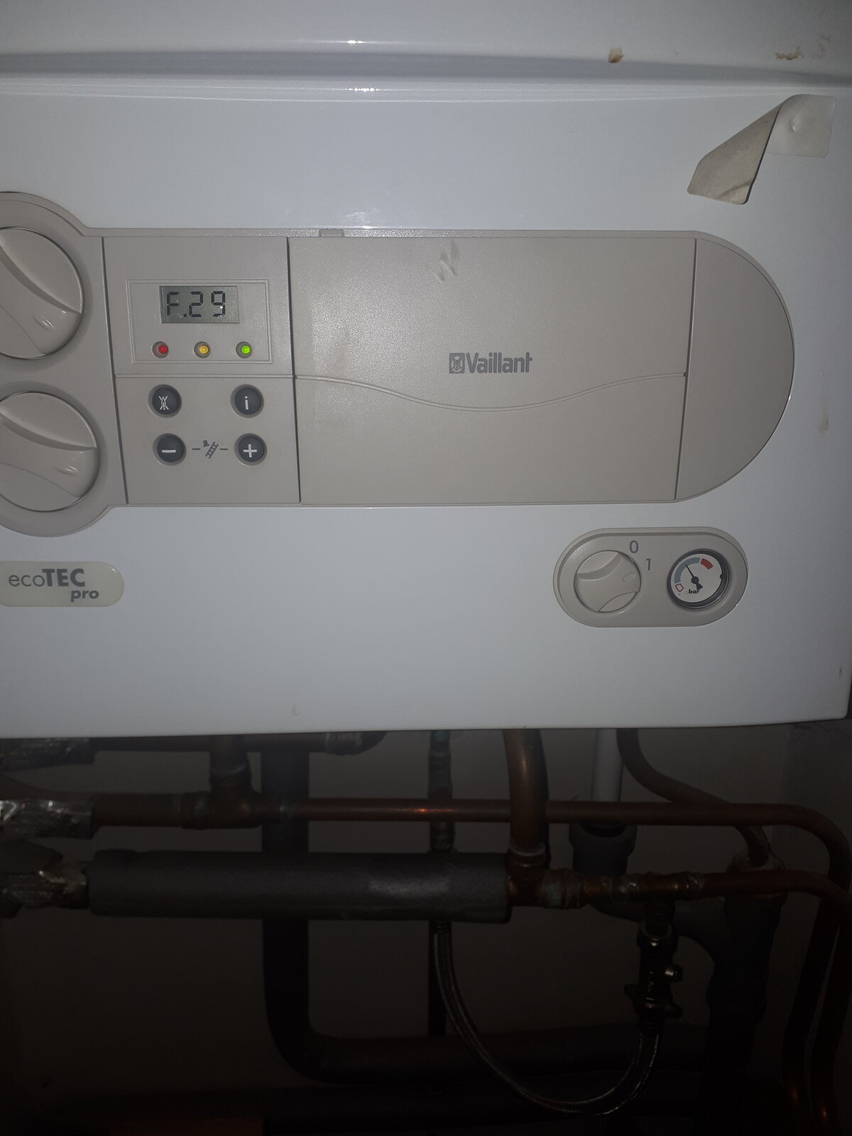

Fwiw sometimes I get the F28 and sometimes F29.
Is it normal for the green light to be blinking when resetting?
