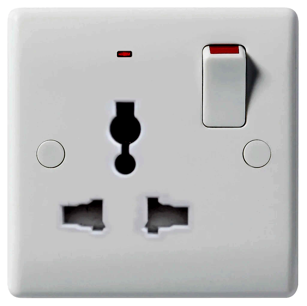

With Part P it states it should comply with BS 7671 or similar, so one could if you wished build a home to German standards, and it would still comply with Part P, not sure how the LABC inspector would read the German regulations to ensure it did comply, and since the scheme providers all ask for it to comply with BS 7671 it could not be passed by them.
However we are talking about shaver sockets, 553.1.2 says "every plug and socket-outlet shall be of the non-reversible type" but the is an exception for clocks and shavers, (553.1.5) my old 2008 edition does NOT include tooth brushes.
There is also need for no larger than 3 amp fuse, but if you want to charge 4 shavers there is nothing to stop you having 4 grid shaver sockets and a 3 amp fuse except in the bathroom, but a socket like this BG-socket.jpg would allow the reversing of two pin plugs so allowed by Part P but not with BS 7671, personally I see no problem with the socket. We used them all the time in Hong Kong.
But sockets for tooth brushes were not permitted by BS 7671:2008 as to if BS 7671:2018 has added tooth brush to the clock and shaver I don't know?
