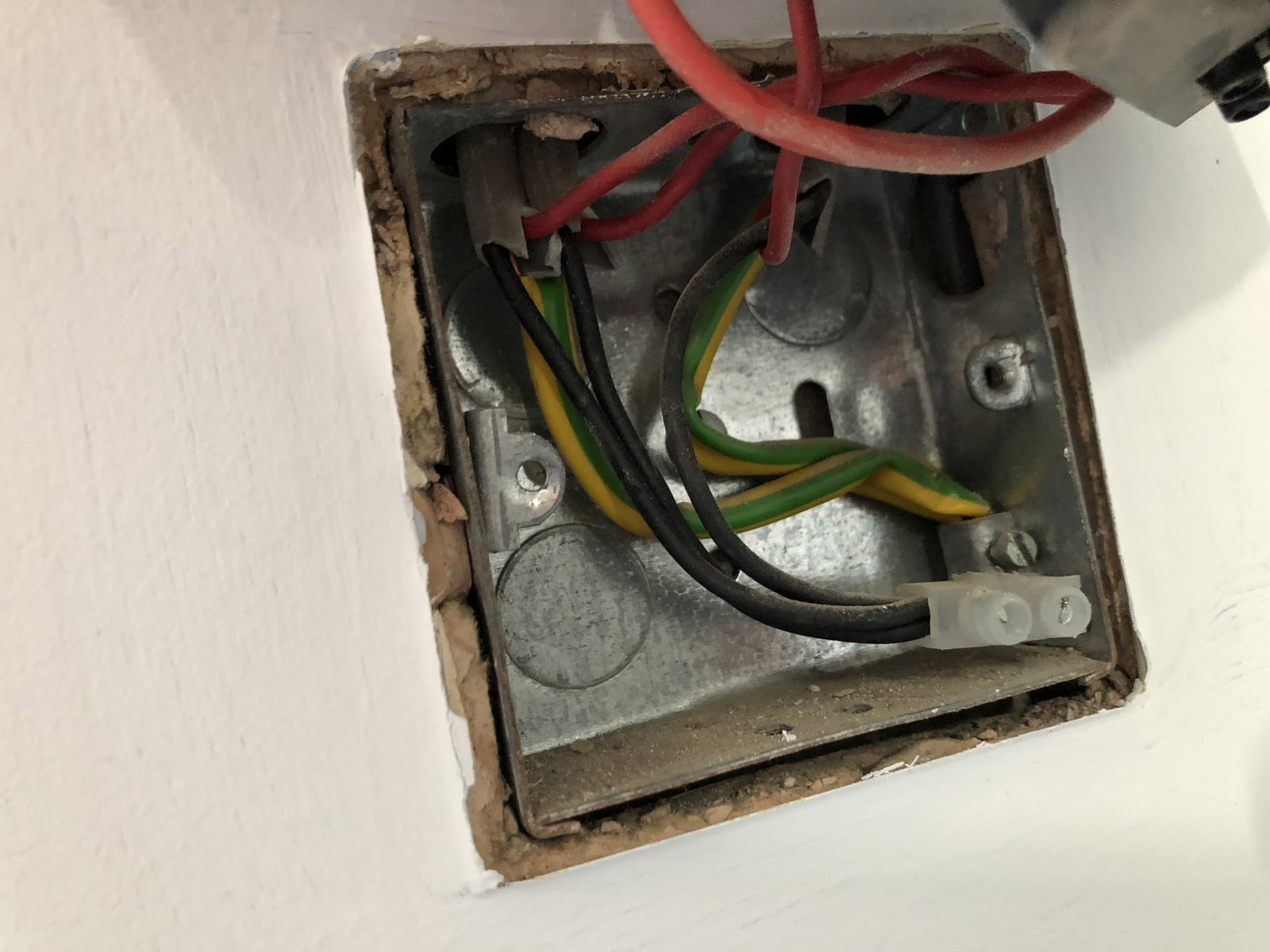

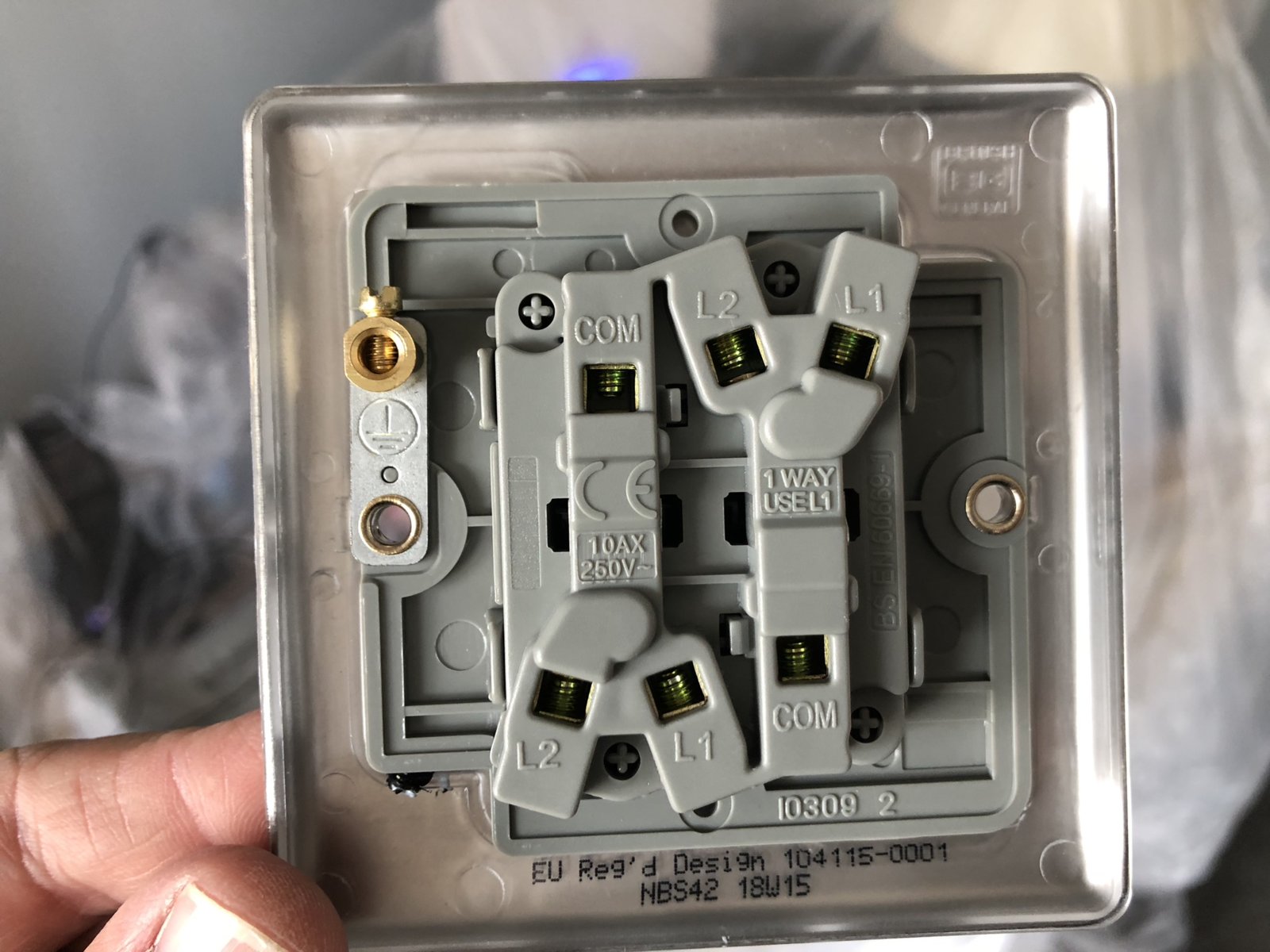

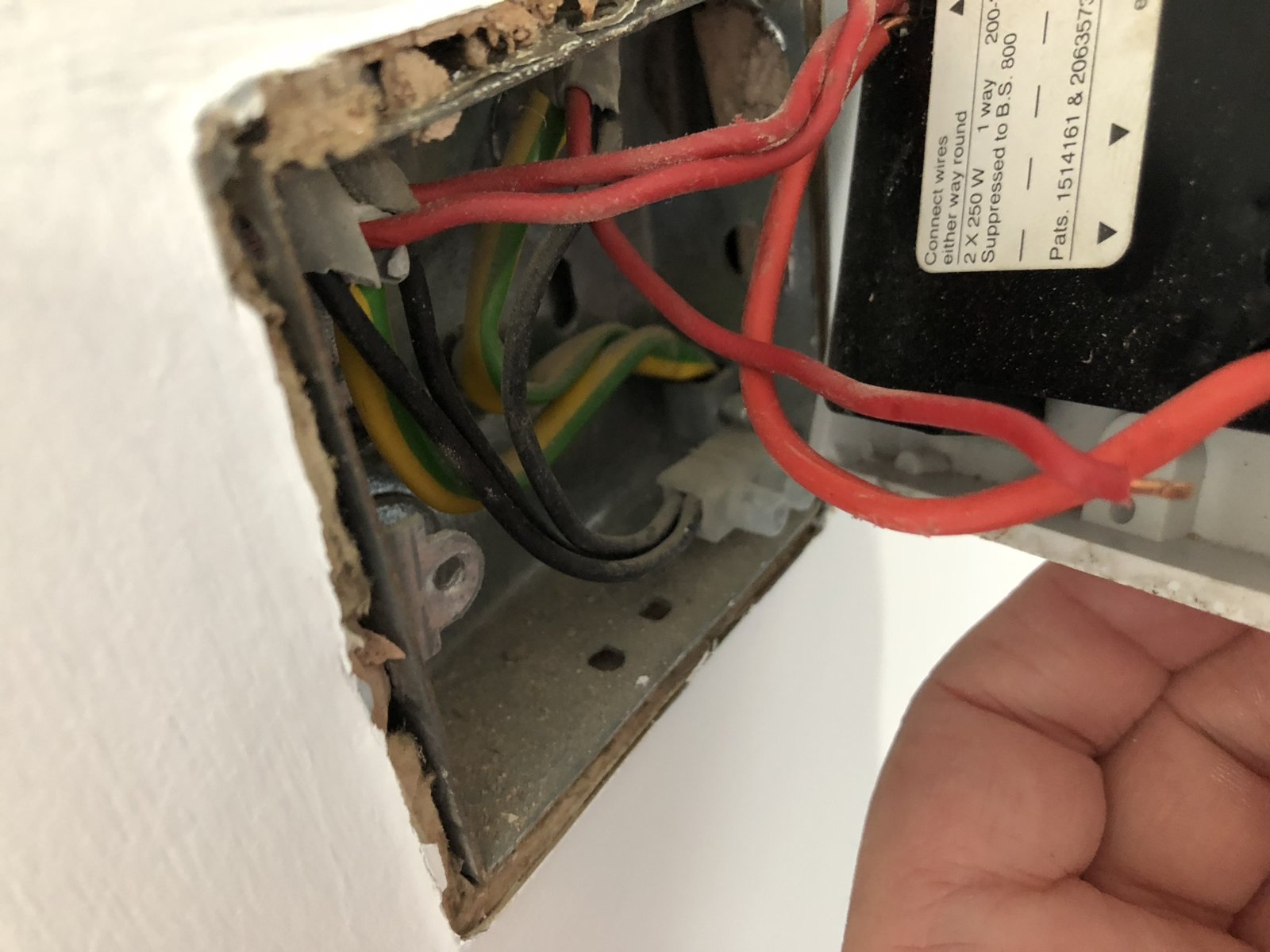

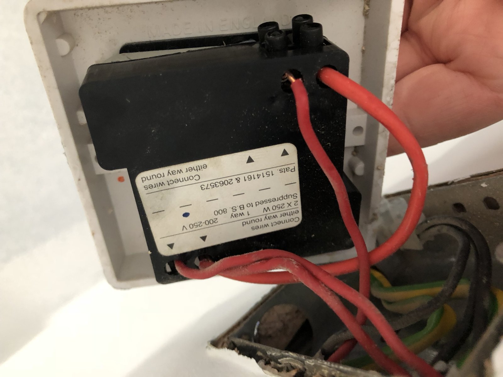

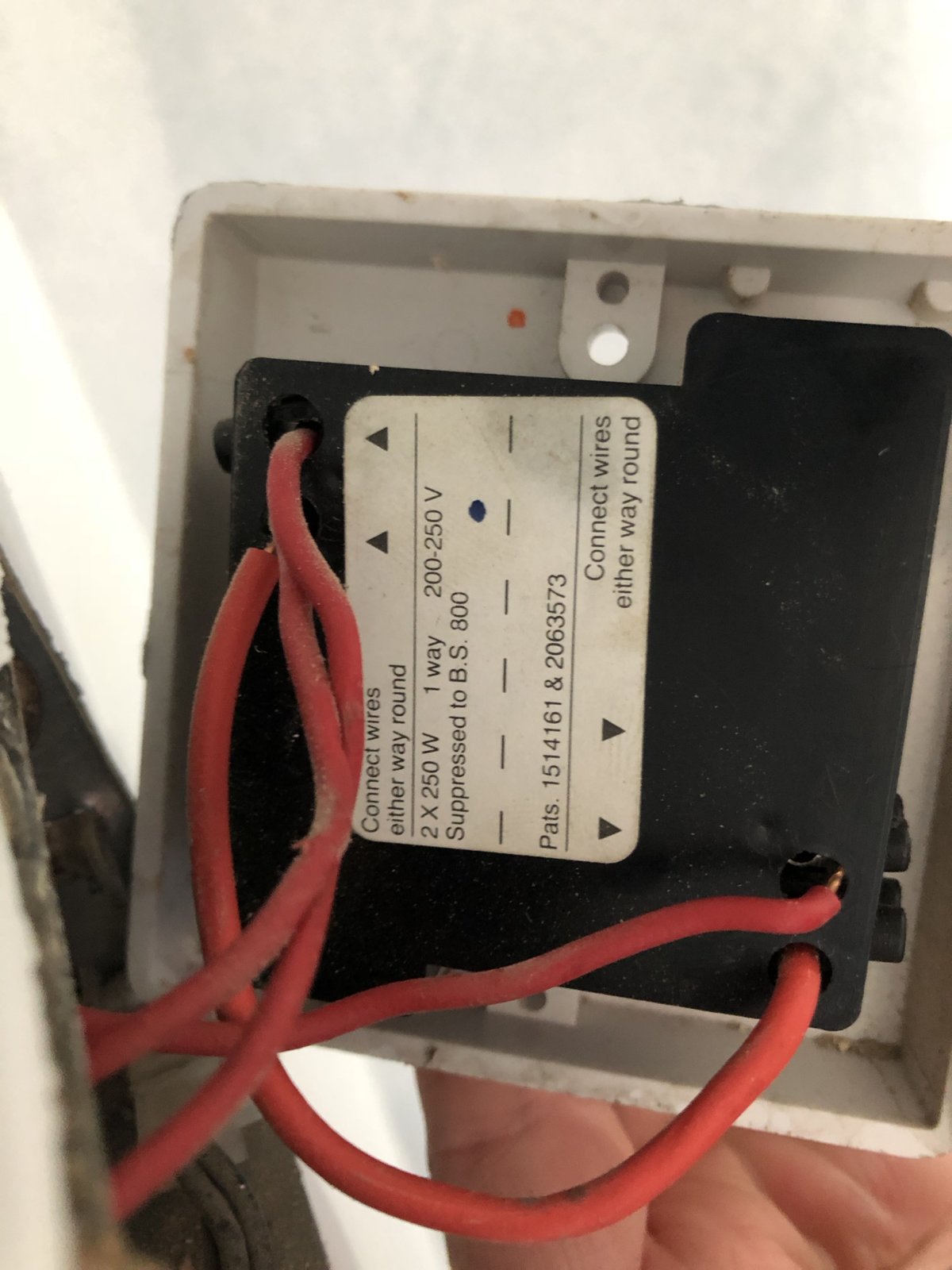

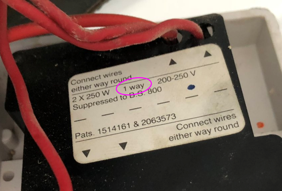

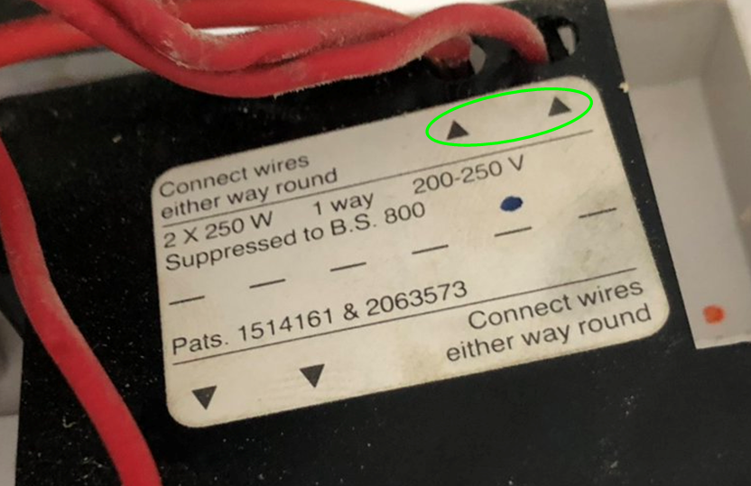

Hi,
I've decided to change the light switches and plug sockets in my living room after decorating and I'm struggling to replace the main light switch. At present I have a 2 way dimmer switch which I want to replace with a standard 2 way switch but unsure how to wire up as there are no labels / markings on the inside of the existing dimmer.
Attached are some pics showing the existing dimmer and wiring and the new switch I want to fit.
Any guidance would be greatly appreciated.

As far as I can see it is not two way, it is just two pole, as to of it needs to be two pole don't know.
So question can you work the light from two different switches?
No, its just the one dimmer that controls two lights - one living room and the other in the hallway
No you don't.
Those go to one gang of your new switch, the others to the other.
Please spend a bit of time learning how it works - you ought to understand what you are doing, not be fiddling with wires without knowing.

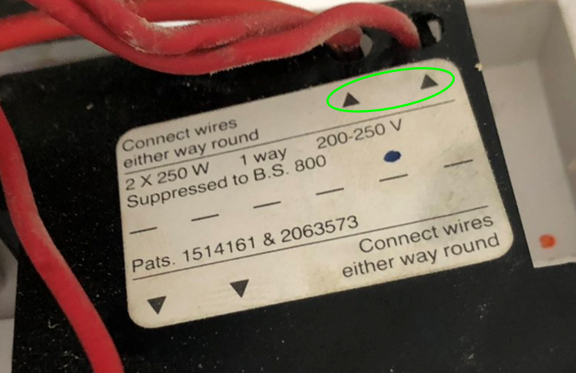

What I should have said was the label doesn't give much detail to the layman and isn't straightforward - the other switches that I've replaced like for like had COM, L1 & L1 markings so they were easy enough to change over. The label on the dimmer doesn't tell me anything.

As the new switch has a metl front plate ALL the earth conductors in the cable MUST be connected securely to the Earth terminal on the switch plate.
Label the Live Feed conductor before disconnecting and "losing" it.
The two Comms nust be linked together.
It tells you "connect wires either way round", which is what applies to COM&L1 or COM&L2.
