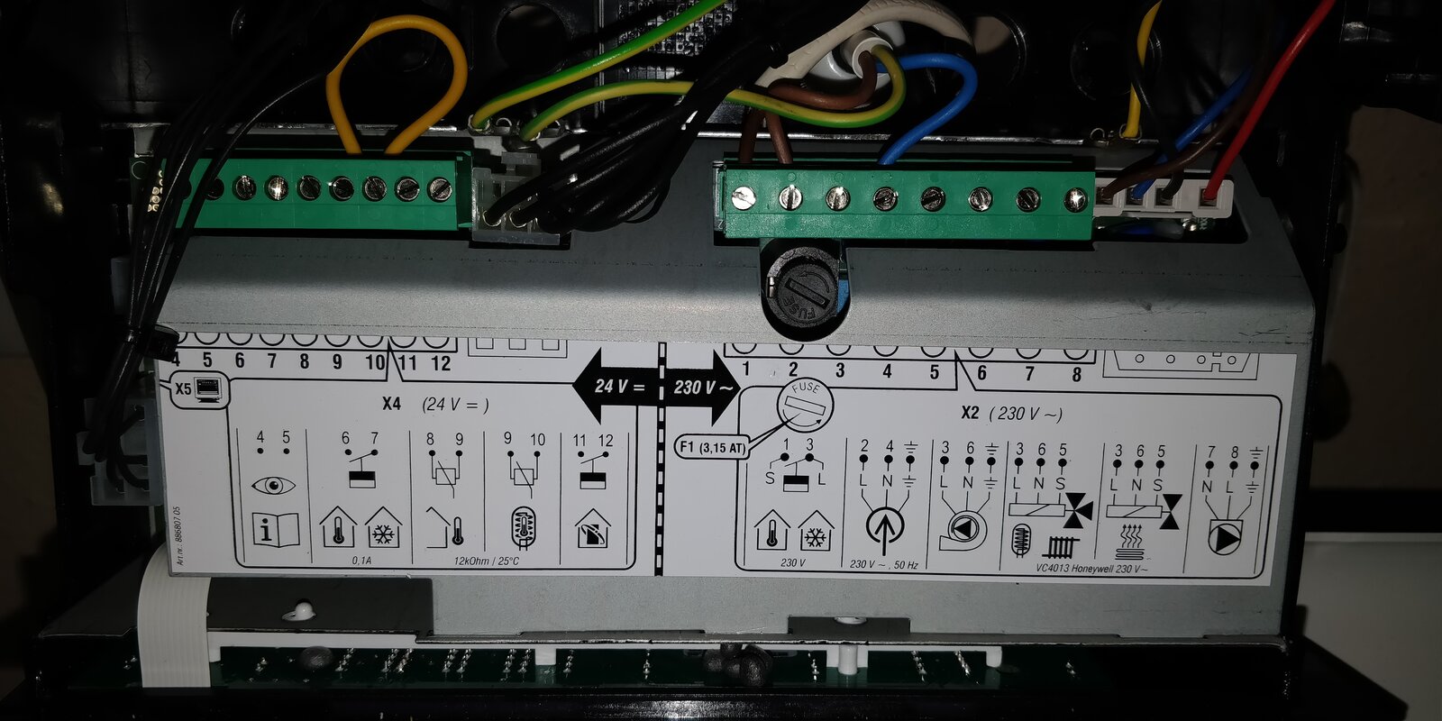

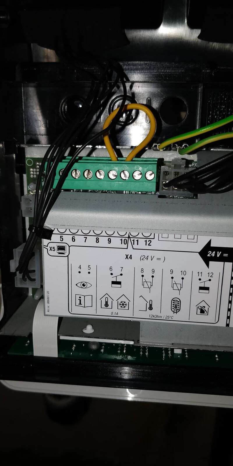

The link between 9 and 10 on the low voltage side remains and the link between 6 and 7 has been removed (as per the tech support at Intergas).

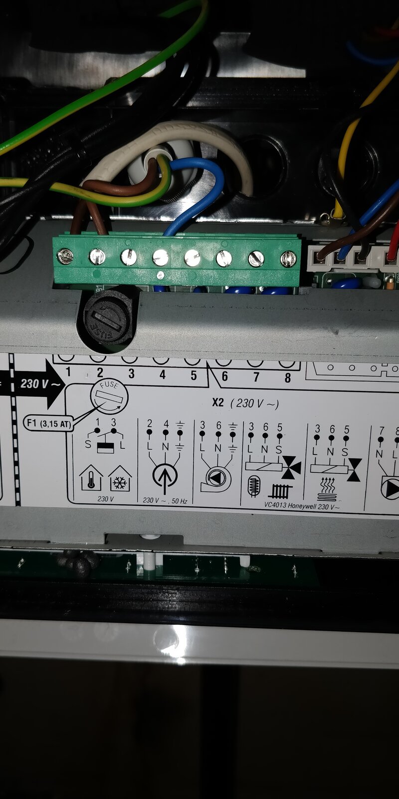

Hi all, thanks for taking time out your Friday night - much appreciated.
The switched live is from terminal 1 on 230v side and the 6 and 7 link is gone.
The mid position valve is new and working properly.
The timer controls the hw and heating independently and it's wired as the manual says.
I checked all the parameters and they all match the factory ones.
I'll attach a picture.
Thanks folks
