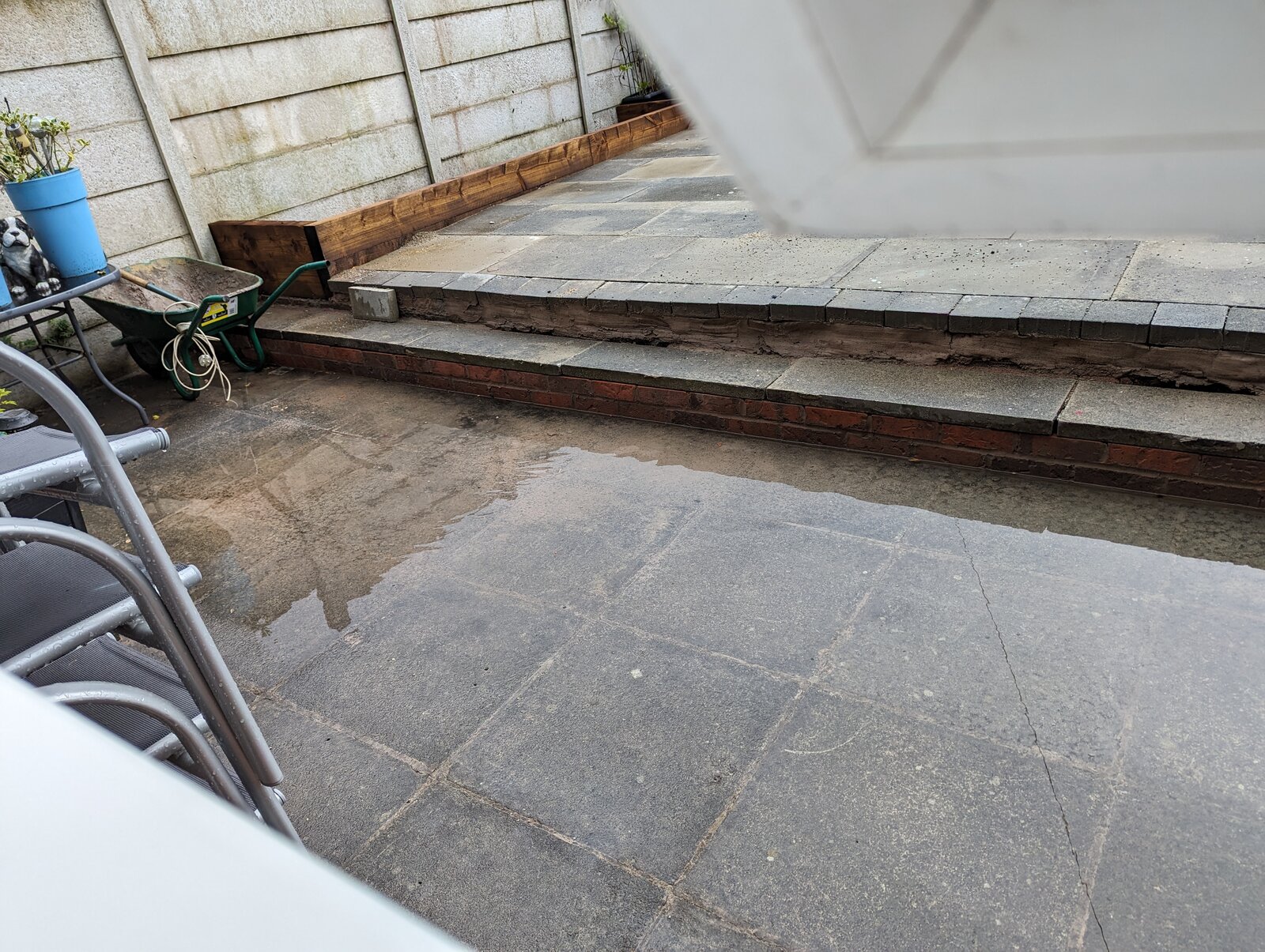

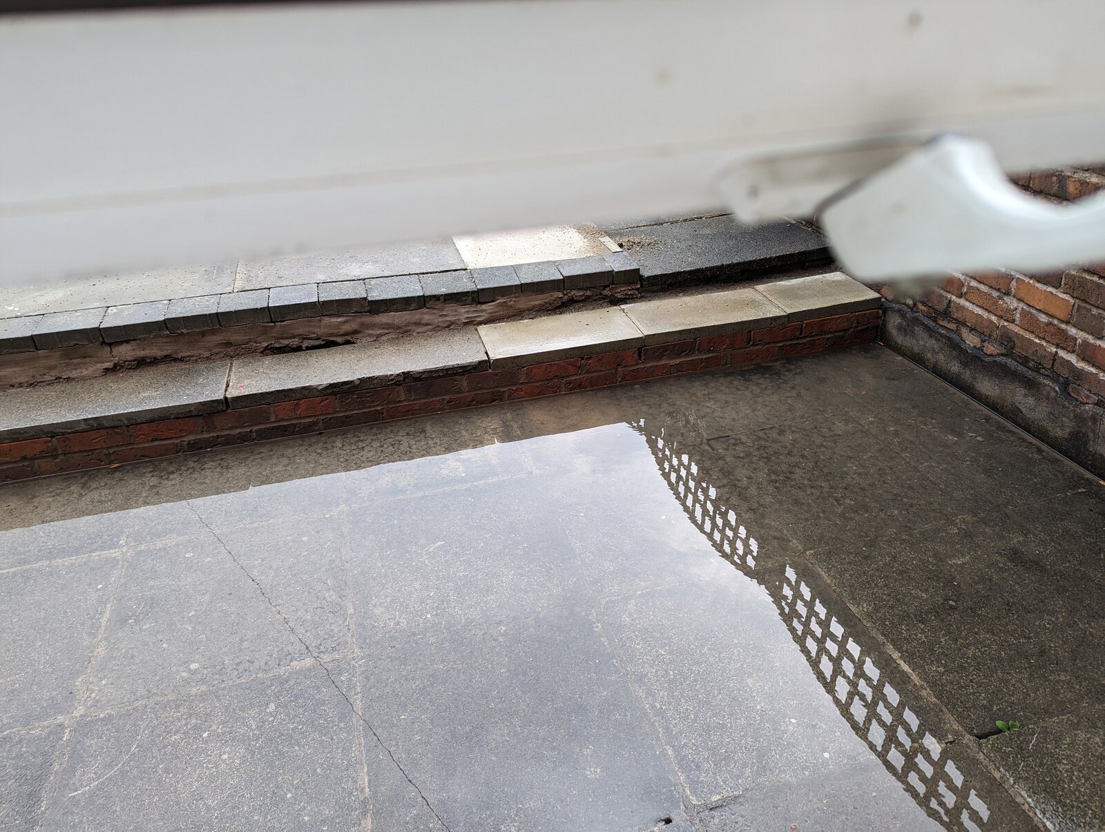

A builder I used has built a step in front of a drainage trench we had and now it floods in front of step every time it rains.
Any help appreciated.
No use saying go back to builder as he has been a nightmare
As requested
That is not the work of a professional builder, not even of a competent DIY'r.
Try asking how to put it right instead !
I totally agree, that's why we have contacted trading standards, just want to know how I can put it right
It's just a trench I did myself and filled with pebbles with soil undeath, it has never been an issue before
Either put a new drainage trench or channel in front of the steps, or get a few Koi and lily pads.
