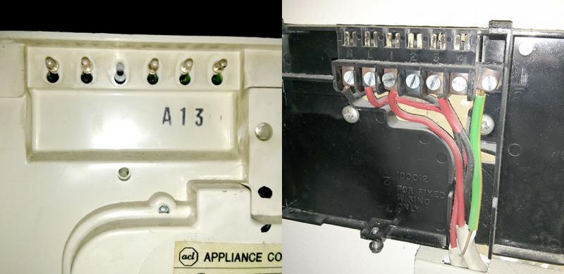

Hello,
Totally new here and although not new to DIY, I am new to plumbing wiring.
I'm not silly enough to try to do anything without knowing what I'm doing, so I just wanted to check with some experts first.
I have just bought a new 7 day programmer (Drayton LP722) to replace my ancient dial programmer. On taking a look, the wiring diagram of the new plate looks just like the old one. Am I safe to wire them like for like?
A photo of them is here:
Thanks in advance,
Stu (Elzibar)
I'd have another look if I were you ;)
although the new programmer will replace the old one,the wiring of the terminals is not the same
No. Look again. The wiring diagrams are not the same. You need to swap 2 wires around

The wiring isn't the same, for example on your old one Heating ON is (1) and on the new one it's (4). Which connections are actually used on your existing system?
On the new programmer 1 is not used
2 now picks up the old terminal 4 connection CH off
3 remain the same HW on
4 picks up the old 1 connection CH on

Is there anything connected to 2 at present? It looks like the old programmer doesn't have HW OFF
Looking at the photo, there are wires to terminals N, L, 1 and 3.
Is that correct?
If so, it's an easy job to change to the new programmer.
Old -- New
N --------- N
L ---------- L
1 ---------- 4
3 ---------- 3
So you only have to swap one wire over - 1 to 4.

That's right, nothing currently going into 2 or 4.
Is everyone agreed then? Just move 1 across to 4?
