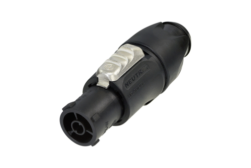

The PowerCon True connector at the other end of the flex will look like this
He has opted for the True variant because it can be removed load.

I assumed that the Powercon True connector would be acceptable. The internal connections don't seem to be accessible unless someone wants to physically insert a thin object. I get BernardGreens point about a lack of shutters but as per my earlier post, my Festool PlugIt connectors do not have shutters nor do other connectors such as the MasterPlug/PermaPlug connectors.
