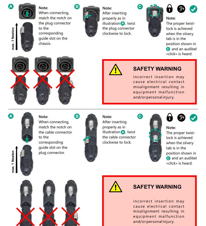

That warning is ample evidence that those connectors are entirely unsuitable for household use.
Good grief - if they are talking about a significant risk (rather than just 'backside covering') I would say that it is ample evidence that they are entirely unsuitable for use in any environment. If they really believe that there is a significant risk of what they describe happening with their product, they surely should re-design (or abandon) it - not put a big red warning on it?
However, you do keep coming up with different reasons for these products being 'unsuitable'. each time someone responds to your previous reason - but I do have to wonder why you have saved this one until last (have you perhaps only just discovered it yourself?)!
Kind Regards, John
powercon true1 top can be connected/disconnected under load
correct that is what they are specified as, but they don't last long if you do and the plastic wears quickly with repeated matingand eventually can be plugged in upside down.
My experience: Powercon are a much better product than Powercon True1
It's a shame because they are a very nice connector on paper, small, IP rated, rated for disconnect under power, no need for blocks to join cables.
Sounds like the real world didn't match up to the testing under lab conditions :(
Testing should always exceed real world conditions.

I suspect the underlying issue is that the people who wrote the relevant standards either never considered the effect of wear/damage to parts used for polarization as a failure mode or they considered them but were unable to distill them down into a standardised test. So the connectors passed the relevant testing (by multiple different test labs in different countries) but then presumably one or more connectors came back from the field with reports of a mis-mating.
At that point the manufacturer has to decide what to do, do they try and change the design to reduce the chances (may not be feasible to do without breaking compatibility)? do they abandon the product line completely? do they do nothing? or do they put out a warning?
Maybe, but the ability of a polarised connection to resist attempts to mate it incorrectly is so fundamental that I would be surprised if tests are not there, The difficulty of predicting what stresses a product might be subjected to does not usually prevent Standards (e.g. BS1363) including all sorts of tests of 'mechanical strength' in the face of potential mis-use/abuse.
As I've said, I would have thought that IF they believe there is a significant risk with anything approaching 'reasonable use' that they would be irresponsible (and maybe not even within the law) to continue selling the product, even with a 'big red warning'. My suspicion remains that the warning represents 'over-caution' and that, in reality, it is probably next-to-impossible to mis-mate the connectors without essentially totally destroying them.
I'm also rather surprised that the problem (if it exists) was allowed to arise, since I would have thought that it would be fairly easy to design a connector which could not be mis-mated without more-or-less totally destroying it.
Read the rest here: https://www.neutrik.com/en/product/nac3fx-w-top
Sorry flamepoint, I get the impression that that they are suggesting that the plugs have a definitive orientation. Isn't that true of standard 3 pin uk plugs? Can you plug a 3 pin plug upside down? I assume that the plugs have indicators to make it clear which way they should be applied.
That said I have never used them and will accept your advice and delve deeper. Thanks
