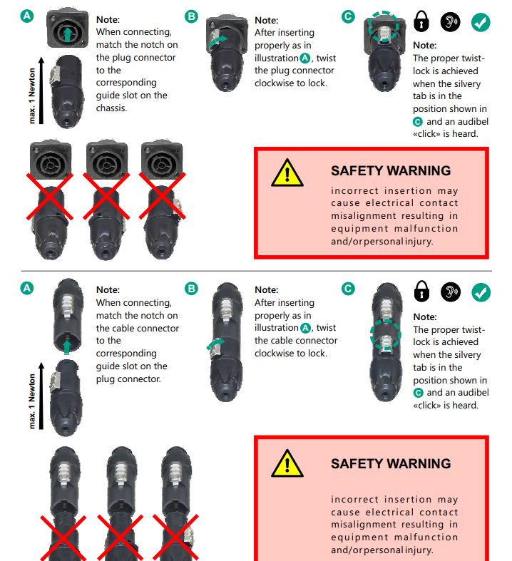

I freely admit to not being familiar with BS7671, are you able to post a link to the specific part that says that PowerCon True1 connectors will not be suitable?

I assumed that the Powercon True connector would be acceptable. The internal connections don't seem to be accessible unless someone wants to physically insert a thin object. I get BernardGreens point about a lack of shutters but as per my earlier post, my Festool PlugIt connectors do not have shutters nor do other connectors such as the MasterPlug/PermaPlug connectors.

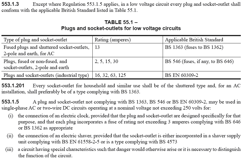

No, because BS7671 contains information on what is suitable, rather than what isn't.
This is what is permitted:
No, because BS7671 contains information on what is suitable, rather than what isn't. ... This is what is permitted:
Yes - but, as I recently wrote, that regulation relates to 'socket outlets' that are part of a fixed domestic electrical installation, and I don't really think that 'leads' are that or, indeed, are within the scope of BS7671 at all.
As I asked you before, what about the countless millions of leads with an unshuttered female connector on one end which are used in virtually every household environment. Do you really regard them as "unsuitable for household use"?
Kind Regards, John
As you are well aware, BS7671 applies to fixed electrical installations. Other standards are applicable to electrical equipment and flexible leads for connecting them.
For the OPs described purpose, at least one of the powerCon connectors would be part of the fixed electrical installation in a household situation.
It is not an appropriate use of that product, as it doesn't comply with any of the standards listed in 55.1, and as powerCon connectors are intended for use by skilled or instructed persons, there is no way that they can be made suitable for use in someone's kitchen.
This really does seem to be an essentially 'bureaucratic' argument. Yes, as bernard has said, there is a theoretical safety issue with any unshuttered socket or female connector, but we accept that in terms of the sort of connectors I have mentioned. You're a very intelligent and sensible guy, so I'm sure you're not suggesting that there is "no way that a 'kettle lead' can be made suitable for use in a kitchen" by people who are not 'skilled or instructed persons' - so what is the difference you perceive? I would say that it does not take a lot of imagination to think of reasons why the kettle lead poss greater potential hazards than does what the OP proposes.
