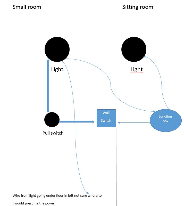

Sorry for the delay in replying
I have had a look at the switch and can tell you the following
Black goes into the com on the switch
Red goes into the 2 way on the switch
Red with Sleeve goes into 1 way switch
I have attached a pic I drew of what it looks like in the loft I hope it makes sense???
Not really. To work outwhat everything is connected we would want to know what wires are connected to what at each of the points.
Did you try my suggestion?, that may bypass the need to do any of this……
