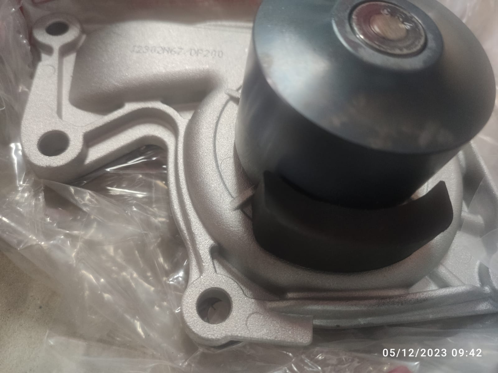

Purpose of the rubber and piece of metal in a water engine pump
13 May 2014
6

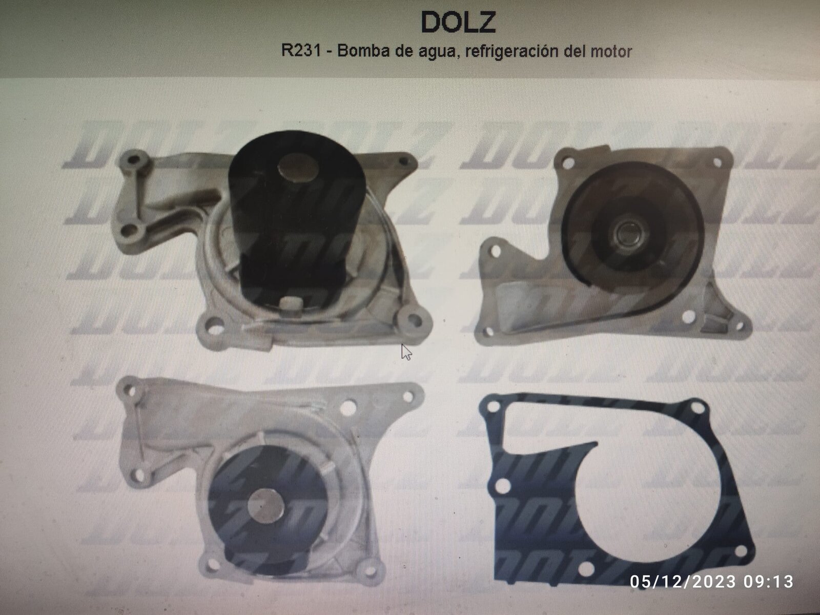

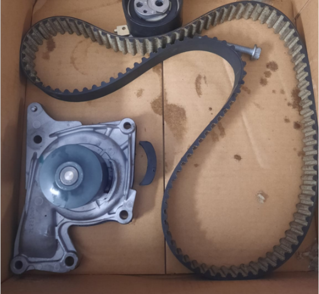

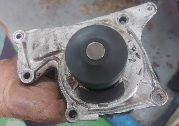

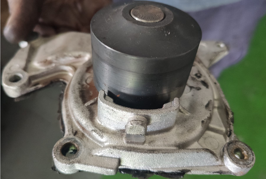

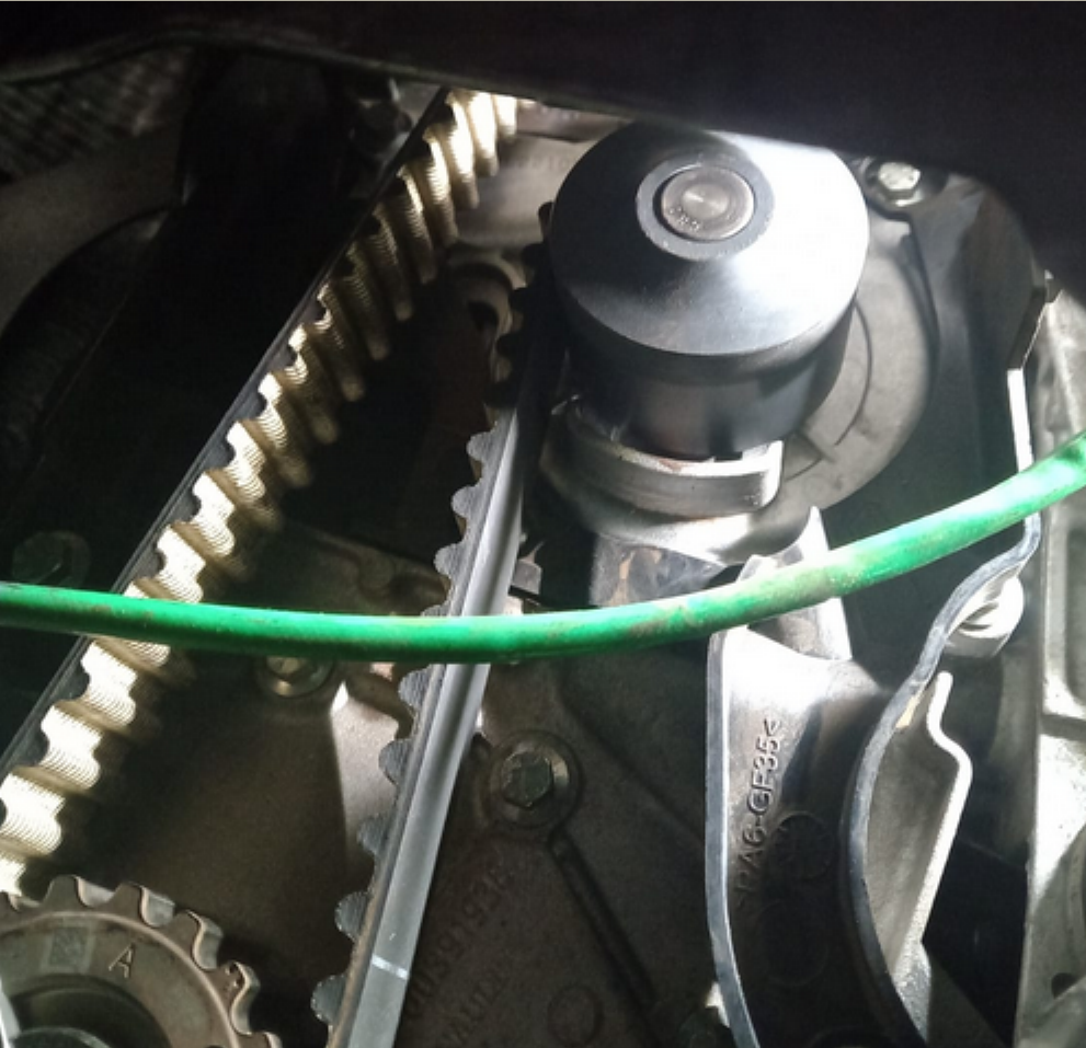

I would like to know the purpose of the rubber in the images fixed in a piece of metal.

Timing belt and idle pulley in rubber to reduce noise.
May be a tensioner as well but hard to see.
I don’t really get this one......all water pumps that I can recall have been toothed.
It’s only tensioners that run on the back of the belt, but what do I know?
John
I'm confused. What are you looking at that I'm not seeing ?
A rubber plug, inserted onto the casting....I can’t really see any genuine use for it, but the Subaru boxer engine has a few of these if I remember. The belt cover used to buzz like hell on these.
John
John

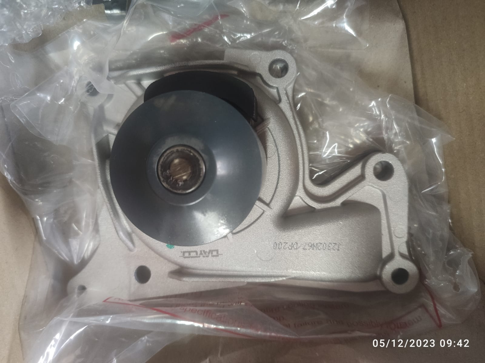

I think there's a move away from toothed water pump pulleys so that if the pump seizes, (either due to mechanical failure or insufficient antifreeze on a cold morning), it doesn't take your valvetrain with it!
Face of belt drives the water pump, in case of water pump failure the belt will not be damaged (in theory) if it was a tooth drive on pump it would.
I cant remember but some cars used the water pump for the tension of the timing belt(been some time now) lol
That's a new one on me.....I haven't had the pleasure so far!
John :)

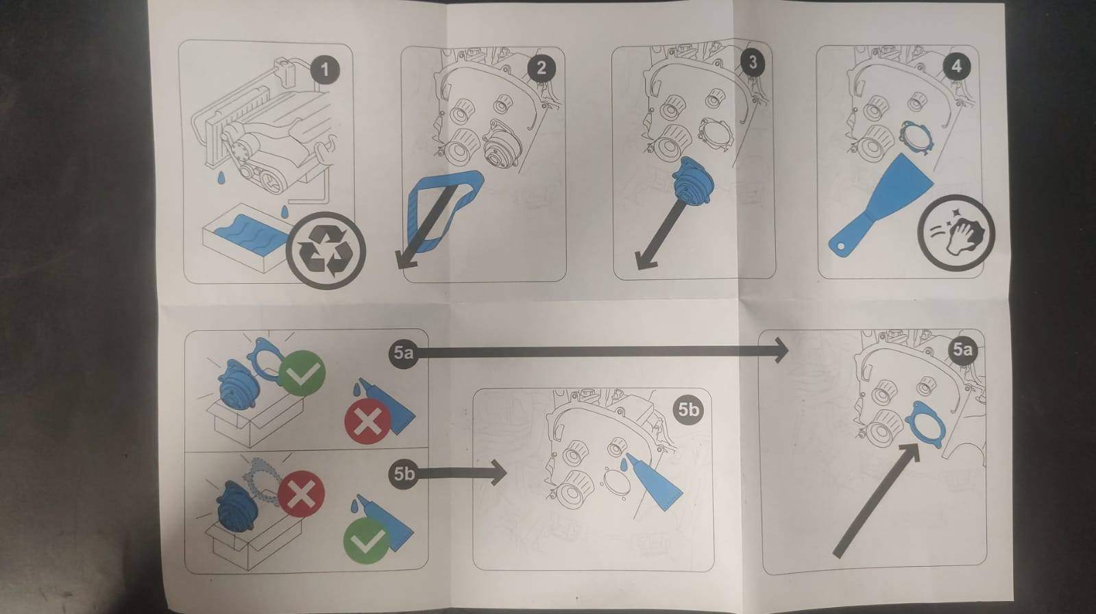

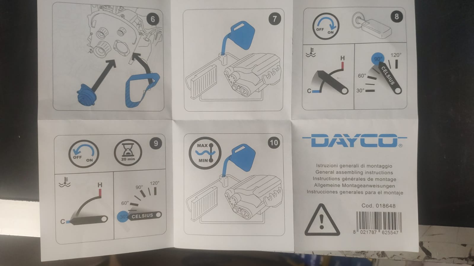

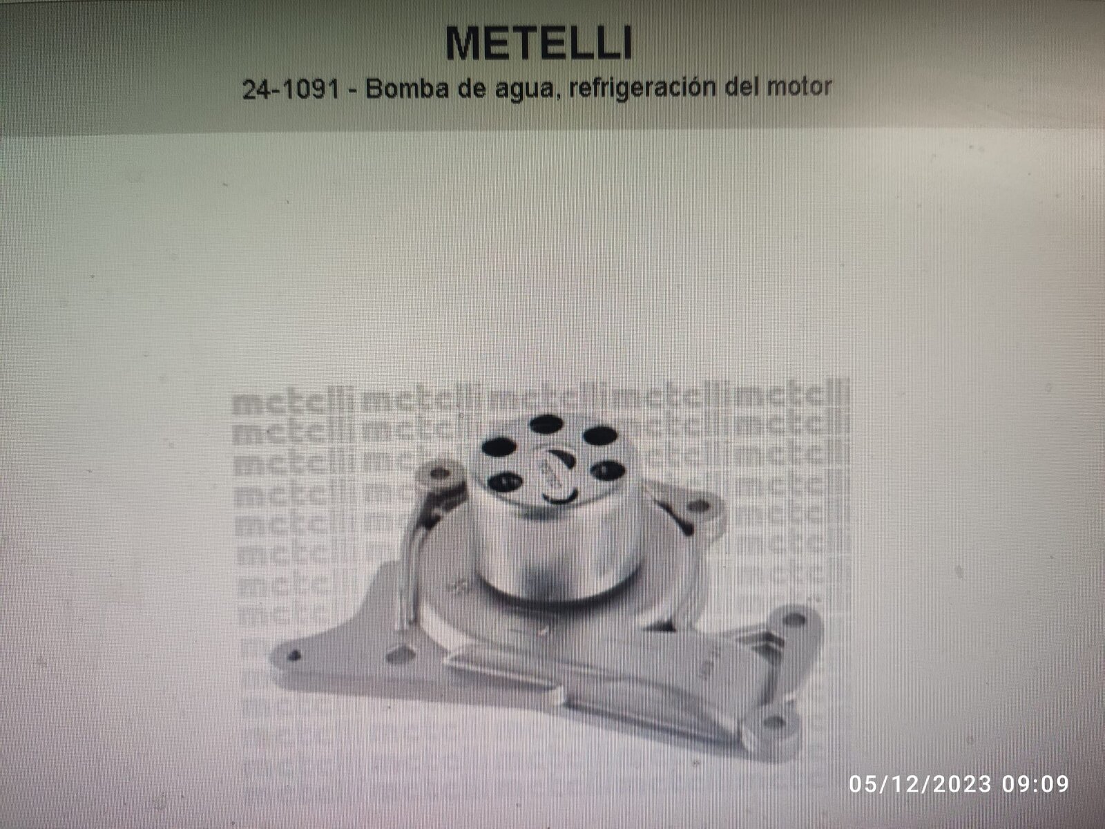

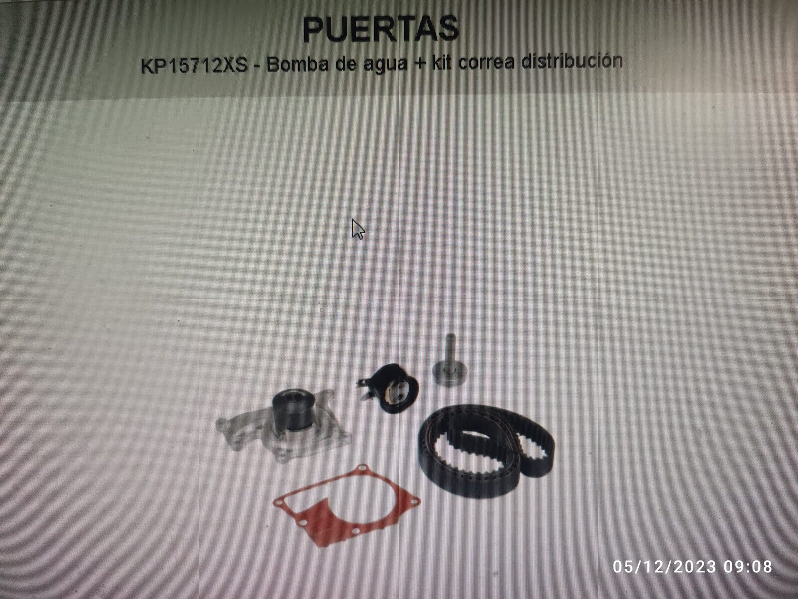

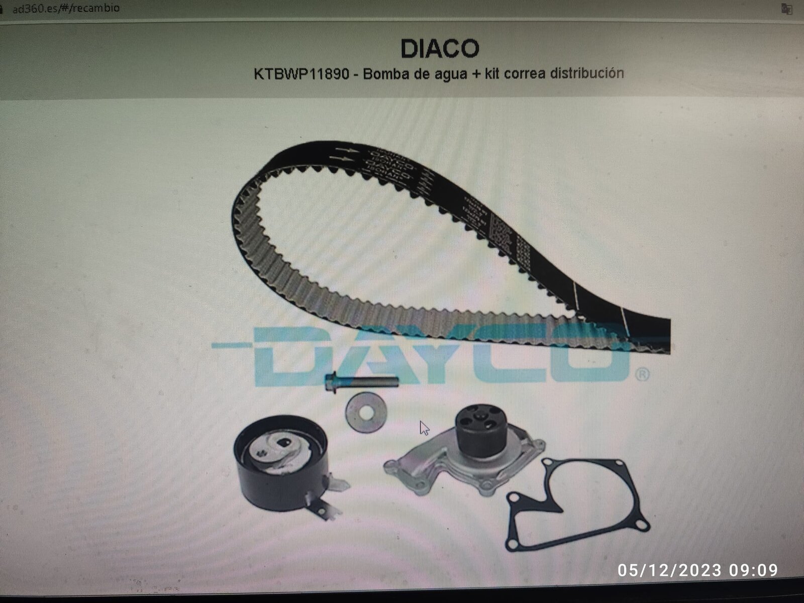

Good news. I have an old kit, because the new don't have the rubber or the special piece :
I will attach more next post

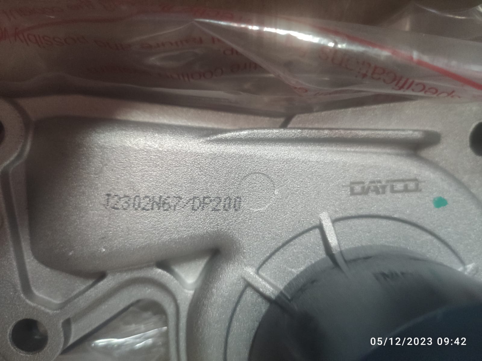

more attached files

At the present times the distribution kit don't have the rubber or the special piece....

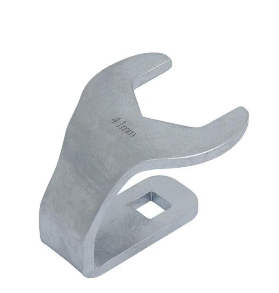

Some Vauxhalls did. I only remember that as I was having a sort out of my tool boxes the other day and found a special spanner that I used to adjust them with. This type:
