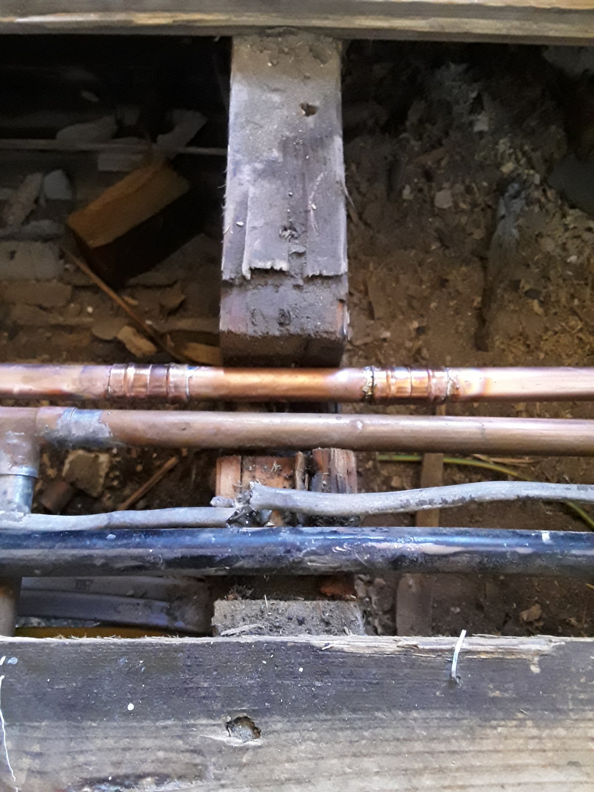

Put a floorboard nail thru a central heating pipe but what is this thin lead pipe I have also nailed

When I did that a couple of years ago whilst replacing some floor boards it was a live gas pipe. Had to call out an emergency gas safe bod to replace it. I did turn the gas off while we waited.
Could be lead sheathed rubber insulated cable. Although it would usually have been weighed in when it was rewired, if it's no longer in use you can get some cash at the scrap yard for it.
As above, redundant gas or electric conduit??
May be a very old material "block tin"? if so scrap value is moderately high.

Thx for the replies gyys. Upon closer inspection the lead pipe has a thin solid core piece of wire inside. Support wire?
