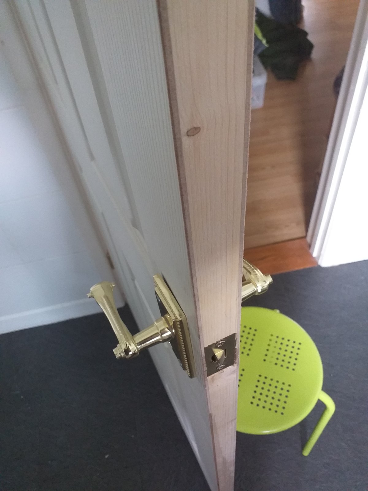

This door handle isn't totally flush with door and it turns a bit stiffly. Is this because I didn't drill in perfectly at 90 degrees. So the the hole one side doesn't match the opposite one perfectly? If this is the cause, how do you drill at the perfect angle?

take the handle on the shaft move it up down left and right note the difference and half it and fix it to that position as tigerclubrider said above the spindle hole needs clearance
Probably hole thru door is not quite large enough and rim inside handle is fouling on door .Enlarge spindle hole a few mm.

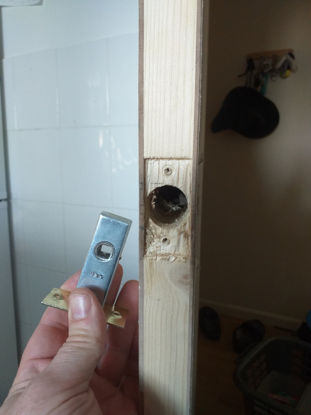

Looks like it happened because the mortise isn't square to the face of the door edge, and the hole is just too tight. When drilling the edge of a door in future use a slightly larger drill bit than the body of the lock/latch, but make sure it's smaller than the face plate
In this case I'd probably ease the right hand side of the hole with a gouge or a small chisel so as to allow the latch mechanism to sit straight in the door

I gouged out the hole in the top right hand side and now it fits thxs
Don't think i could've drilled it any bigger

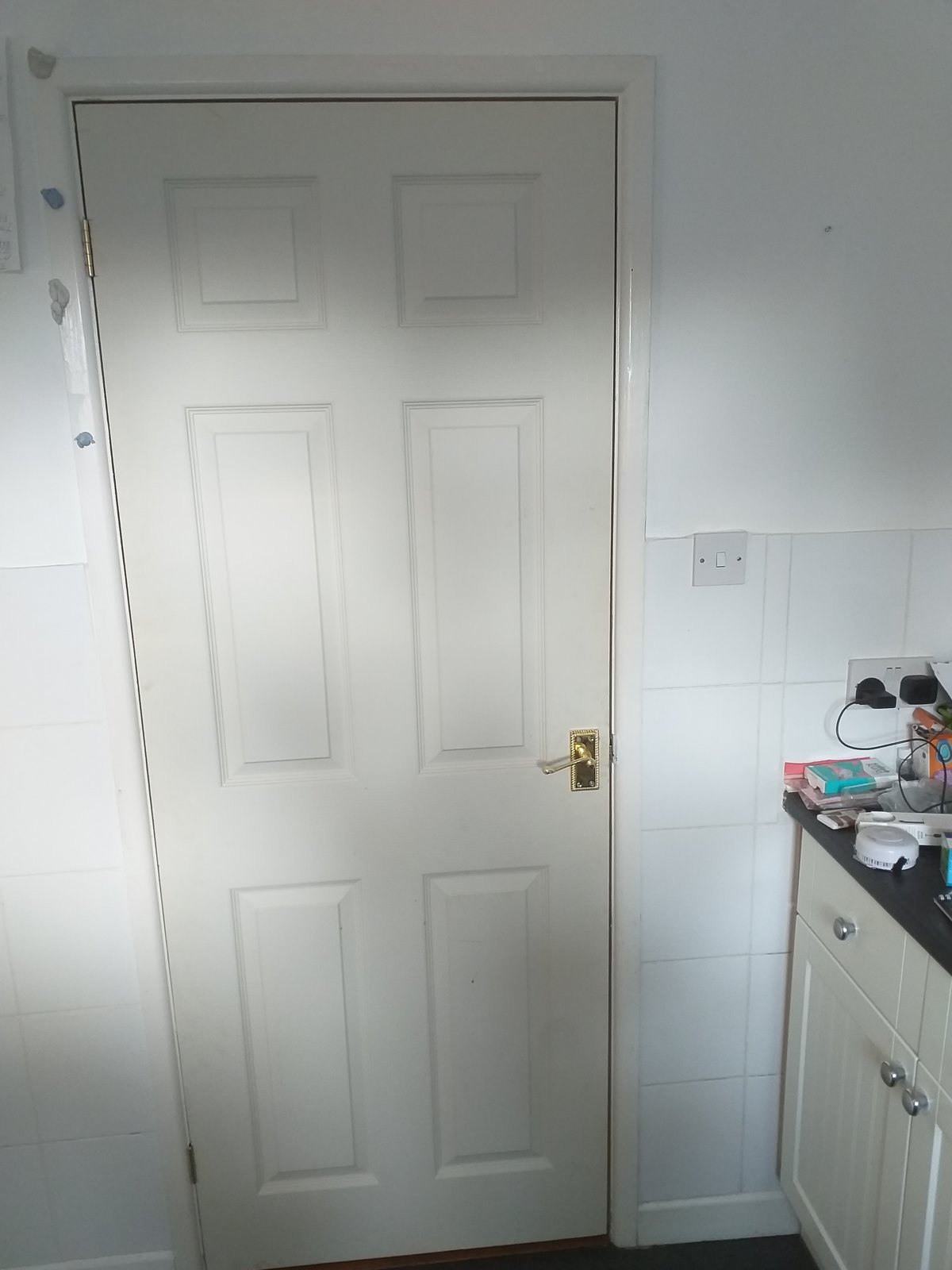

The gap running down the right hand side seems too big. Is it just a case of planing then hanging then planing until it fits perfectly? And putting all screws in hinges when offering it up?
Can you delete the last picture? The tiling to the right of the door is bothering me.
Why the infill of tiles and why not take them higher so the socket sits flush to them.
Aaaahhhhh. I can’t un-see them
