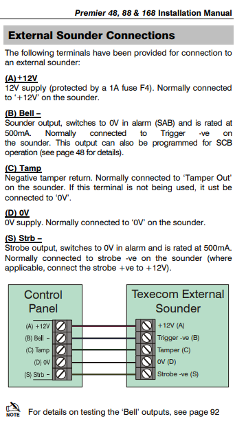

Pyronix delta to Texecom
The manual can be found online
never thought of that mate! Found it, explains it all and no further assistance required :) My box was missing that, I will be having a word with the supplier I used! I wondered about it when it arrived as the seal was broken on the box but was told it was to add in the communicator into the package. I am guessing they have had this out for something else and not put the book back in! Thanks for your assistance

Well the connections for the bell box were correct, suspected they would be and system in and working. Thanks for the assistance. Next door had the texecom installed by a local company and used the texecom box, dislike the black edge around it. Having said that my Pyronix Delta was up before their system was installed. Checked inside it today and still looking good.
