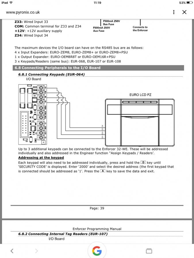

    Hi there, hate to be new and jump in with questions but am banging my head against the wall with ringing ears.
    I have physically installed the main panel and a euro46 wired keypad. This is connected to the io board with no resistors as that seemed how the install manual has it. There are no other wired devices.
    I had powered up the main board once before, now when I turn it on I am told comms lost (there is no coins board at this time). The unit then says please wait and boots to normal.
    If left it alarms and I see no way to disarm. There is no text on screen just the internal sounder. If I hold d and input either master or engineer codes (1 or 2) as given in the manual the screen goes blank and does nothing. Once it went blank with a 1 down the bottom right.
    I was expecting to set the date and start learning inputs but that seems not the case.
    The keypad seems to work fine and mimics the main panel.
    The manual and YouTube videos seem so simple so I know I am missing something simple.
    I will unwire the keypad and see what happens but I do need that as part of the system as the main panel is deliberately hard to access.
    Thanks in advanced for any assistance.

    Start again
    Default panel and setup without remote keypad
    When you think panel is set up correctly add additional keypad
    You need to install o/p card on PCB
    Wire keypad as diagram and the you need to address keypad as keypad 1 IMG_0310.JPG

    Many thanks, what page is the default procedure as I am not sure I have seen it or it did not sink in if I did.
    I did wire d1 to 4 and then connect the flat cable from the io board to the main face. I think that side is OK but suspect turning it on before this and setting nothing might have scuppered things. A fresh start without this sounds wise.
    To clarify my issues seems to be unable to get to and menu, engineer or master.
    Hold d enter either codes and nothing.
    Now sounder went off and allowed me to enter a code, and given me an elusive menu.
    Battery fault (it's removed so I can power off)
    case tamper fault, not sure here as case is on, will tweak screw inside.
    I think I am in! Ears still ringing tho. Had to put up the first data bell housing to clear my head.

    After playing with the tamper screw I heard it click when I put the case on so now engaged. I assume the lack of functionality was due to the panel being in an anti tamper mode.
