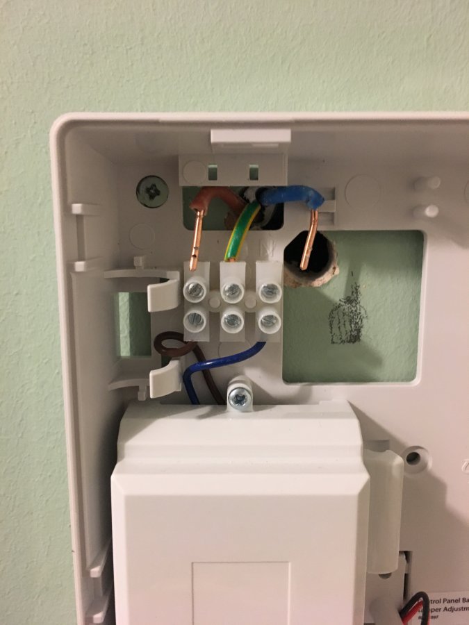

Hi sparky marka should the mains panel run from my main switch board via a fuse spur? I'm replacing my existing alarm that was hard wired to the switch board with this unit but once I flick power on at the switch board in knocks the RCD circuits off. So I thinking it might need a fuse spur? If anyone can help? Thanks
Fuse spur only isolates the supply , if it's tripping the rcd you have an issue with the wiring , post picture of mains connection
Thanks for confirming that. Please see the image I know it's not connected right now because I've disconnected it. What I don't understand is that there is no earth wire in the panel tramsformer?

It's not required , it could be a faulty power supply ? Only way to prove if it's the panel is wire via a flex and plug top , in a socket ....does this trip the rcd ?

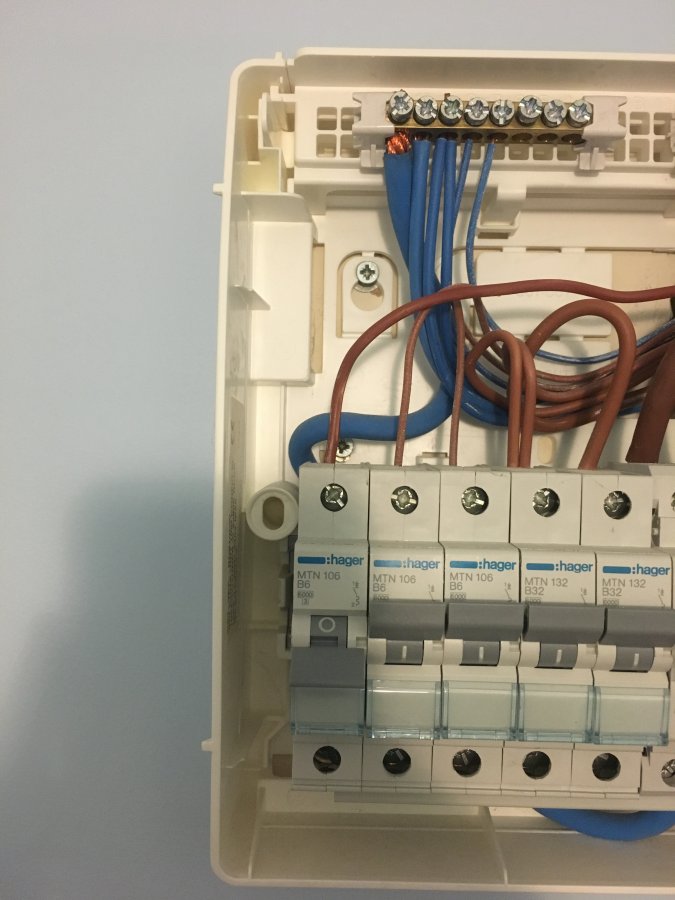

Last switch on the left is the one I'm using for the alarm. If I flick the switch on now (while the wires are not connected to panel) the RCDs stay on. Once I connect them back to the panel and switch it on then RCDs go off.

Sorry for being abit dumb, by running a flex, do you mean wiring it to a 3pin plug and plugging it into a wall socket?
Can you post a picture of all of the fuse board , where does the neutral go to ? It may be on the wrong side if it's a split load board !
Hi, you were right. I have hooked the neutral up to the wrong half of the board. Split board was new to me. Managed to get all detectors connect just got to play about with the zones and exits! Thanks so much for you help. Wish I'd have joined this forum years ago! First I'd heard of it after finding it on google! Thanks again!
