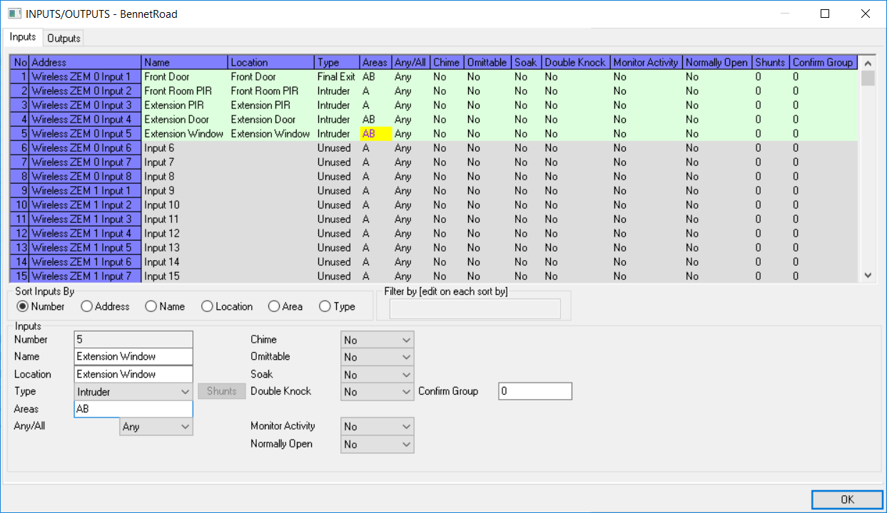

Hi - I'm in the process of setting mine up today and I wanted to achieve something similar.
Here's what I believe you need to do - others on the forum please correct me or enrich this if required as I'm a newbie! :)
Set all sensors to zones A and B except for the PIRs, leave those only on zone A.
Front Door Contact = A, B
Back Door Contact = A, B
Back Window Contact = A, B
Front Window Contact = A, B
Front RM PIR = A
Extension PIR = A
Upstairs PIR = A
As a result:
- When you set zone A, every device arms.
- When you set zone B, every device except for the PIRs arm.
we should wait for someone more experienced to confirm if this is correct. If it is incorrect then it will help me out too...

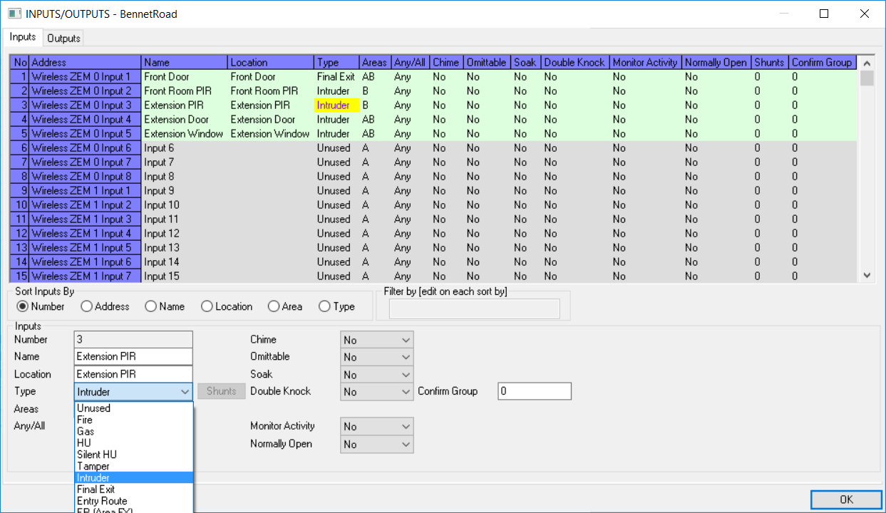

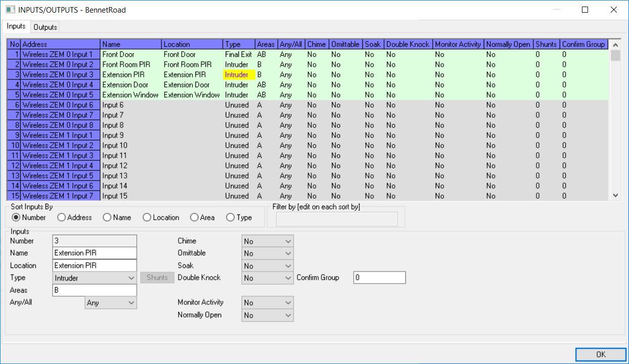

Have 1 or 2 more questions i want to clarify....
on the Inputs and output screen as per below, does anyone one know what each funtion does, (nothing in the manual or anything i could find)
Any\All -
Chime -
Omittable -
Soak -
Double Knock -
Monitor Activity -
Normal Open -
Shunts -
Confirm Group -

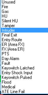

Also 1 last bit...
The sensors Type, assume i have got them right as above? the front door is final exit and rest act as intruder?
these are the options:
much appreciated
Are you setting via radio fob or using keypad ?
Do you walk through any sensors to get to the keypad while setting and in setting ?
Chime creates an audible tone when a device is triggered. Should only be used with door contacts
Omit mean a device can be isolated during a setting period
Soak puts device into a test/monitor mode
Double knock means device needs to be triggered twice in specific time window
The other meanings you would not need unless if a specific purpose
