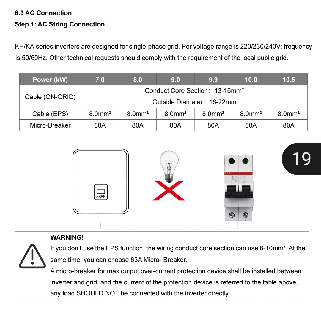

The manual is here: https://midsummerwholesale.co.uk/pdfs/en-k-manual-v1.4.pdf
appears that the 13mm size refers to the outer diameter of the round cable that can be used with the AC connection plug but has been jumbled up with other information. Page 17 onwards.

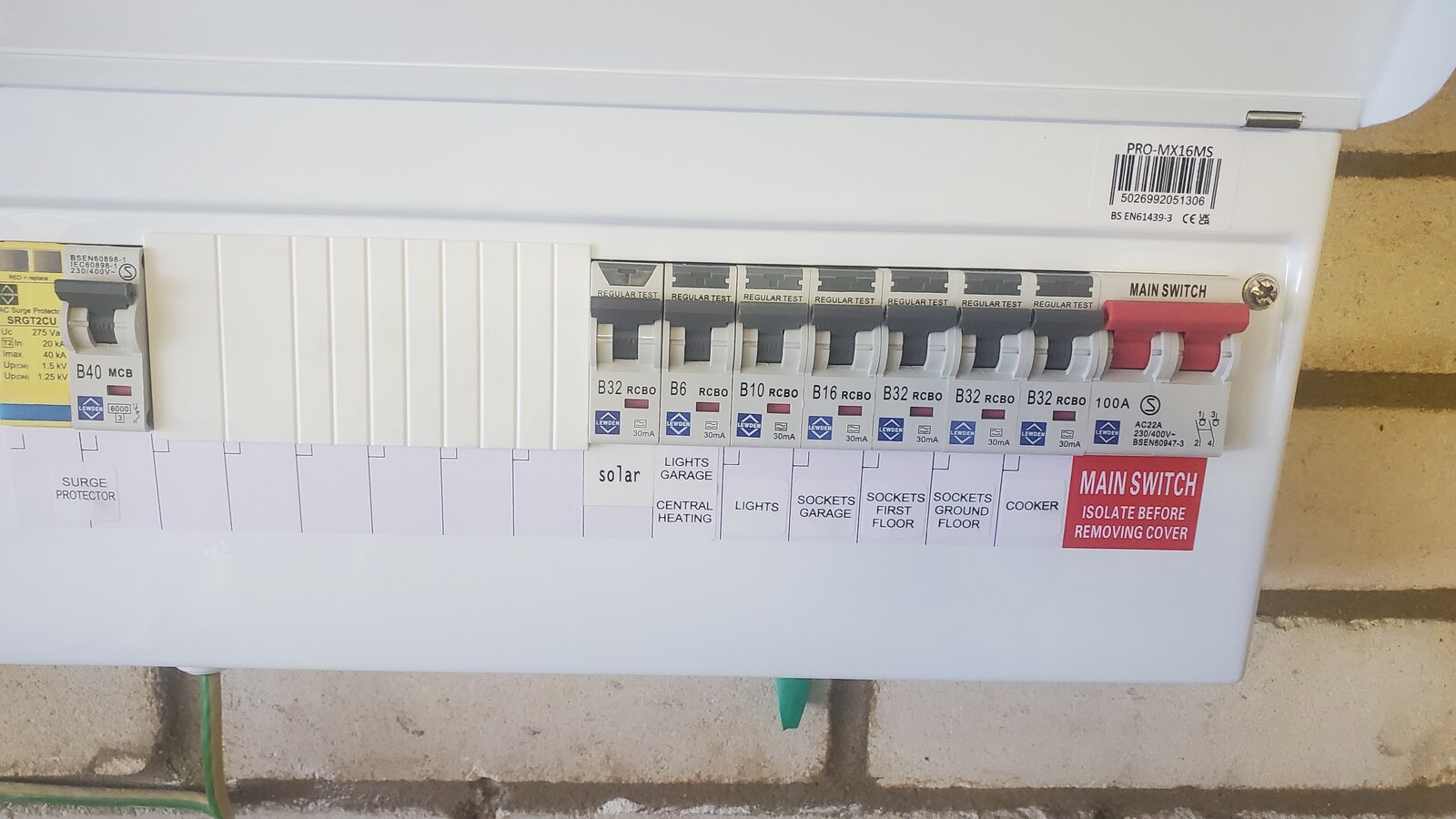

A 100A breaker will be of no use - plenty of homes have an incoming supply smaller than that.
If that flat cable has been shoehorned into the inverter connection plug, it's the wrong type.
May not be secured properly.
Round cable is required.
Could you post a photo of your CU?

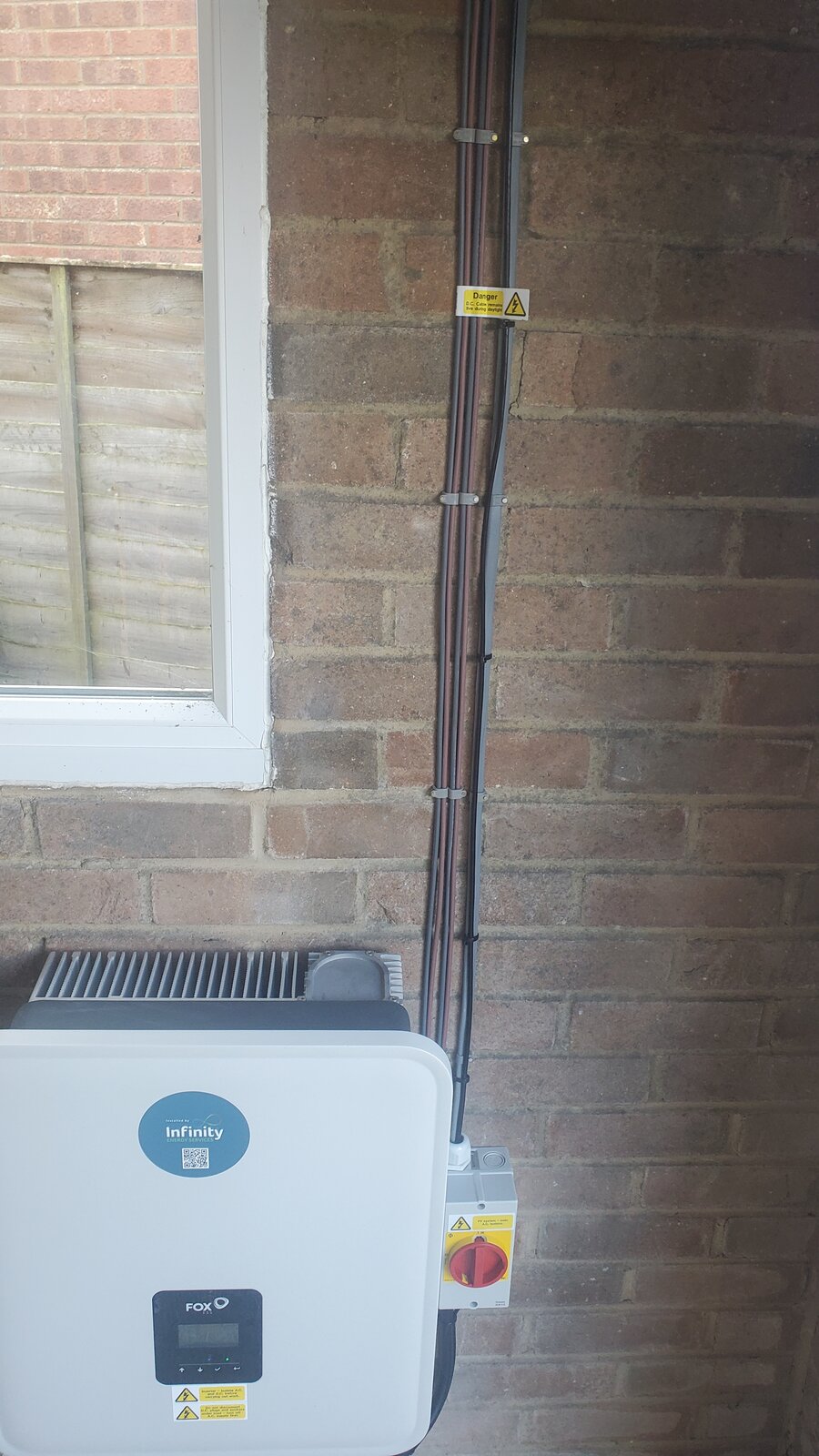

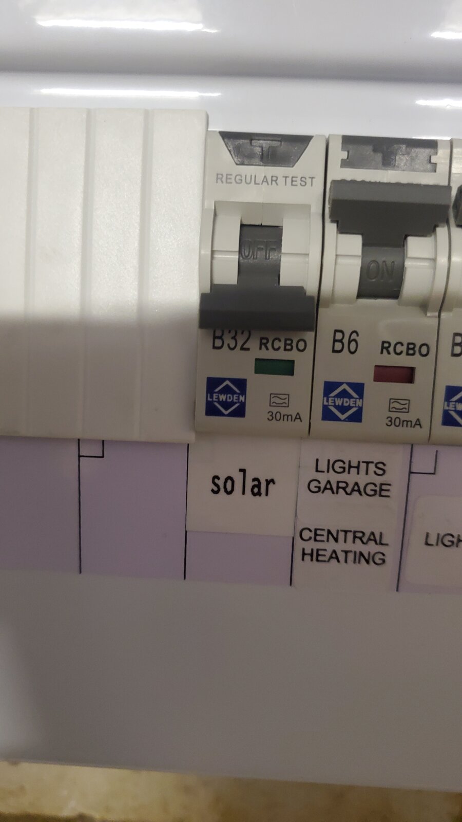

Don't quote me on what I think cables do or go exactly where, unsure of that but here's a photo of the cables. Both dc coming from pv and to cu. This what you would expect?7kW @ 240V is 29.2 Amps so 32A RCBO and 4mm² cable.

Sounds more like plumbing than wiringThanks, so this uk version says the breaker should be 80a for our install with battery. Still a lot bigger than the 32a that was used. ....![]()
, its grey cable, its width longer than its height. How can I identify what gauge cable they've actually used?
Electrics:flatpvccables

You don't want minimal cable sizings with PV.7kW @ 240V is 29.2 Amps so 32A RCBO and 4mm² cable.

Probably best not to name our installer. Give them time to rectify. They are reputable.Who installed all this ?
