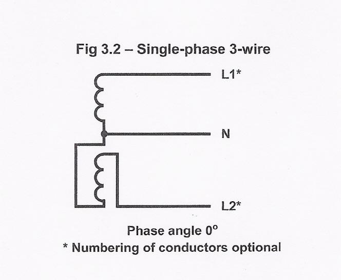

However, I've just realised that most/all of us have been making some doubtful assumptions. It may well be, as some are arguing, that what the BGB now says is inconsistent with 'well-established terminology'. However, I see no evidence, at least not from BS7671, that the IET (or JPEL/64) have changed anything, or changed their views about anything. BS7671:2008 was essentially silent on this issue. 312.1.1 merely referred to 312.2.1,which said:
The number and type of live conducors (e.g. single-phase two-wire a.c., three-phase four-wire a.c.)
In other words, they just gave two examples of supply types, and said nothing about the others. However, in the 2011 amendment, 312.1.1 is much expanded, consisting of diagrams of eight different supply arrangements, namely:
  • Single-phase 2-wire
    Single-phase 3-wire **
    Two-phase 3-wire (180)
    Two-phase 3-wire (90)
    Two-phase 3-wire (120)
    Three-phase 3-wire (star)
    Three-phase 3-wire (delta)
    Three-phase 4-wire
Hence, the IET may well have had exactly the same view of this terminology in 2008 (and perhaps much earlier) as is now explicitly expressed in the 2011 Amendment of BS7671, but were eseentiallybeing silent about their views on all but the two examples of the terminolgy which they quoted - i.e. we actually have no idea what they would have called "2-phase 3-wire" had they explicitly mentioned it in BS7671:2008.
And what if you supplied the premises with just the two phases and no neutral? Would it still be a 2-phase supply?
Of course not - and, thankfully, the one thing that no-one, and no cited document, has ever suggested in this discussion is that there could possibly be such a thing as a "2-phase 2-wire supply"!
** The "Single-phase 3-wire supply is one which might interest you, and which you might wish to comment upon:

Seeing that prompts me into thinking that perhaps the only reason they've decided to call it "2 phase" is because (like the 90 and 120 examples) it shows two live connections. Two live wires doesn't mean two phase, but I do wonder if it's that simple, as wrong as it may be.
As for the 120 deg example, it's rather an odd arrangement, since I doubt there are many applications in which it would be feeding only what are clearly single phase loads, either 240V L-N or 415V L-L. You could actually get a rather lopsided 3-phase from it - Compare the phase of the currents L1-N, L2-N and L1-L2 through a resistive load connected in each combination. Not that it would be of much practical value.
P.S. Then again, I just noticed that those supply diagrams don't indicate any earthed supply conductor anyway, so if really floating all three lines would have to be considered live anyway. But I suspect they're probably assuming that the common point would be earthed in each case, since that would be the normal arrangement in this country.
Interesting thought, but I don't think so - since, if you look at Fig 3.2 (posted above), it shows "Single-phase, 3-wire (0 °)", which also has two Ls and one N.
Well, it could p;resumably just be that, for whatever reason, just 2 phases of a 3-phase, 4-wire supply were fed to a particular premises(the diagram does show that third, unexplained, dotted line!), the phases to be used separately for (L-N) single-phase loads. My house has a 3-phase, 4-wire supply, with each phase (+N) broadly supply one of three floors. Should someone at some point decide to split off one of those floors as a 'separate dwelling', then the dwelling comprising the remaining two floors would have such a supply.

Mind you, as I posted recently, the text of the Amendment does include (in Fig 3.2 of 312.1.1) something called "Single-phase, 3-wire (0°)", but that is different from the "2-phase, 3-wire (180°)" achieved with a centre-tapped single winding (Fig 3.3) - and it isn't a box offered on the EICR (or PIR) form.
That seems an odd arrangement to list specifically, as it really amounts to nothing more than two single-phase 2-wire supplies which are sharing one conductor. That conductor will carry the sum of the currents in the other two lines.
I don't know about you, but regardless of the "2 phase 3 wire" issue seeing that diagram seems to suggest that they're really setting up the potential for confusion by now using the term "1-phase 3-wire" to mean something completely different from what has been understood by that term for the last century. In my experience (as a computer & telecom tech) I've already run into younger electricians now who seem to have little real understanding of electrical principles but can quote the wiring regs verbatim as though that's the only thing they've learnt. So I can just imagine some new electrician coming along who has learnt this peculiar definition of 1-phase 3-wire and is going to be completely confused when what he's actually looking at is what the regs are now calling "2 phase 3 wire." So I can't help feeling that regardless of whether the new use of "2 phase 3 wire" is right or not, it's certainly not a good idea to decide that "1 phase 3 wire" is now supposed to mean something completely different from what it's meant since about the 1880s.
I agree.
