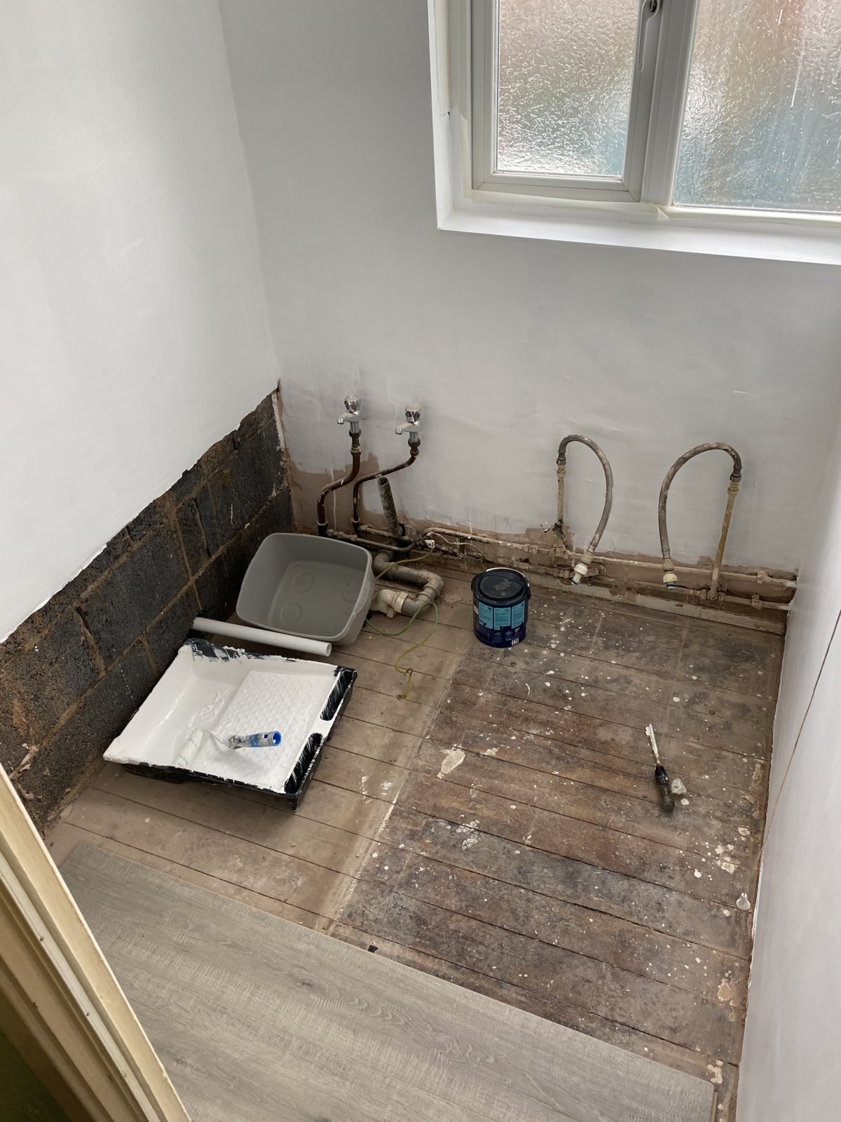

Hello people im re doing my entire bathroom and i have a plumber coming next week to fit new bath and floor standing vanity unit and sink.the room is stripped,im in a position to quickstep laminate floor in this room.i dont know weather to floor the entire room now or wait till the plumber has been and fitted the bath and vanity cupboard and sink and then floor the room.
What would you do?

I'd lay the floor down but not under the bath. If you ever want to change the floor you don't want to have to take the bath out. The sink and cupboard however are easily removed to facilitate a new floor
Don’t lay anything , you don’t know if the plumber will need to relay waste etc across the room or check current for leaks etc .
Quick step is not waterproof so personally I would tile .
