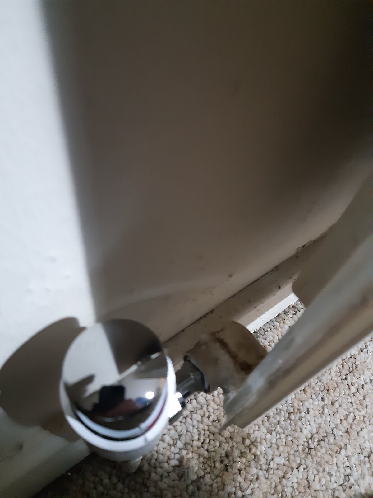

I spent the afternoon fitting Drayton TRV4 rad valves to 3 bedroom radiators today.
Bedroom 1, closest to the boiler and bedroom 3 furthest from the boiler are operating as expected. The rad in bedroom 2, between the two is not getting hot.
The tail coming out of the trv into the rad is very hot but just an inch to the right the bottom corner of the rad is cold.
The tail doesn't go in in a straight line. For want of a better term there is a threaded 90 degree knuckle on the back of the rad .
I was wondering if I've screwed the tail so far in its jammed against the back of the 90 or could it be something else?

Something else !
Close every working rads TRV ,see if cold rad now heats up.
Thanks Terry. I've done that and it is now warming up albeit very slowly. It's now at 35c after about 20 minutes.
What's the explanation?
There is a restriction on that rad,either one of the valves isn't open fully or the pipework is restricted. It should have heated fully ,and quickly ,once every other radiator was closed off. The pumps flow would have been concentrated through the problem rad and moved any air trapped in that rads pipes.
Did you alter the problem rads lockshield valve when changing TRV ? If not, remove the TRV's actuator head and check the pin in the centre of the body, it should move freely up and down a few millimetres. Leave the actuator head off and see if the rad performs any better.
I replaced the lockshield valves on each of the 3 rads at the same time and have them fully open. The problem rad is now warm but it seems to have maxed out at 45c compared to 58c for the downstairs rads

Might be worth removing the TRV tail and measuring it, in case it is, as you suggested above, too long.
