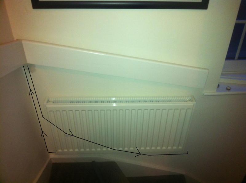

I'm installing a 400h x 800w radiator in my hallway that is always freezing cold mainly because there isnt a rad at the top or bottom of the stairs.
Because of where I'm connecting into (22mm pipework above) 15mm flexible plastic pipework will be used. On the image attached I plan on dropping the two pipes down the corner. The left hand pipe should connect in fairly straight forward with the help of a 15mm 90deg elbow on the bottom of the lockshield/TRV.
1) My main question is will I be able to obtain the sweep to reach the furthest valve or will I need a 90deg elbow at the bottom of the drop and then run the pipe along the bottom of the rad to the other valve? The brackets are pretty small.
2) On this instance would it make sense to have the TRV on the left or right of the rad in that picture or does it not make any difference? I'm using John Guest pipework & fittings.

You could just lash it across I suppose, an elbow at the bottom and a few clips would look much better though. Make sure it can't rub on the bracket if you go for your intended option as the sharp edge will wear through the pipe.
The TRV should go on the right
Those stem elbows can go straight into your radiator valves
Difficult to know how to make the pipework look less ugly.
Poss, left hand pipe down to level of bottom left rad tapping, Speedfit elbow , then straight into a straight rad valve. Right hand pipe sweeping behind rad as your picture, then end of pipe into a stem elbow - stem of the elbow into an angled rad valve.
Mixing straight and angled valves is unconventional, but tidies things up a bit. With plastic pipe and push fit, it's never going to be pretty.

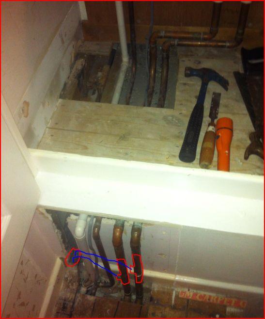

Could anyone tell me what width of the 22mm pipe I would need to cut out to enable the 22X22X15 TEE to fit in? I have marked where the 2 15mm pipes have to drop to and again Im not sure if I can just angle the tee and bend the pipes down the hole or should I use a 90deg elbow then drop vertically down? There is a little bit of play in the 22mm pipes.
You can buy lockshields valves with built in drain taps. Don't forget to top up with inhibitor you can do this via the vent plug on the radiator.

Sweeping behind the rad will be problematic due to the brackets (red lines, aproximately).
The yellow lines indicate possible routes for the pipework.
View media item 59840
Have you thought about TBSE connections? (Top, Bottom, Same End.) In top, out bottom.
How feasible would it be to route the pipework behind the lower part of the banister?
Thanks for taking time to do a sketch. I was actually going to ask about TSBE - does this work OK and would the TRV be at the top or the bottom? I'm not sure it would look that great though? Regarding your question about the banister there is no depth to it its flush underneath so the pipes would show. I think what you have shown - pipes down the corner then tucked underneath is the way to do it.

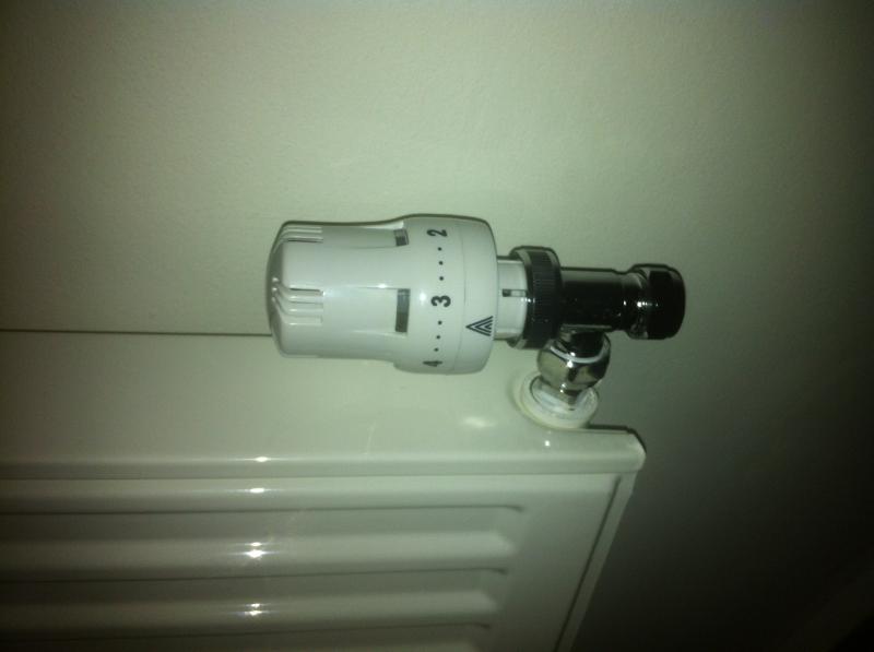

I have been busy tonight and fitted the TRV while I wait for my plastic pipe & fittings to arrive. I'm going to put a 15mm elbow on the bottom of the TRV and I was just wondering is it OK to connect 15mm plastic to this 15mm chrome elbow providing I use a pipe insert and olive?
Thanks again.
Yes, compression is fine on plastic pipe.
Thanks.
Does it matter where the olive is placed from the end of the plastic pipe or will it just all tighten together anyway?
Place the olive on the end of the pipe, slide pipe and olive into compression fitting. Make sure the pipe is pushed all the way into fitting against it's stop until you have tightened the nut.
As long as the pipe is kept pushed into the fitting against it's stop during nut tightening, the olive will be tightened correctly onto end of pipe.
