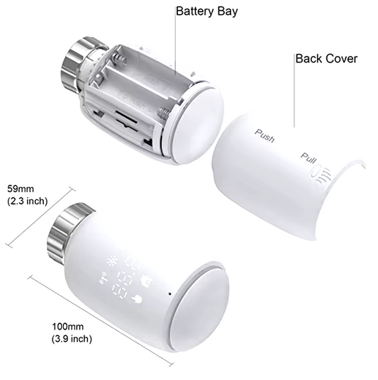

Non linked heads are that that expensive a google found this one
at £15 each, linked more like £60 each, but they don't all have to be linked. I have eQ-3, Kasa, and Energenie, I will replace with Wiser TRV's which are linked, but at the moment Nest Gen 3 in the hall as wall thermostat and Wiser in Living Room as wall thermostat, and it seems to be working well. In 2019 when I got eQ-3 bluetooth they were £15 each, but brexit has bumped up the price, there is the Terrier i30 if you want to buy local. The Kasa seems to work well, not so keen on the energenie ones.
