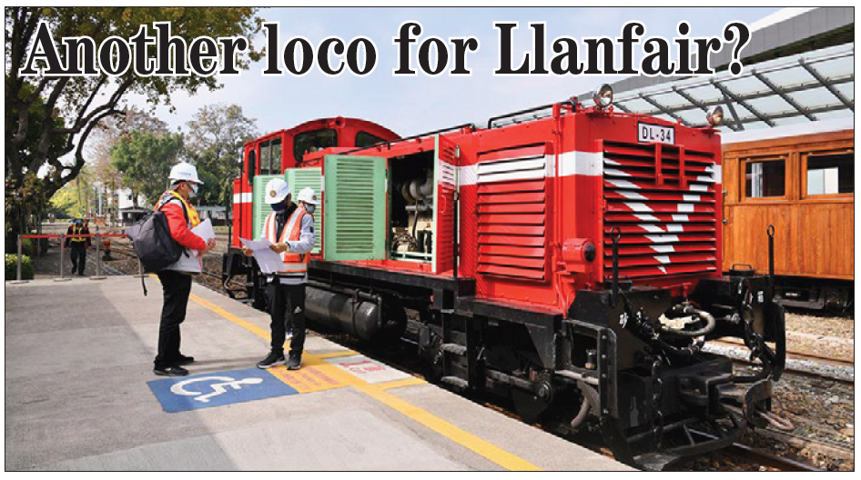

Pneuvac is the name given to the ejector in industry, where instead of steam it used compressed air, all the passenger carriages use a brake using a partial vacuum well OK no such thing really vacuum means no air, so bad English to refer to partial vacuum, but this is because we normally use steam, so if we use diesel like this 1655327435287.png some method is required to produce the vacuum, however it seems the ejector is not permitted, they have to have a vacuum pump fitted, the exhauster the same things were used to suck up milk and empty grids on the road side, so I have seen these many times, a more sophisticated type was used with blowers where the paddles did not rub on the outer shell but were held off.
With the Milk Tanker the pump was electrically driven as did not want a diesel engine running in farm yards, and the vehicle had Nickel Iron batteries to run the pump.
So as an ex-motor vehicle fitter producing a vacuum seems easy, with either an air powered or electric powered vac pump, but it seems not allowed to use these with trains, and I can't understand why. OK these
are only like an alternator to fit, so sure the engine can be modified, but why are electric and air powered units not permitted.
I suspect there may have been a slight difference for the milk pumps.
It looks as though the exhauster uses the same principal as a laboratory rotary vane vacuum pump; and as such relies on a film of oil to maintain a seal between the vanes and the casing.
Oil contamination of the milk would not be desirable!
They also consume a quantity of oil in use that is smoked out of the exhaust.
I can only guess that there could be so little demand for such units, that to get them certified for rail use would be untenable?
Or could it be that a safety critical system would be relying on other systems, with multiple points of failure?

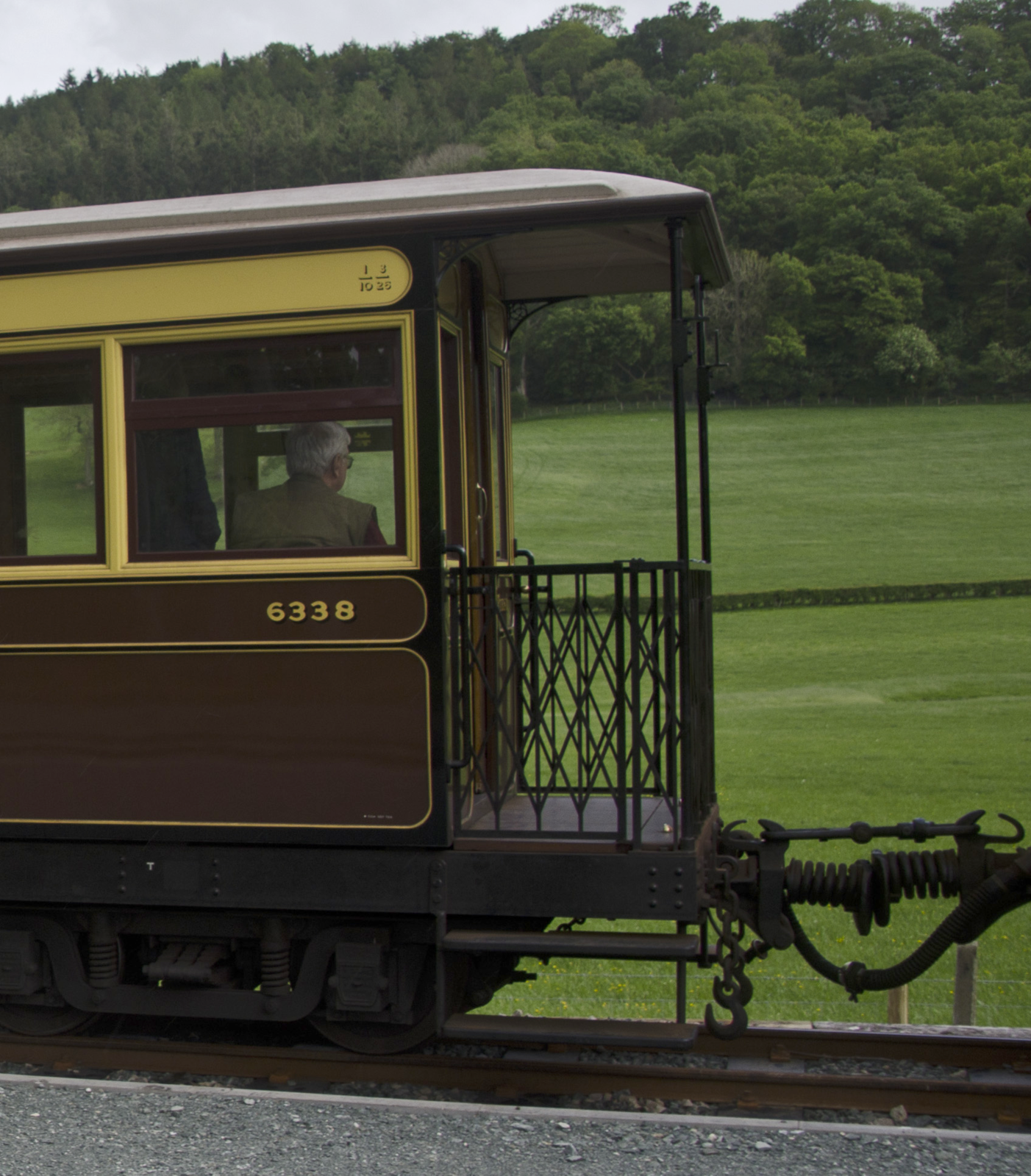

But local line has a 16 MPH speed limit, so not really a problem with 2'6" gauge.
ahh ok i dont know if the light railway act applies equally to narrow gauge as 4ft 8 i assume it does but i dont know
i would assume continual braking and communication in emergency still applies from end to end ??
Not seen an emergency cord, guess the guard can apply brakes, but not general public, unlike main line there is also a veranda, 1655336846380.png at 16 MPH OK, would not want to go outside at 30 MPH.
