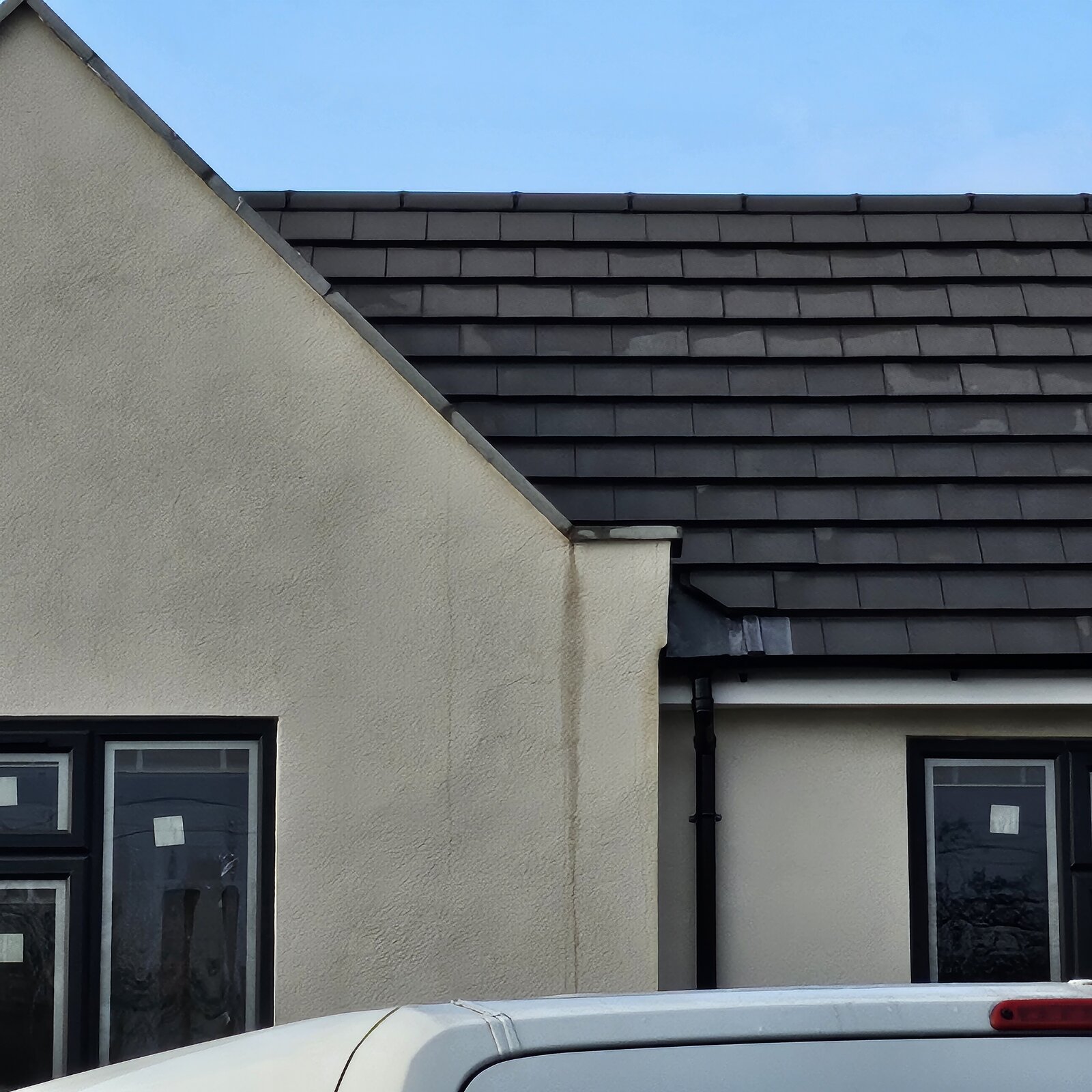

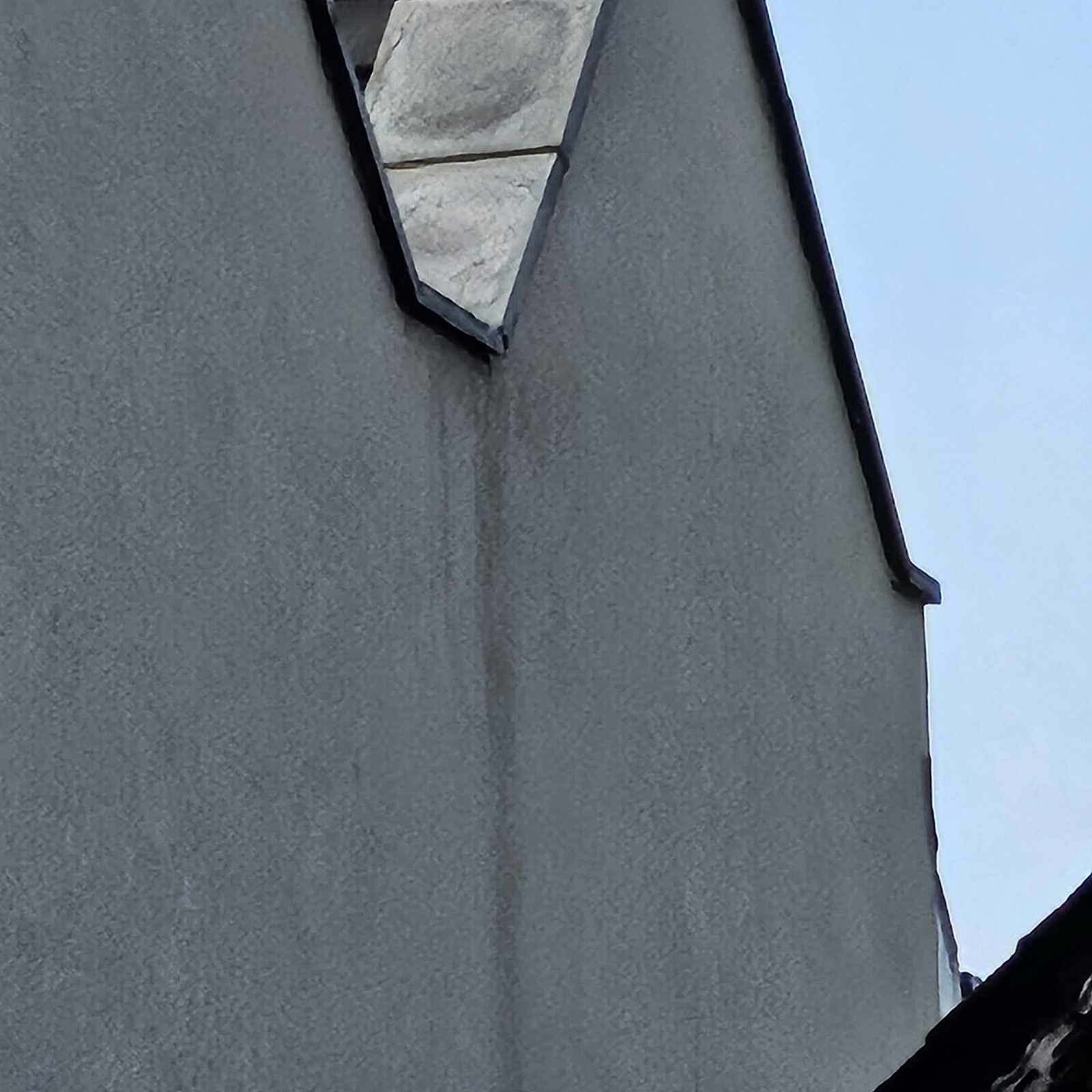

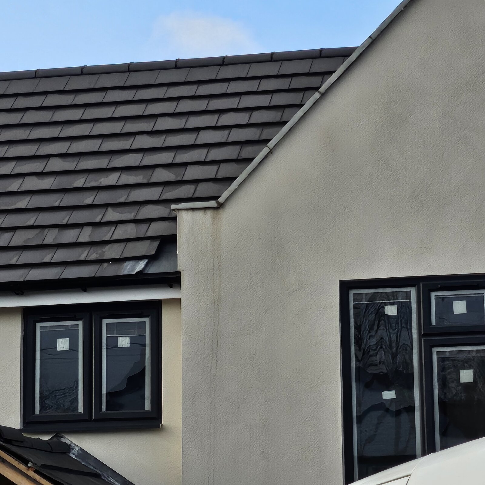

Hi,
Any thoughts on what I can do to stop the rain dripping down onto the walls as shown in the attached photo? Seems to be coming through the concrete joint at the base of the tile joint.

Its not unusual for the drip to fail at the mortar joint, as very few builders will shape the mortar to continue the drip.
