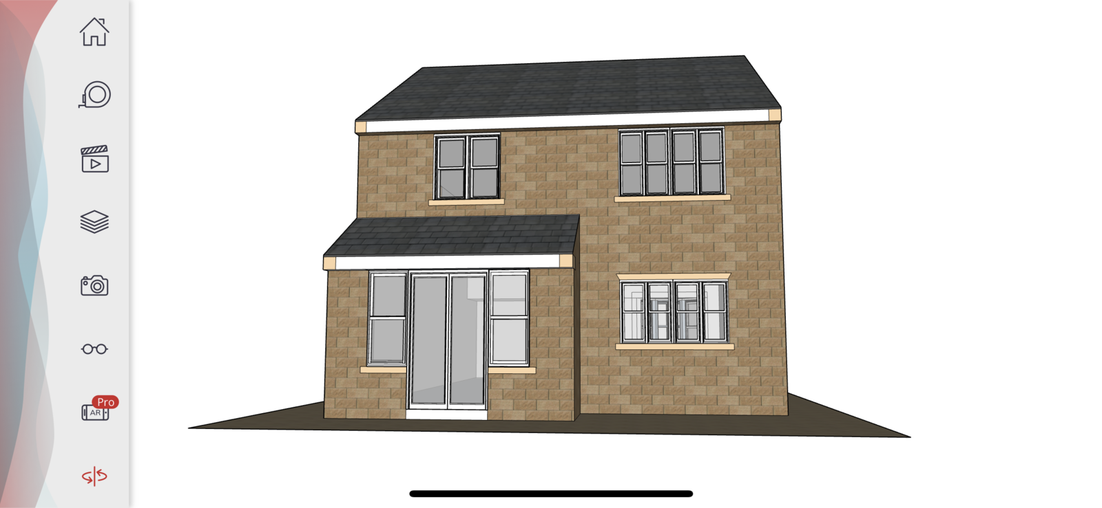

Hi
I had what could be described as a lean to on the back of the house. Was part of the original house. The water off the house roof was fed onto this little roof which then was fed Into what I assume is surface water drain to the left hand side.
I have now had an extension built onto this lean to. So the lean to roof has come off and replaced with a normal pitched roof (so runs the other way if that makes sense). So the water off the left hand side of the roof goes into the original drain. The water off the right hand side has been fed with a drain pipe so it enters the foul drain under the kitchen window.
Is this even allowed or is it going to cause me a problem when the building control guy comes to approve the completion. (99% completed now)
Cheers

Ok well I guess I knew they could refuse to sign it off. Just kind of wondering what my options are now. Or the builders more to the point. Either means lots of digging round the extension to route it back to where it was originally or is a water but an option?
Most the water goes back to the original drain. It’s just the additional if you like that doesn’t.

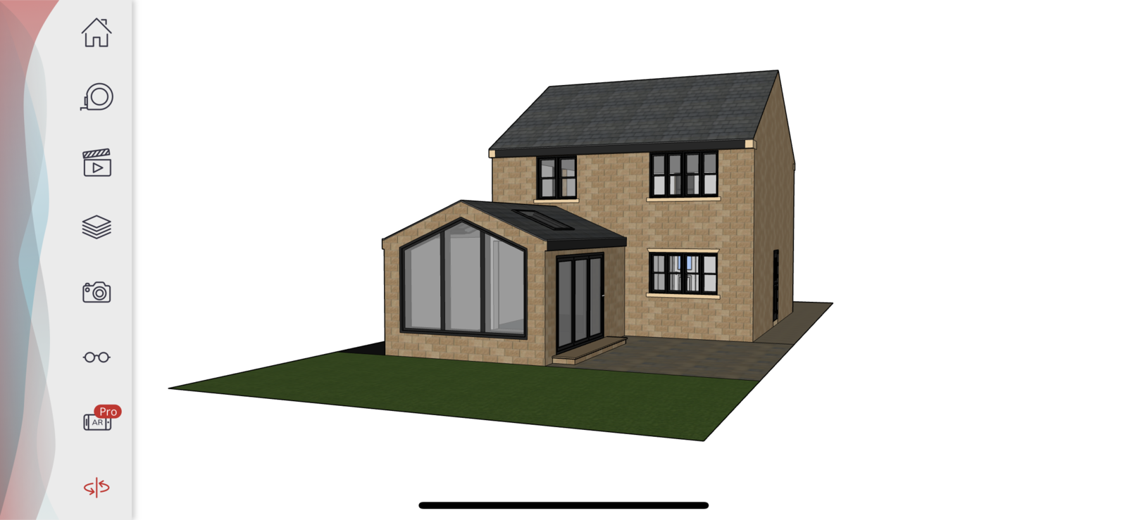

Pictures added. Water originally ran to the left hand side as you look the lean to. Left hand side still does. Right hand side has nowhere to go.

You can only connect rainwater to a foul drain (via a trapped gulley) if it is a combined foul and surface water drainage system . Is it a separate or combined drainage system :?:
Why can't drains be routed around the extension to connect to the existing surface water drain :?:
I assume it’s separate as the house was built in 97 and I can’t see anywhere where the rainwater connects to the foul water. I have a couple of manholes but can trace them only to the house waste. The drain pipes have some ridding points but looks like these just go off to the road.
Drains will have to be routed round the extension underground. That was my concern. This thing has been a nightmare from the beginning and the thought of having the builder back to do more work fills me with dread.
Can surface water drains be quite close to the house underground or do they have to be a certain distance away from foundations? It’s all quite close to my neighbours fence you see
Roof drainage calculator -- on Google -- then you'll know the max. amount of water likely on the RH roof. Then you could put a soakaway in your garden of adequate size using crates, if the ground percolation test is OK. A bit of working out - and a butt in the layout is always useful anyway.
