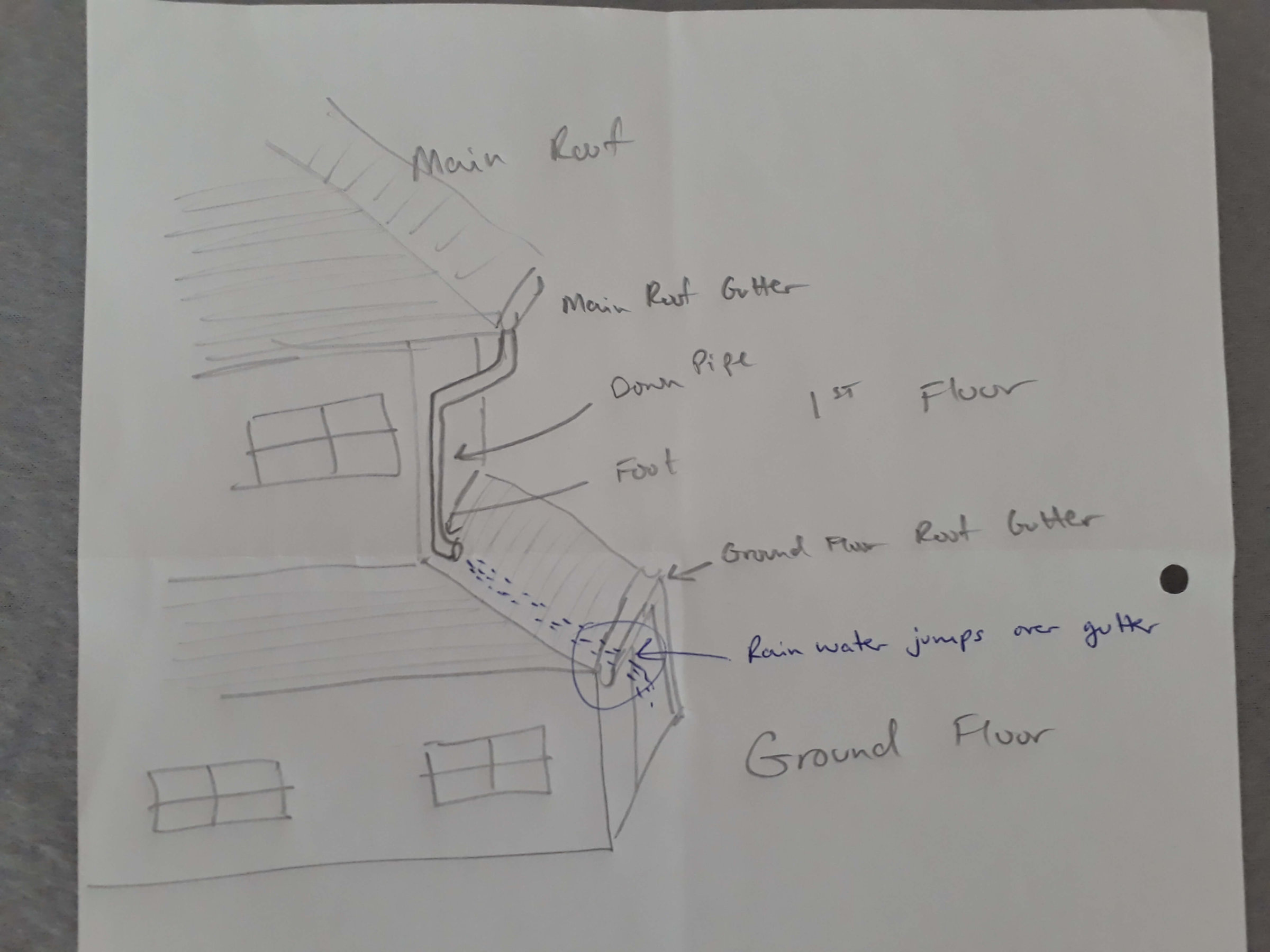

Thank you all for you replies.
It is quite hard to take a phot of the area, but I hope this drawing helps show the problem. The water from the roof's gutter is discharged onto the ground floor extension's roof. As it comes down that lower roof it can have so much speed that it can jump the lower roof's gutter.
Can you angle the spout to that the water takes a different route down the roof fall?
This has been suggested. But I do worry that having water running across roof tiles at an angle may cause unintended consequences. However, I'm not in the trade, so I don't know much about roof tiles and could by worrying about nothing.

Its a common and standard arrangement. There should be a shoe or a small angled extension and then a sideways shoe to slow down the flow.
It it's flowing over the bottom gutter then it's a problem with thea gutter or eaves tiles, and not the downpipe.
