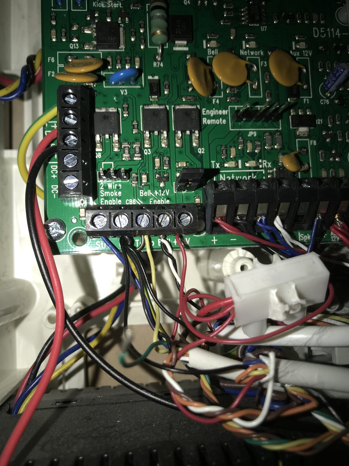

Here is a picture of the bell box wiring.

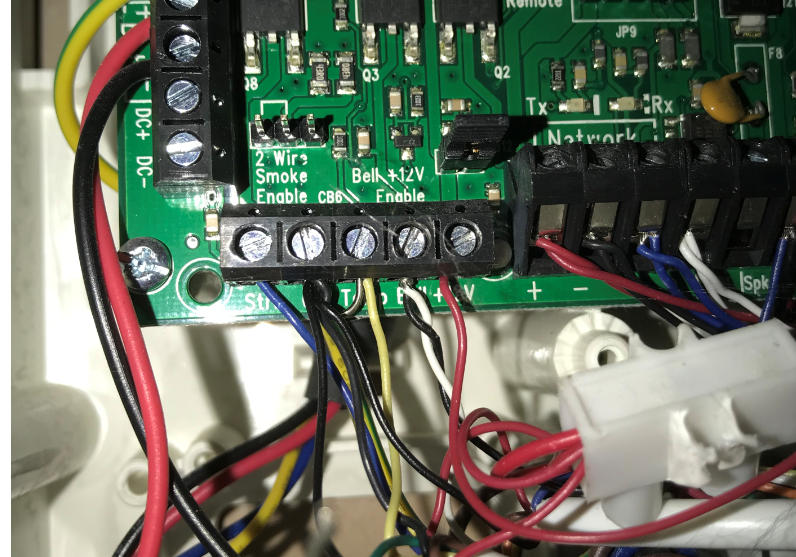

I have been working on this since and have an update I would like to share. I am hoping this will help diagnose the issues I am experiencing.
There are a total of 4 cables in this image connecting into the "siren section" of the board.
This includes (wiring details in brackets):
External siren at front of house (12v, 0v, Tamper, Strobe)
External siren at rear of house (12v, 0v)
Internal sounder on landing (12v, Bell)
Internal Sounder and Speaker in hallway (12v, 0v, Bell, Spk-)
Neither of the external siren boxes have the bell wire connected but despite that I have been getting these random blasts of the siren (from both siren boxes) and most recently, I had the continuous bellowing of siren on the external siren at the front of the house. Interested to hear any possible explanations for this.
I then disconnected all of these wires and wanted to share the following observations:
- When the external siren at front of house only had its 12v and 0V wired, it had no blinking LED on the external box. Since this is the box that caused the recent issues, I have completely disconnected it for now.
- When that metal loop wasn't trapped between 0v and Tamper, the Control Panel was ringing out the alarm (from its onboard speaker) but when I entered my code into the keypad, this stopped. When the metal loop was reinserted, I didn't have this issue when re-powering the system during my testing. Please note that the cover was off the control panel when I was performing these tests.
I don't own a multi-meter and therefore can't report the voltages but am hoping that the above provides some clues.
After wiring everything (apart from the external siren at the front of the house), I successfully completed a Walk Test and all seems operational again. I still have the outstanding issue with the siren box at the front of the house but also have reservations with the siren box at the rear as hat has also been randomly going off.
Can I please have your advice on this. Thanks again.
