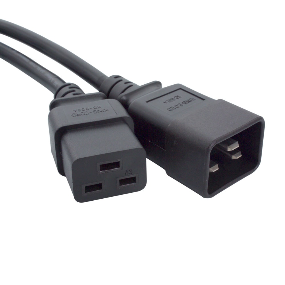

I've just received this reply to an enquiry with a well known electronic/electrical supplier:
Further to your error report for the IEC Male C20 to Female C19 Extension Lead.
After checking, the lead is certified at 16A with 1.0mm2 cable. This range of cables has 1.0mm2 cable for lengths of 2m or less, with 1.5mm2 cable for lengths above 2m.
Should I be feeling concerned about using them to supply power to a 3.6KW load?

These are extention leads with moulded 16A connectors.
I'm pretty sure there is a rule in some IEC standard that says 0.75mm² is nominally rated at 6A, but this can be increased to 10A for short leads. I would not be surprised if there was a similar rule for 1.0mm².
I presume the thinking is that a short lead is less likely to be subject to grouping/coiling/enclosure, so they can use a rating methodology closer to what BS7671 would desribe as "free air".

It would be sensible to use the leads that come in 1.5mm, those on Amazon quote 10A for 1.0mm cable, 16A for 1.5mm, so maybe an error on your suppliers part

I thought the ''kettle'' connectors were rated at 10A?
C19/20 aren't kettle connectors, they're significantly bigger and the pins are at 90 degrees to those on the smaller version.

That's why I enquired, as the paper catalogue states 1.5mm² for the whole range of lengths and manufacturers docs in the site state 1.5mm². However the on line catalogue lists variously as 1.0 or 1.5mm².
From their reply it looks fairly explicit.
It's gonna get warm..... :)
