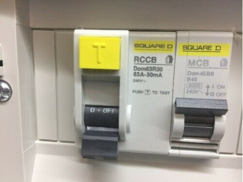

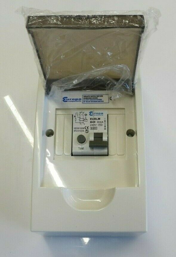

Hi
I have a Sunbed that needs wiring in, it has a load of 6700W , am thinking of getting somerthing like the following item ( Pic attached for 2 types ) been told though that this needs to have a type "C" MCB and the RCD needs to have a trip of 100mA as apposed to the normal 30mA trip, they reckon it is like a electric motor when starting up ! .
Can anyone confirm if this is the case, not easy to find 45A 100mA .
cheers
Spike

If the wiring is installed in such a way that it needs 30ma protection, then surely its not possible to wire it to a 100ma Rcd,
Even if you fed that remote enclosure and put in a 100ma, fed from the 45 amp Mcb, there would be no point as it appears the 45a Mcb is fed off the adjacent 30ma trip

Relevant bit from the very end of that “tech info”pdf:
RCD’s trip with an earth leakage of 30mA which is sufficiently low enough to protect against electric shock, and is the industry standard size of RCD. But what is unusual about sunbeds is that the choke (ballast) inside that supplies each lamp, by its very nature, has a natural earth leakage of around 0.75mA.. This is inherent in its design, as a copper coil surrounding a soft iron core. Hence a 40 tube sunbed can easily have a total earth leakage of 30mA, and a 50 tube sunbed almost certainly would.​
Mine has 40 tubes

Going to use 6mm2
Depending on what sort of earthing system your installation has, it might be impossible with any length of any size cable ...
... with a 45A Type C MCB/RCBO, the maximum permissible loop impedance would be around 0.49Ω, and that is the total of the impedance outside of your house (from your house to the substation), over which you have no control, and of the cable within your house. Given that the former component (over which you have no control) might be as high as 0.8Ω, it obviously might be impossible to get the total down to 0.49Ω !
I think you need an electrician to look into this, and to make some measurements!
Kind Regards, John
Kind Regards, John
Have decided it is not going to be within the house cicuit ( Blue phase) , am taking a feed from one of the phases ( Yellow phase ) in another part of the farm building, and putting it in a room within the farm building, where we have set up has a training/weight lifting etc room , the 3 phase feed to the farm is a TT system, there is several earth rods around the buildings .
