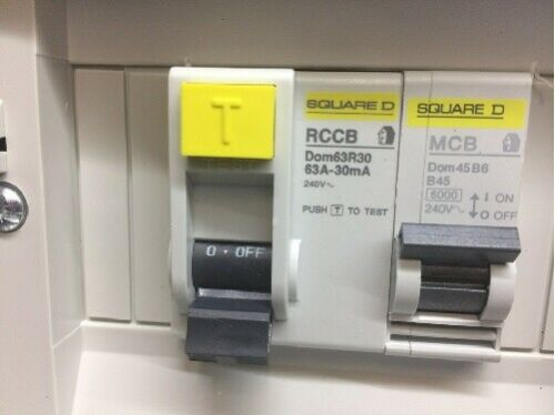

Have decided it is not going to be within the house cicuit ( Blue phase) , am taking a feed from one of the phases ( Yellow phase ) in another part of the farm building, and putting it in a room within the farm building, where we have set up has a training/weight lifting etc room , the 3 phase feed to the farm is a TT system, there is several earth rods around the buildings .
Fair enough.
Where the supply comes from (and which phase) doesn't really make any difference to anything, but the fact that you're talking about a TT system moves the goalposts a lot. That means that MCBs/RCBOs cannot provide the required fault protection (hence what I said about maximum loop impedance in my last post doesn't apply), so you would have to rely on the residual current device (RCD or RCBO) to provide the fault protection - and a 100 mA one would be fine for that.
Whether or not it would be wise to get onto/into a sunbed which did not have 30mA residual current protection is perhaps a debatable question (and I'm still wondering where all that power is going!).
Kind Regards, John

Therefore use a higher rated 100mA RCD, 63A or 80A perhaps, with a 40A MCB after it.
The ampere rating of an RCD refers to the rating of the contact current, not any form of tripping capability.
Yes sorry, meant the RCD has to have a 100mA trip , not the 45A MCB, I did say that it my first post !

Yes there is large fan above it, why is this post now getting so complicated, there is not much difference in wiring this up as there is in wiring up a 8KW shower !.
Spike
This is what I am thinking of putting in .
There is a lot of difference
An electric shower would not create more than a few mA (milli-Amps) of Earth leakage current, far less than the 30 mA that would trip the 30mA RCD that an electric shower has to have to reduce the risk of death by electrocution when the shower becomes faulty.
The sunbed when operating normally appears to produce more than 30mA of earth leakage current hence the manufacturer/seller saying a 100mA RCD is needed.
If there is a fault that allows current to flow to ground through a person then the RCD needs to operate at less than 30mA to reduce the risk of that person dying from electrocution.
Yes understand that, will get a 100mA if I can find one, can't see it been a risk using a 30mA , other than it will keep tripping if the leakage is as they say, read on this same forum posts fro 2018, where Electrcians are saying they put in 30mA RCD's and they have never had a problem with them tripping will feel better if 30mA will run ok , if not then will have to buy another RCD 100mA, prepared to do that .
