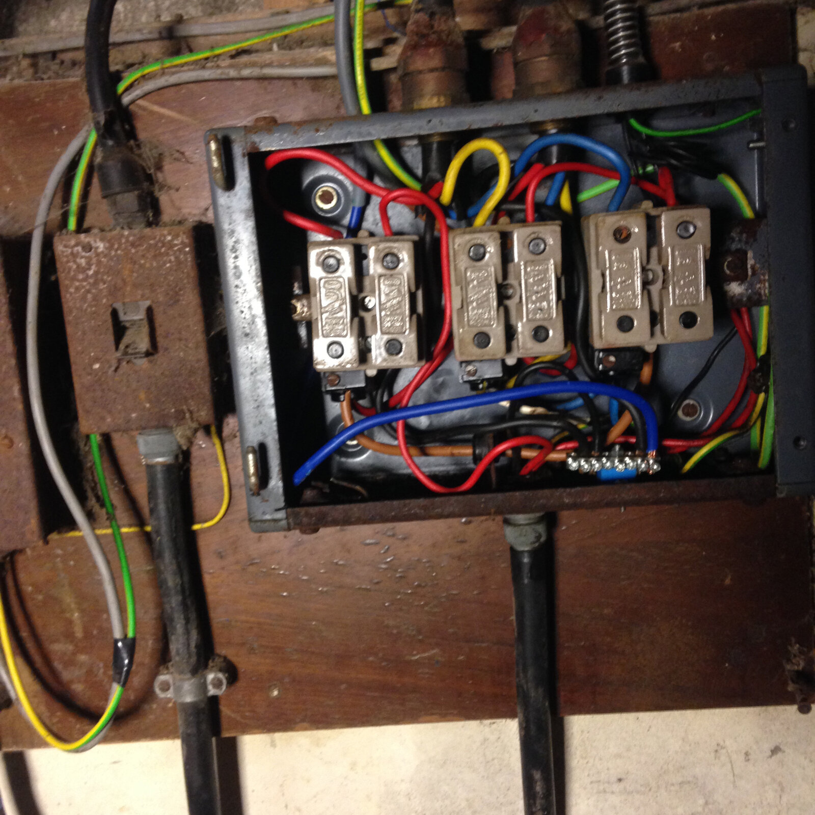

OK let me say it now what is intend to be done , then that will be the end of this .
Wanting to fit a Sunbed it has 40 tubes and the load will be 6700kw, I have a 80A supply, that supply comes from a 3 phase 80A delay RCD, feeding a 80A Main fuse box pictured , that will feed the 63A RCD / 45A MCB , 6mm2 will be fitted to the 45A MCB, then about 10 Mtr along the wall to the Sunbed room , where a 63A Rotary isolator will be fitted on the wall, then the Sunbed will fit direct to the Rotary swtch .

Pic of main Fuse Board
