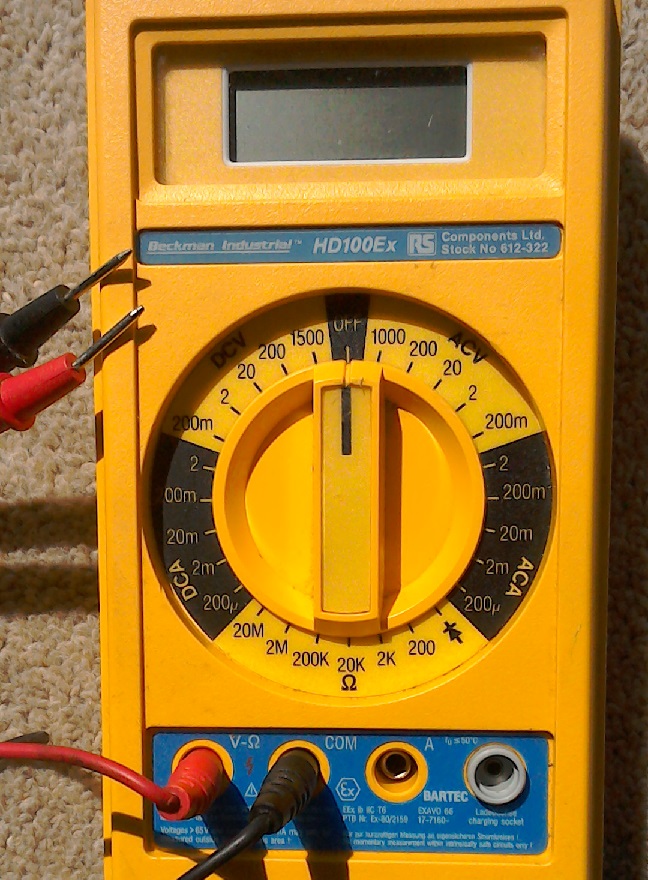

Thanks for the replies. I have a tester (never used it, not my line of business) and would appreciate some guidance before proceeding:
Are the wires in the correct sockets?
What should the dial be set to (a youtube video says 2000 ohms)?
To test 'earth' is it a case of 'black to either terminal, red to plate'? Or red to the element itself?

Set to 200Ω.
First measure between the two element terminals.
Depending on the rating of the element, the reading should be 25 to 50Ω (Watts / 240).
Then, still on 200 setting measure between each terminal and the plate (doesn't matter which lead is which).
If it reads 1 or OL go to next higher setting until you get a measurement.
Your meter isn't really suitable for a definitive test unless the element is obviously faulty.
Hi lads. Well, bit of a waste of time, that. When I made contact, there was a brief flurry of numbers then the display went to OL and stayed there, despite me 'rebooting' the tester. That tester has lain in the garage a LONG time so perhaps its battery (I'm assuming it has one?) is dead?
Are the wires stuck in the correct holes (see above)? That's the way I found it.

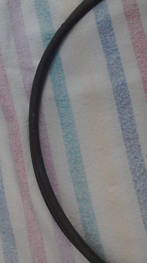

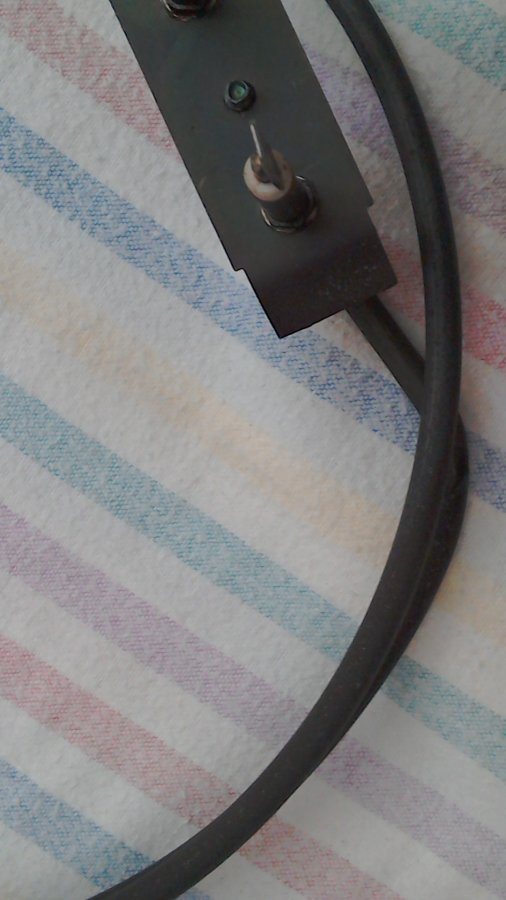

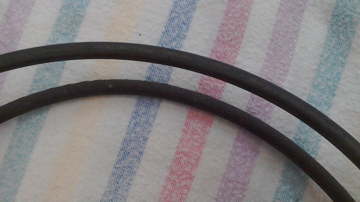

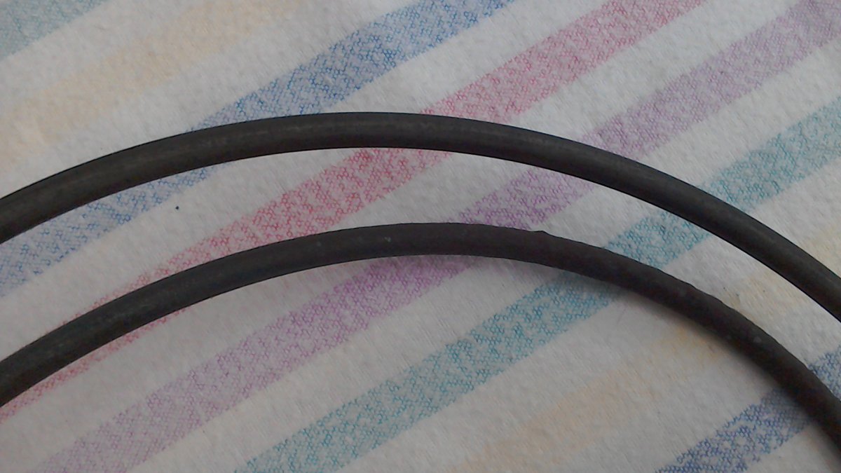

Here's some pics of the real element(!). Some 'bubbling' evident but does it look that bad to you?

Yes, the leads are in the right places.
Can't really tell from the pictures but it is obviously 'going' and as the trip only occurs when hot, it is unlikely to be found when cold with your meter.
When it heats up it may distort and cause the fault.
