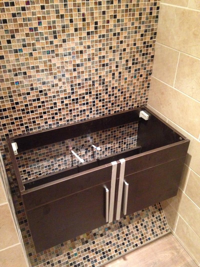

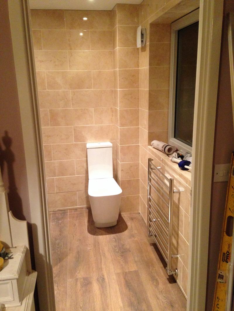

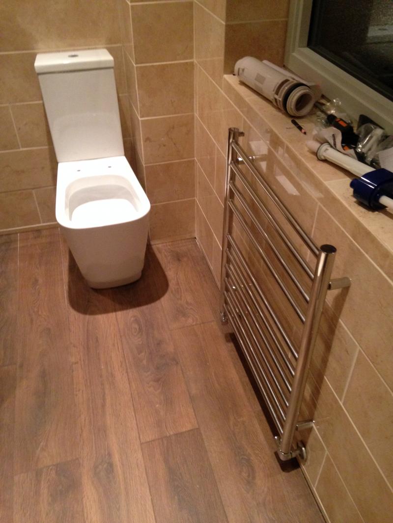

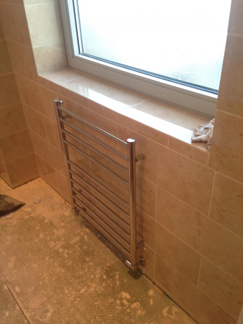

I had a spare hour yesterday evening and managed to get the towel rail fitted, plumbed in and tested. Decided to go for a stainless steel radiator so it won't ever rust as it's in a shower room....

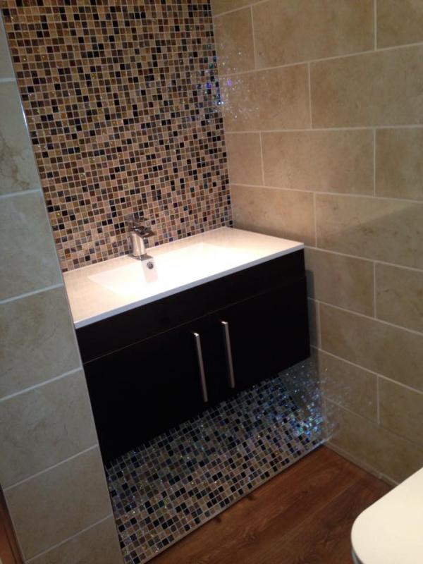

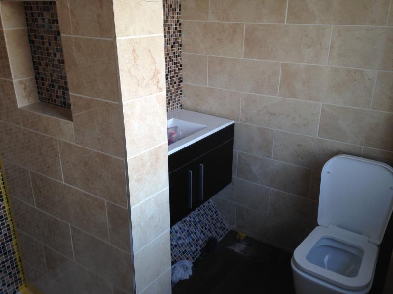

Fitted the flooring, plumbed in the sink and toilet.... Had a slight problem with the toilet, after fitting I noticed a puddle of water forming from under the toilet after it had been flushed.... Checked all plumbing and then re-tested, leak still present... Had a closer inspection and discovered there was a hairline crack in the flush pipe of the toilet pan, got a replacement pan sent out and now no leaks :)

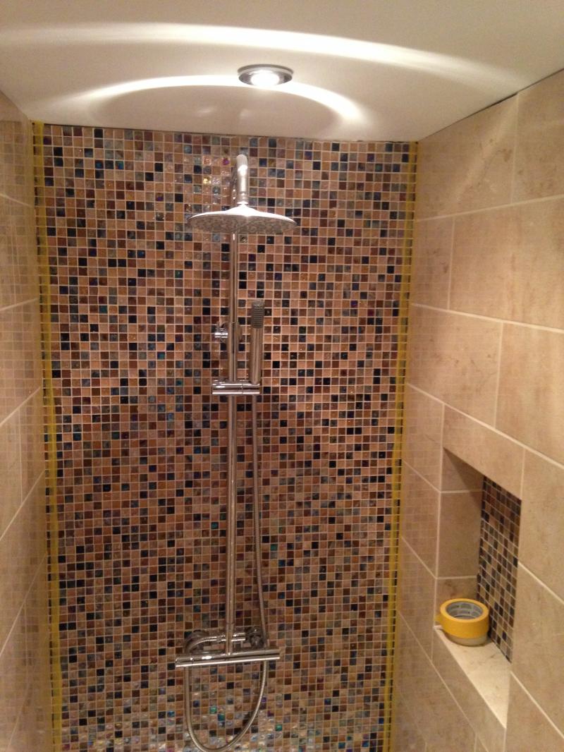

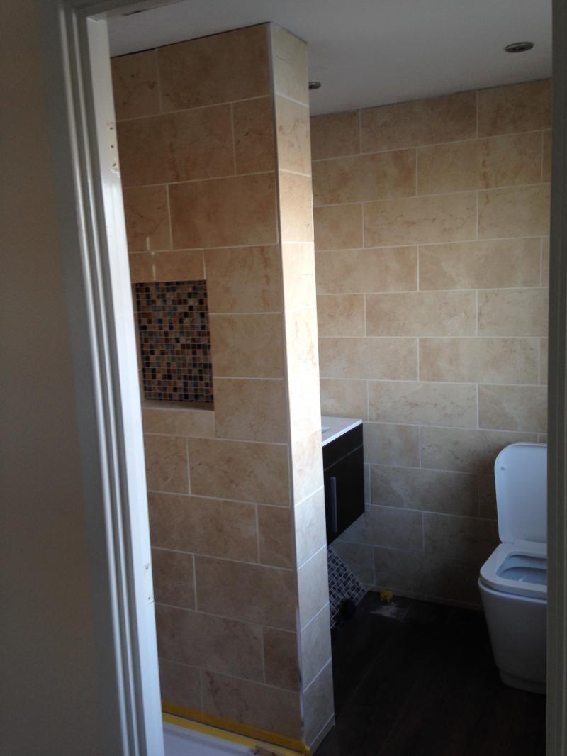

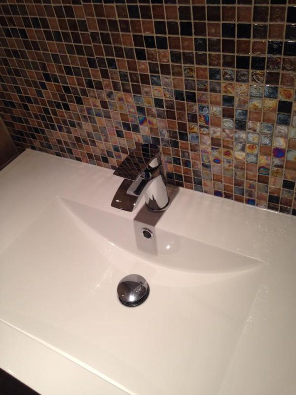

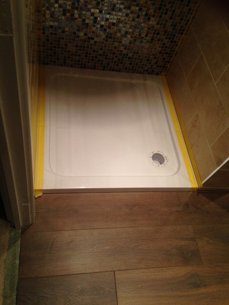

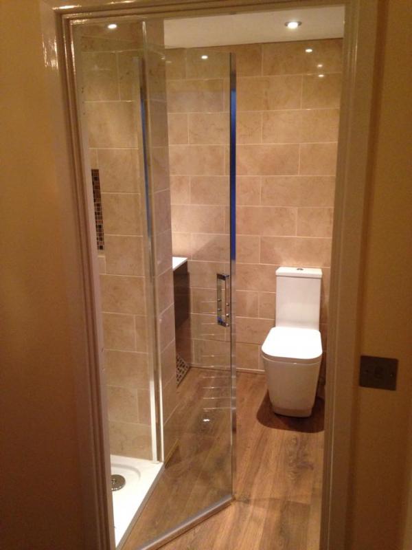

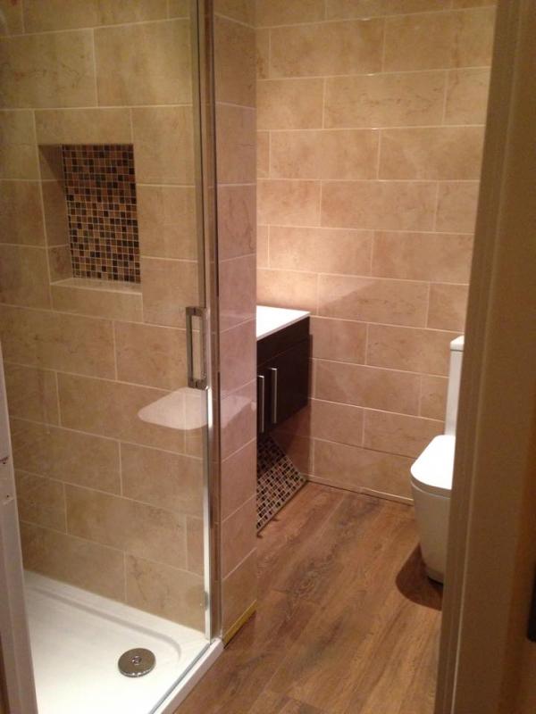

Here's the photos of the finished project...
