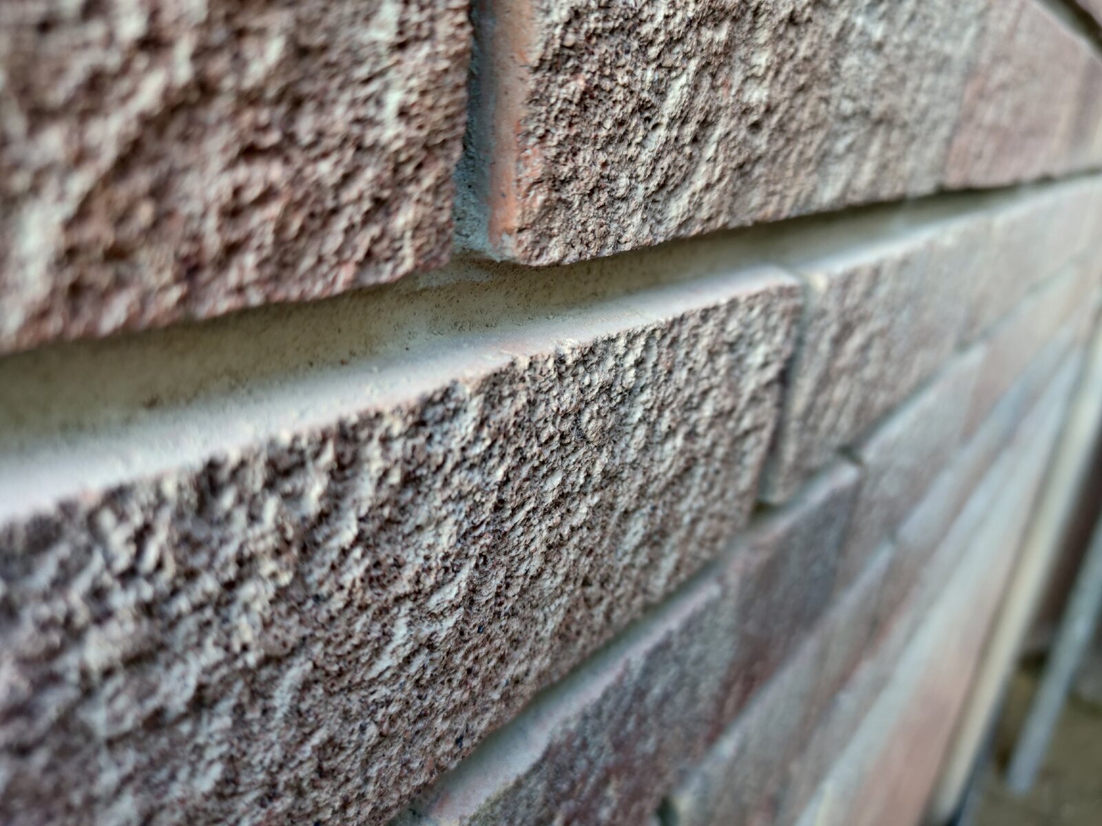

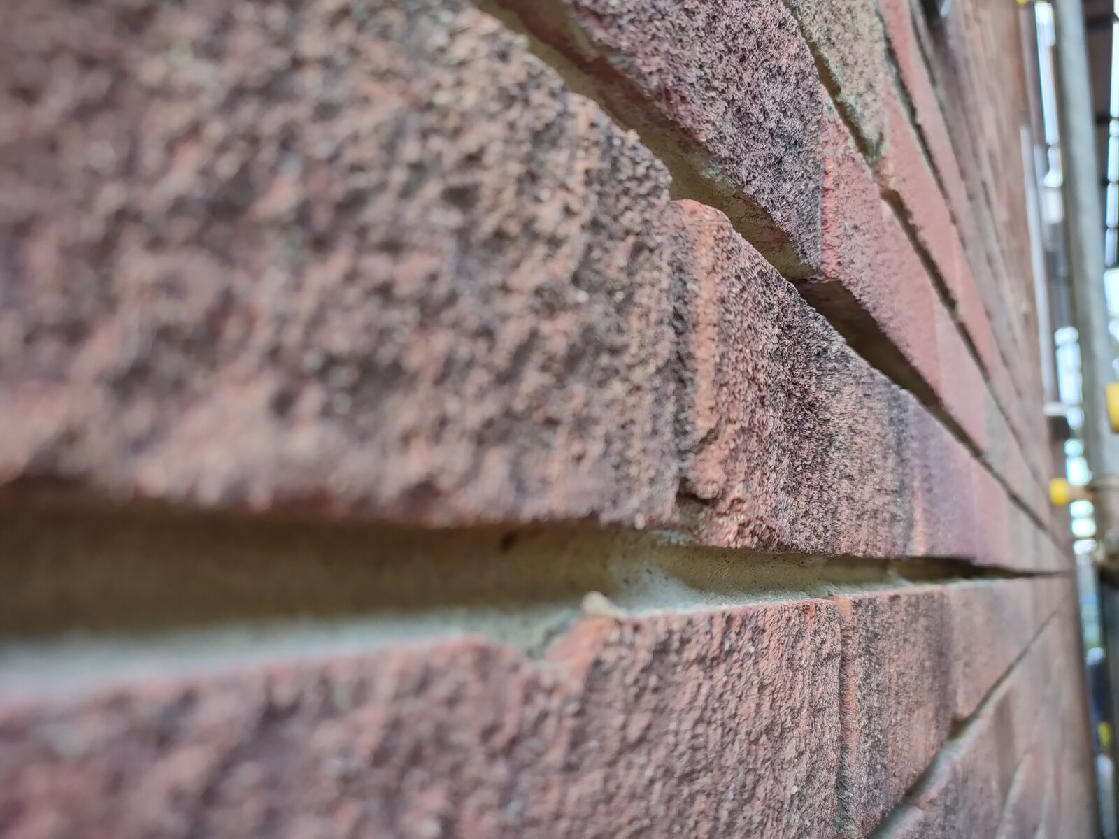

Having the side of my house repointed and I have a question as to how deep the guy should go.
Unfortunately after attempting to get 4 People round to have a look at doing the work, although 4 turned up only 1 quoted and that was even with me pestering the other 3. I tried on my builder and various other sites and no one was interested in the job apart from this one guy.
The side access is very tight at 90cm and I've had proper scaffolding erected.
Anyway back to my original point, what the guy has taken out of the mortar doesn't appear to be very deep and I'm worried it will blow out in next to no time.
I've actually got a proper taking tool that attaches to an angle grinder (made by Irwin) that I purchased a few years back when my dad needed to do a bit of pointing, we used it once and the tool worked great but we found it a sod of a job to push the cement in, think one either has the knack or they dont., I think that goes about 25mm deep.
I've attached a couple of pics, what do you guys think?

Hard to tell exactly from the pics, but I was once told rake out twice the joint width (eg 20mm if theyre 10mm joints)
25mm is about standard.
I have the same irwin tool and it's good, however, i use a grinding disc to remove most of the old mortar, then the irwin attachment to "clean" the joints.
Your joints seems to be a bit shallow, but maybe pictures don't do justice.

Depth is between 10 & 15mm
I'll have to have a word with the guy tomorrow

25mm. And nice and square.
That depth in the photos will lead to the pointing coming loose very soon, and is a cowboy job.

just spoke to the pointer, said he will rake out to 25mm, he said its not a great deal more work, and the worst bit at the top of the gable was probaby that anyway.
ive asked him to point it flush aswell and he said he needs to get more sand to do a flush point as it has a different ratio to a half round point, is this correct?

You sure you want flush? Not sure what it’d look like on those bricks, it’s more often used on old uneven size bricks
Most common on yours after bucket handled would be recessed or weatherstruck
no idea why it’s a different ratio
LOL. No he's chatting shiit.
The joint gets filled up in either case , it's just then ironed for half-round or weathered, or left and rubbed for flush.
Incidentally, flush pointing is the least weather resisting, so should be avoided for exposed walls. And if your guy is as shiit as he seems to be, weathered will look even shiitter.

ah ok, so spoke to him again and we are back to doing half round pointing.
