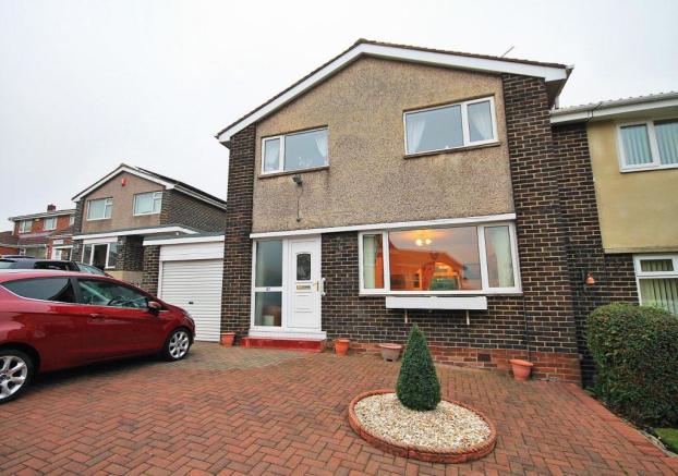

it's the porous bricks I'm more concerned about. Husband went up and did a bit of patching on the gable end (actually it's not the gable as our 60's house has gable end front facing) but we've got water coming in in the garage and doorway between the kitchen and utility where we're just about to put insulated plasterboard. It's when the rain blows onto the end of the house (from the NE)

Cheers. Pretty sure it must be. It only happens when we have heavy rain with the wind blowing onto the end of the house. It's happened 3 times in the last 18 months. Always in the same 2 /3 small places along the length of the util/garage.
At the moment we've got the cavity exposed in the "external" doorway between the kitchen and utility, and there it drips down from the top of the reveal.
In the garage there's a batten where ceiling boards have been attached and it just seems to appear there in 1 or 2 spots and run down the garage wall. We've cut some of the ceiling boards away so we could put brackets up for storage and there's no sign of any water on the underside of the garage roof.
Above one of the spots there's a window (landing) and the UPVC sill sits on top of the original tiles of which there's 2 layers with mortar between, so the rain might be managing to get in there, although the UPVC sill sticks out about 50 mm further than they do and is obviously sloped downwards.
We've had a new main roof and flat roof on the garage utility. On the flat roof there's a double layer of felt let into the brickwork on the side of the house with a good, solid amount of mortar. Minimal water collecting on the flat roof. There's a gutter running the full length of the side of the house and it's clear and water is running out of the downspout on the back of the house.

Everyone has opinions regarding what makes a house look attractive, but not sure anyone could say our brickwork was pretty or even rustic, and the size of the windows gives it a very "distinctive" look. We won't be changing the size of any windows
If we don't opt just to repoint we'll probably go for a mix of the original brickwork and render and maybe some cladding. As you can see we've already got nasty pebbledash on a lot of the front anyway (photo is from before we bought it)

Must be a 70' design built in the 60's then. The pointing on the front and back of the house isn't too bad. The back looks a bit of a mess because of the waste pipe changes that have been made over the years, but repointing wouldn't change that. It's the side and the garage wall, especially the garage. It should be fairly sheltered by the house next door which is also at a higher level and never gets any direct sun.
I think we have fairly wide joints and someone has had a go at doing some repointing at some time (funnily enough where it rains in in the kitchen doorway) and its very grey (the original mortar is a light sandy colour and very soft in places -can be rubbed out with a finger) and looks bloody awful, which is another thing that's worrying us about repointing.
