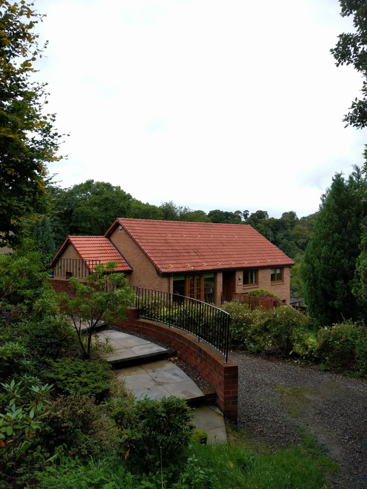

Here's a view of the whole roof. View attachment 126927
Your roof seems pretty straightforward, no lead valleys to be cut or awkward hip details.
Properly scaffolded it should be just a matter of up and over, strip of old roof, rebatten and underlay using modern breather membrane and then using a mobile conveyer to bring the tiles up ,a good squad of roofers shouldn't take that long to cover both sides, and if they use screw on dry ridge tiles it should be even quicker.
