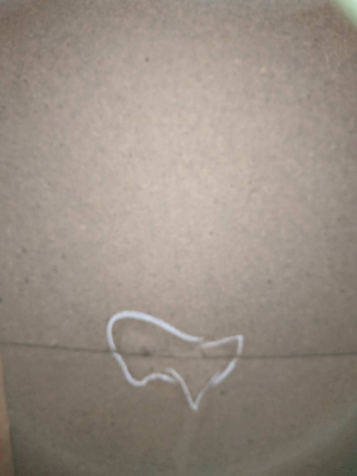

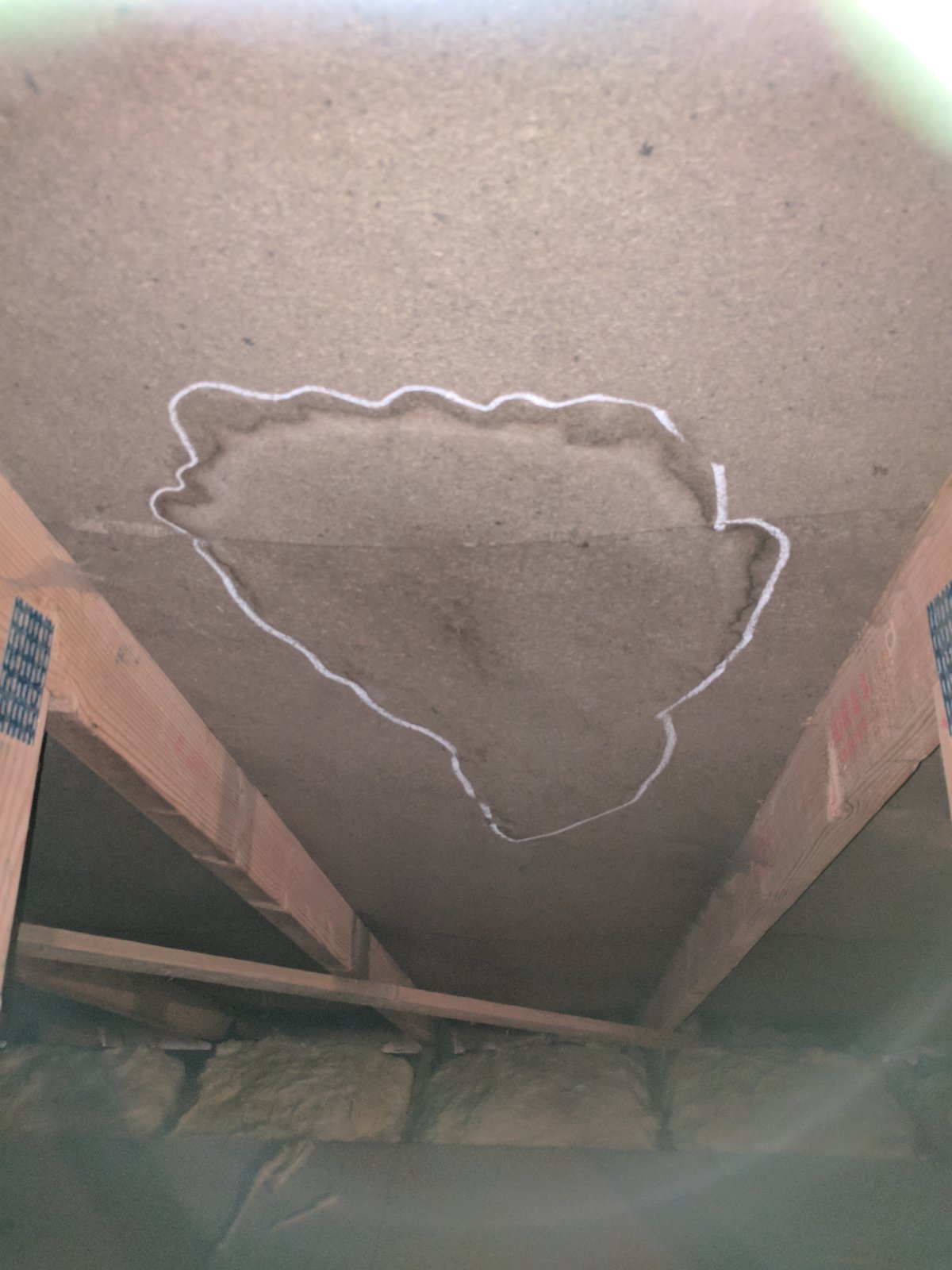

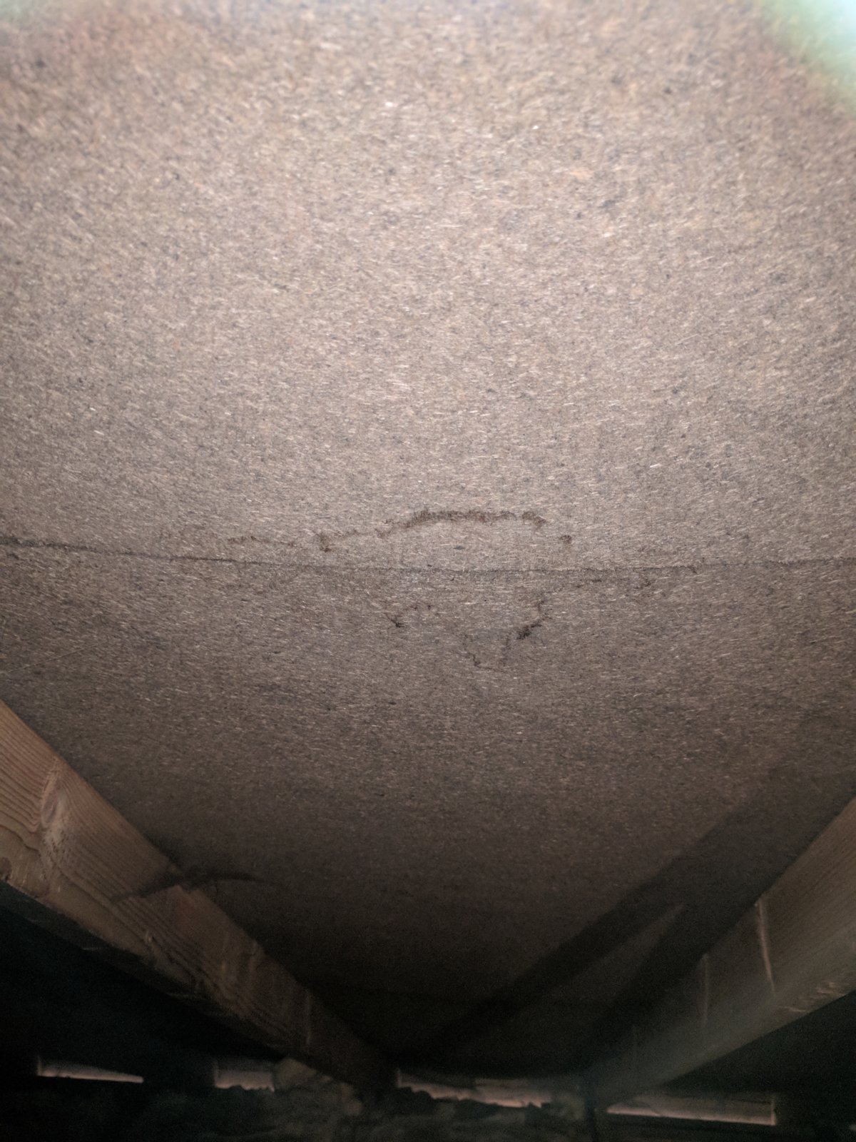

Here are some photos of the water marks left by the leaks. The majority of the boards are unstained and aren't sagging in any way. The chalk was so I could monitor if they were getting worse.

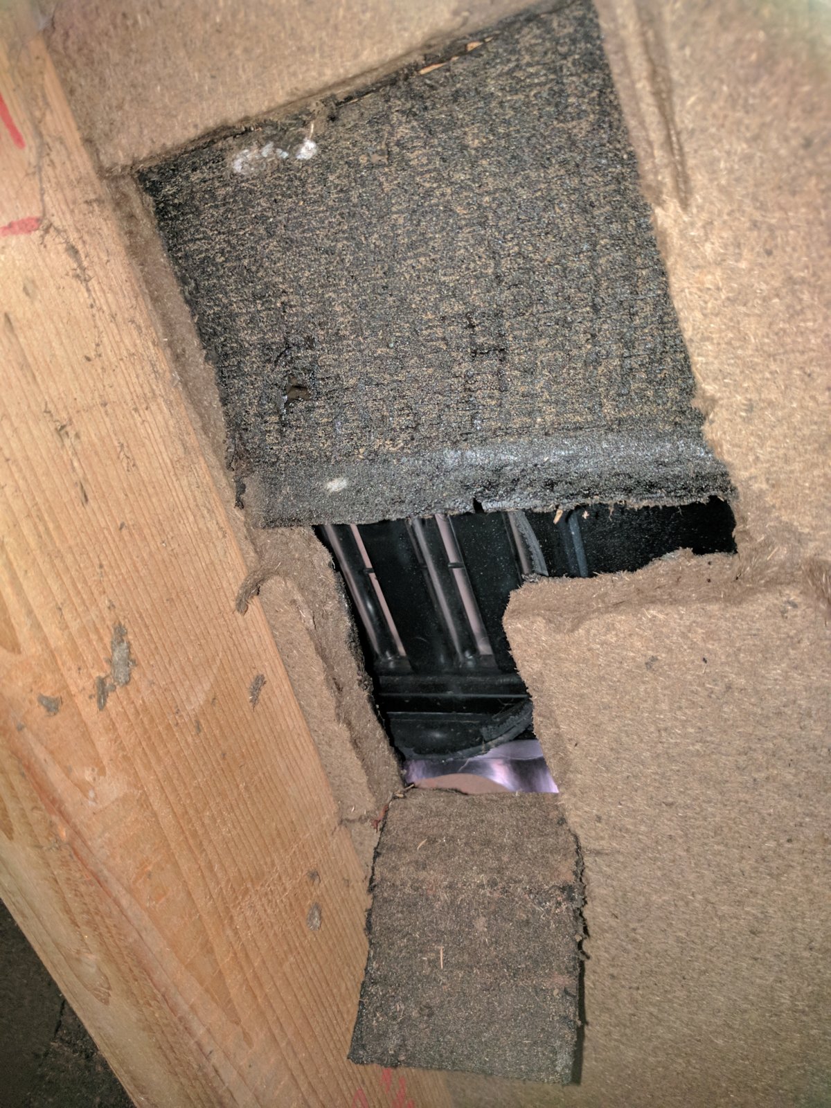

Also a photo of the one vent I've opened up. IMG_20171012_121711.jpgIMG_20171012_121754.jpg IMG_20171012_121745.jpg IMG_20171012_121732.jpg
I would still open the boards and felt to allow cross ventilation.

Those pics are water penetration.
