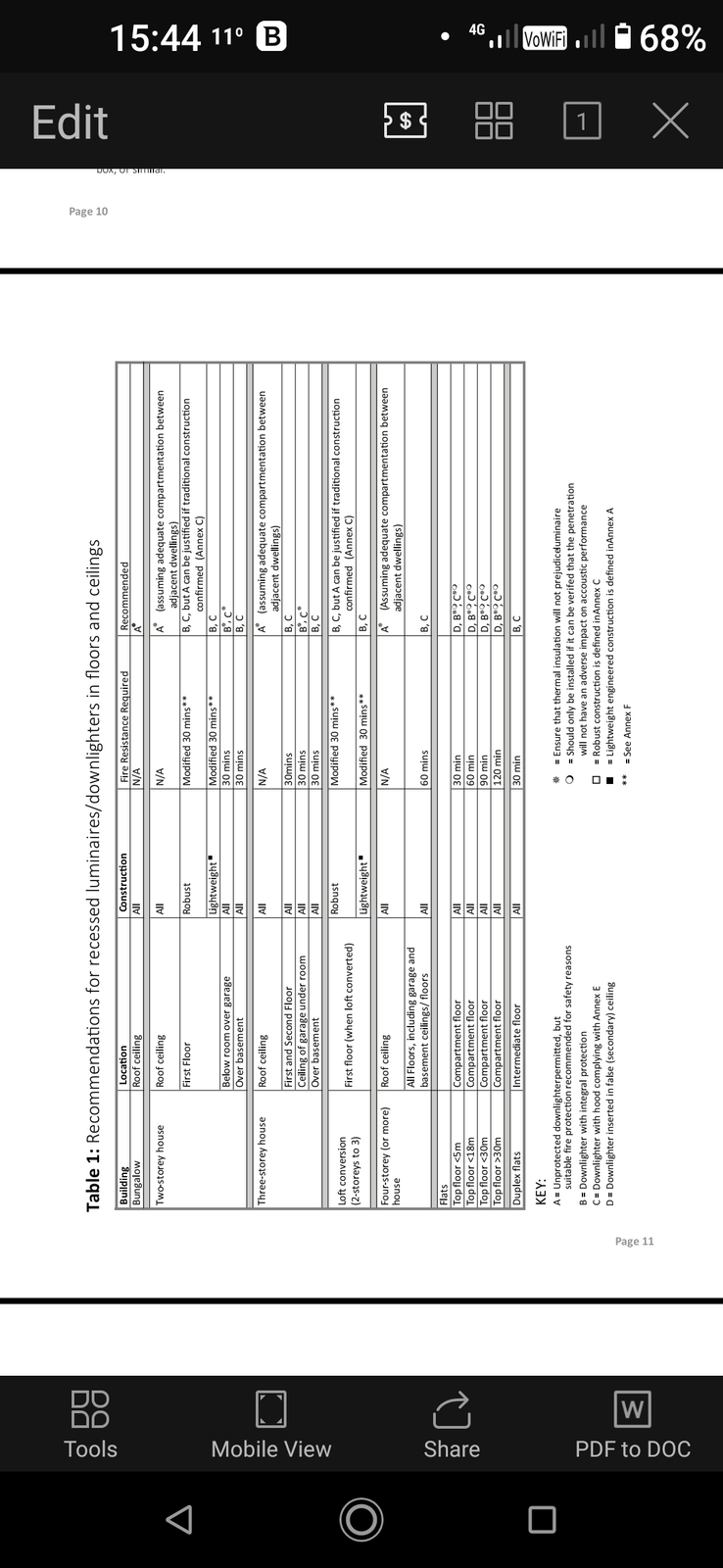

Have looked at the table provided on the esf website.
Trying to work out from the table whether fire-rated down lighters are required in a ground floor room of a two storey detached house.
To me, it's not easy to interpret the table.
What do you think?
I think it’s poorly worded but first floor is referring to the ceiling between the ground floor and first floor, and then roof ceiling is the ceiling between the first floor and the loft.
Also I believe their guidance to be incorrect. There is no requirement to install fire rated down lighters in a two story dwelling as the entire building is classed as a single fire compartment.
I don’t know about your house but my house has a huge hole in the ceiling between the ground floor and the first floor with a pile of flammable wood shoved in it. It’s where the stairs go through. A 70mm hole with a downlighter in it is going to be fairly insignificant compared to the stairs.
Fire rated down lighters = more profit to the manufacturers.
Entirely in agreement. Thank you for your interpretations.

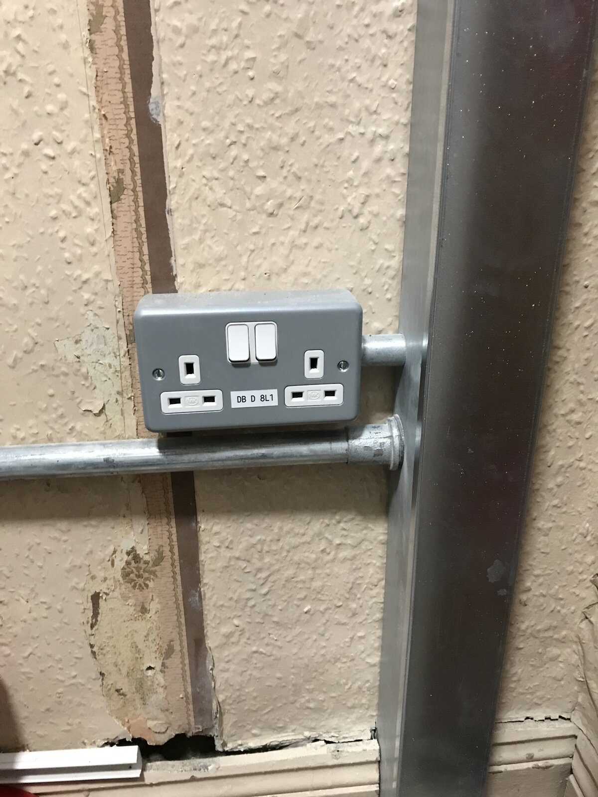

  • metal conduit connecting two or more CPC-connected backboxes (whether the conduit is 'in use' or not)
  • two or more CPC-connected backboxes (or metal sockets/accessories) in electrical contact with each other (e.g. metal sockets mounted on metal trunking) and/or structural metal of the building

Another possible cause of a "too low" reading (compared to the expected value for a ring wired in T&E with no paralell paths) would be if parts of the ring were wired in something other than T&E. For example flex has a "full size" CPC and I think NYY-J does too. 3 core SWA with a core used as CPC ends up with a "full-size" CPC and then the Armour on top of that.
