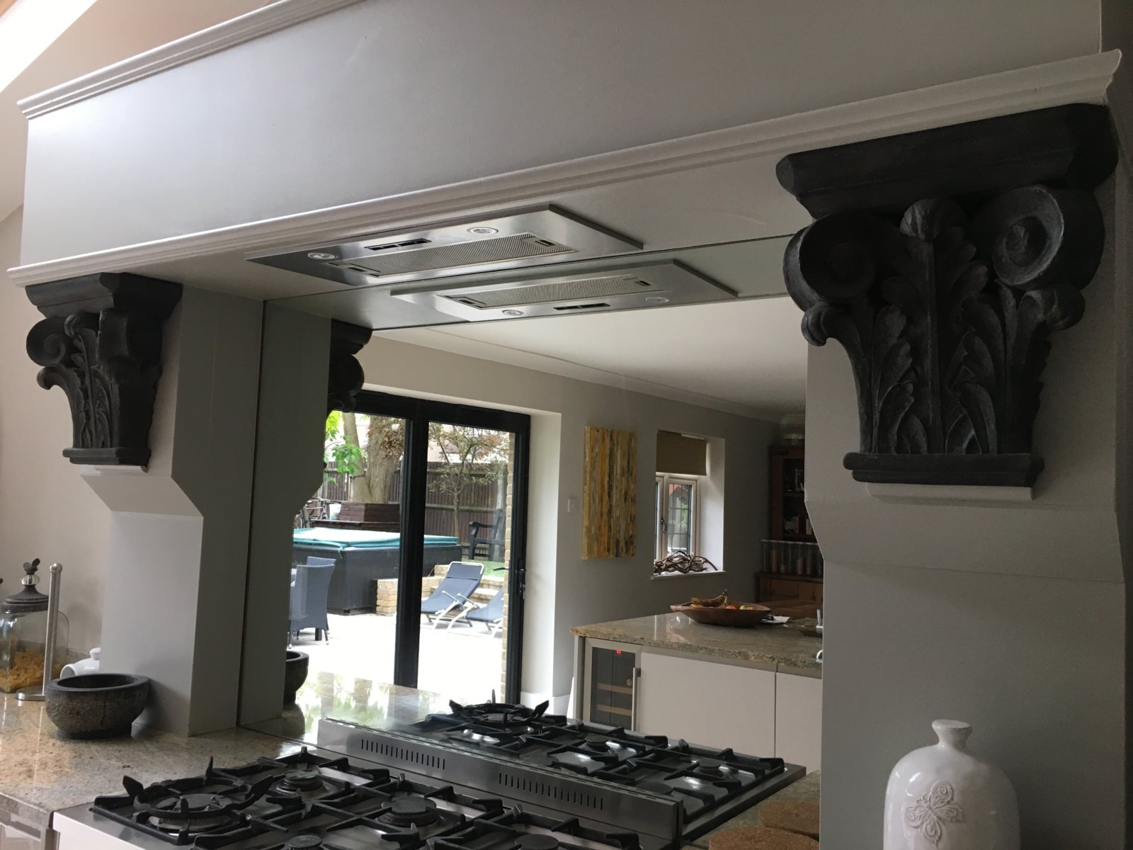

image.jpg Recirculating is no longer permitted in new builds , ( probably because it’s pointless and ineffective) but you can install if you wish .
You will have the added expensive of changing the carbon filter several times a year .
Could cost more than the unit in filters per year .
I connected mine to roof vent .
