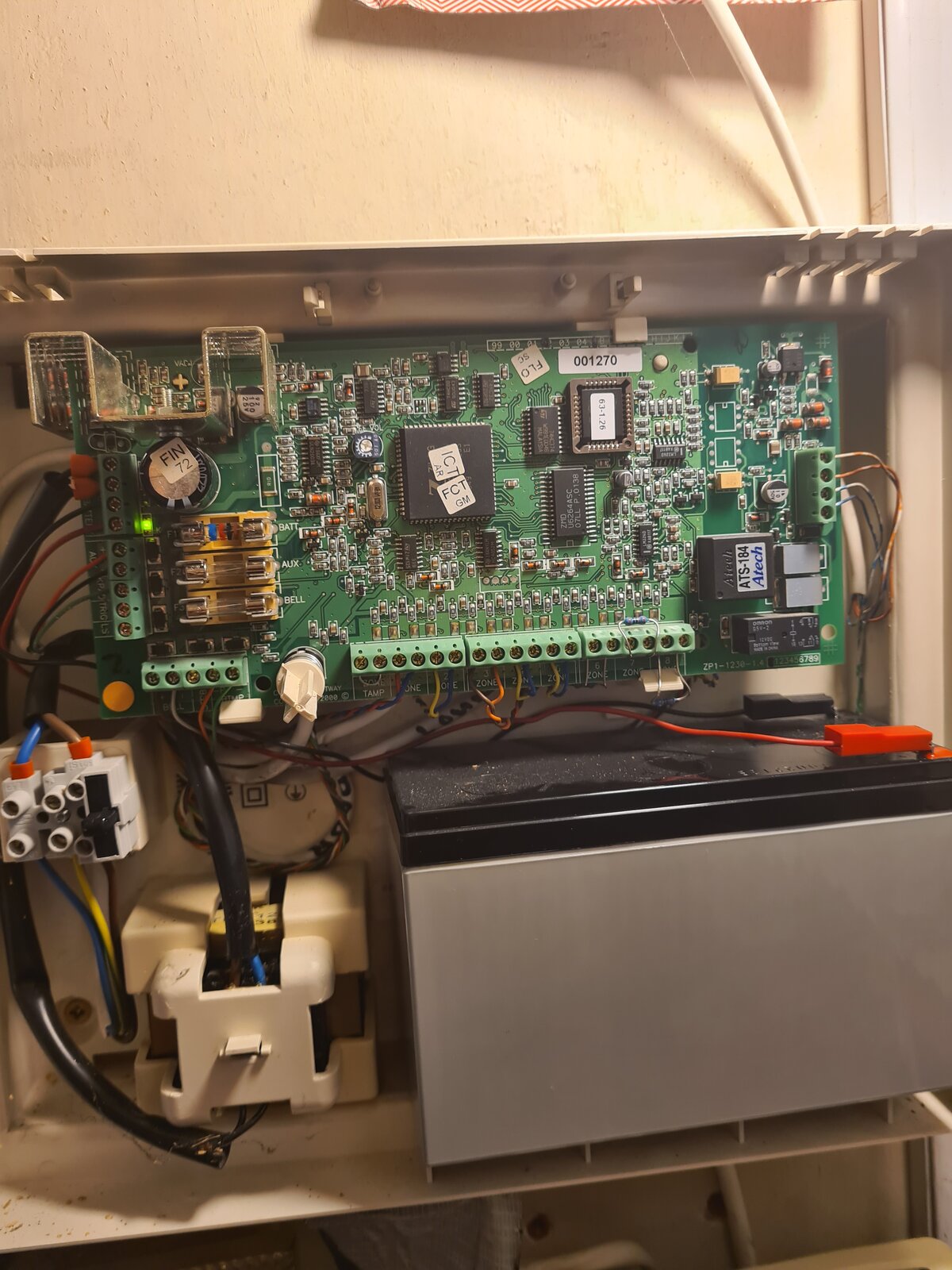

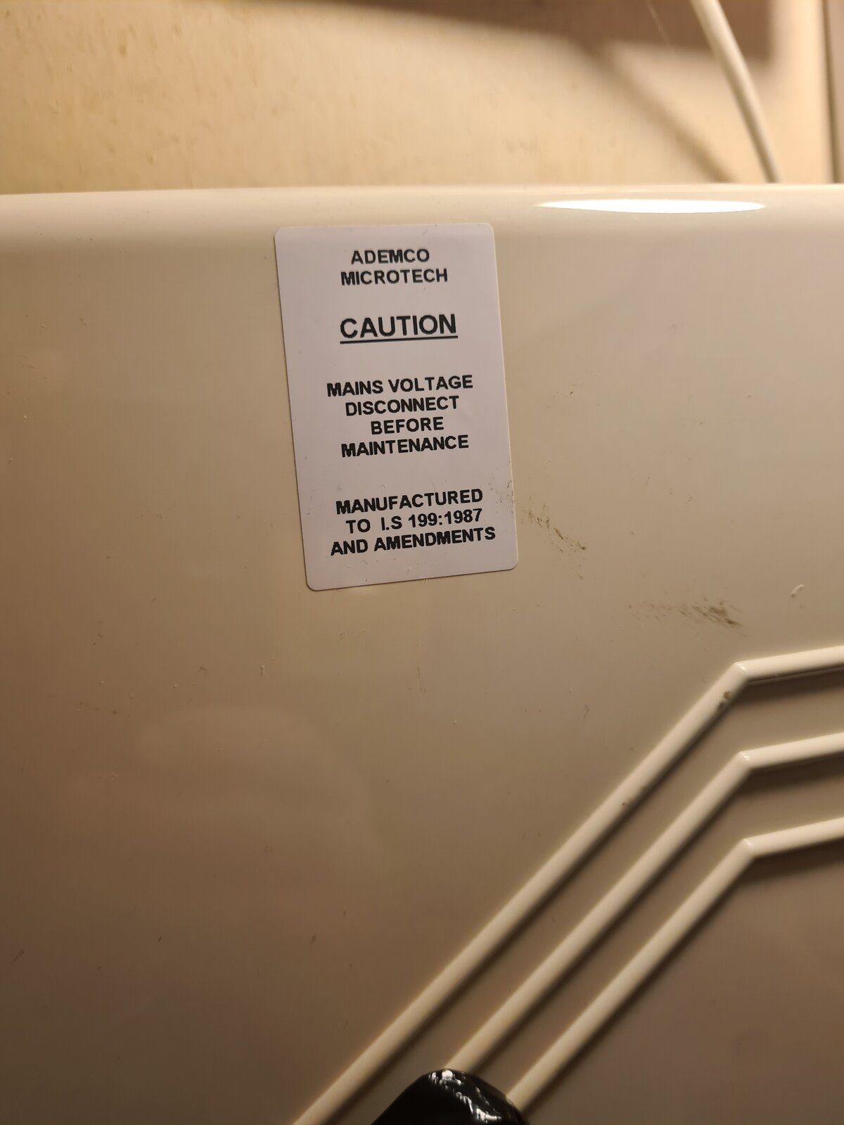

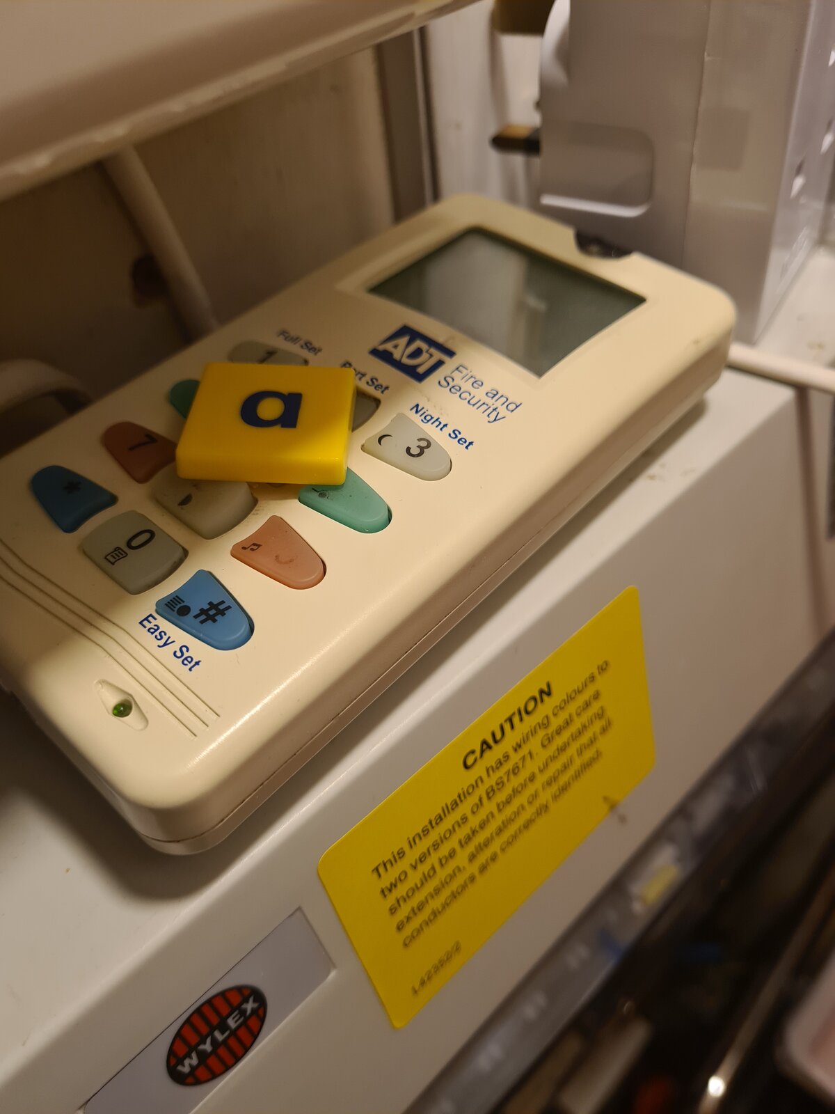

Hi i have a very old alrm system. Keypad has stopped functioning properly even after cleaning.
Can someone please recommend a new panel and keypad, would like to keep the existing wiring and sensors. Would be great if the new panel and keypad could be connected to the internet to monitor remotely. Thanks

You can swap for a Galaxy Flex FX20. The medium case size will be ok. Any MK7 or MK8 Galaxy keypad will work, with the MK7 usually selling a bit cheaper on eBay. The older Galaxy G2-12/G2-20/G2-44 will also be okay, but that range is quite old now.
Thanks for the reply. Any recommendations for something with smart features. Thanks
The Flex supports app, self monitoring and home automation. Capabilities depends on modules you add.
That's the panel and non-prox keypad which can be used as a direct replacement of what you have. The following add-on boards provide additional functionality:
A083-00-10 V4.14 - Ethernet module for app control
A073-00-01 - RF portal to support RF sensors and RF remotes / PA buttons
A081-00-01 - GSM module to support secondary GPRS reporting path or for direct GSM based SMS reporting
CP051 MK8 Keyprox Keypad - includes prox reader for user prox tags
CP038 MK7 Keyprox Keypad - includes prox reader for user prox tags
SelfMon VMOD - provides MQTT link to home assistant
