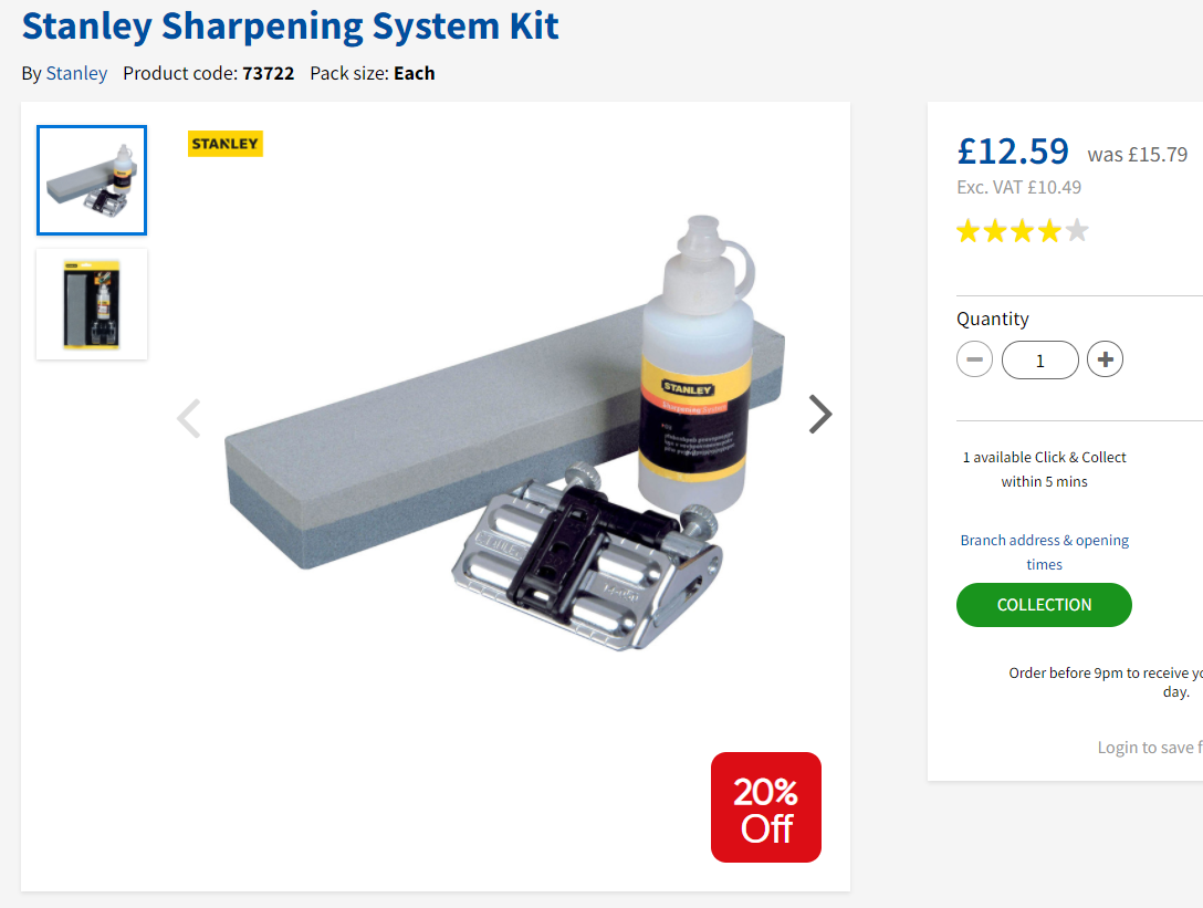

There is nothing simpler, or possibly better than a simple honing guide.
A couple of years ago Screwfix were selling the honing guide plus oil and stone with chisels for the same price as the chisels on their own.

Not wishing to disagree with J&K info and thoughts but I'll offer the guidance what my mentor* told me when I started out with woodwork and needing to keep tools sharp;
Buy a 'cheap' set of Chisels, honing guide and stone - nowadays I'll change the stone to a diamond plate. When you can sharpen those consistantly then is the time to buy better quality.
So for a set of Chisels** and honing guide have a look at these - for silly price they are more than usable.
