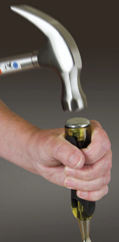

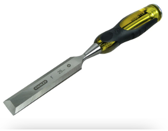

For most of my site work I use Stanley FatMax through tang bevel edge chisels. For an environment where I often abuse chisels they are OK - but being slightly soft they don't hold an edge as well as a "proper" cabinet chisel, however they don't chip as easily as a super hard chisel, either:
being a bit soft they can be rehoned quickly on site and the through tangs with striking caps on top mean that they can be driven with a hammer - not something you should ever do with "good" chisels, for which you really need a wooden mallet (source Crown Tools or Joseph Marples, both in Sheffield). So a chisel which is good for one set of tasks may not be the best for others

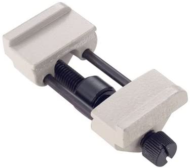

The honing jig he is using looks like an Eclipse#36 (nowadays sold as the Spear & Jackson 94-360R when it's in stock)
or one of the many "knock off" versions on the market these days, often for under a tenner (although they may require a bit of a touch-up with a file to start with). I've tended to give apprentices one of those as sort of "training wheels" when they start sharpening stuff as they take a lot of the uncertainty out of the sharpening process for a novice.

Regarding the honing Spear & Jackson 94-360R jig, it is out of stock as you say. I can look for it or wait, but if that fails are there other good jigs that are as good
You can just buy a Draper or a Faithfull guide and tune it, TBH even the Eclipse/Spear & Jackson has always needed a bit of fettling:
I know that seems like a lot of faffing around, but for a tenner and a wee bit of work with a file (ideally an aluminium file - what he calls a "chipbreaker file", but an ordinary coarse cut mill file does almost as well) you get a really good honing guide. The only better guide is a Veritas mk.2 honing guide which will set you back £50 to £60, or a Lie-Nielsen at £125 for the honing guide (phew!). As a beginner I'd go the cheaper route until I was sure of what I wanted to do
