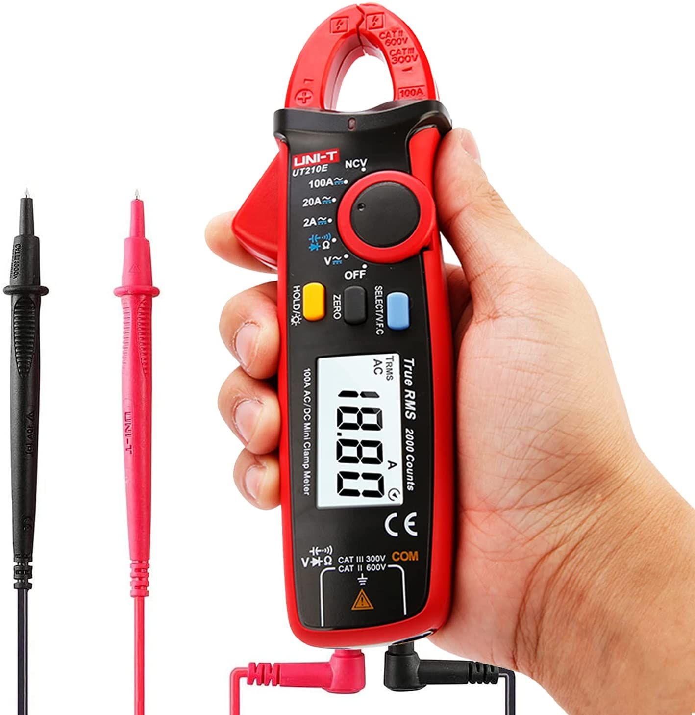

I have asked for this one non of my children have got it me yet, 1655224788053.png but it will read down to 0.001 amp so can check for earth leakage, and it also measures DC amps, and about the cheapest I can find. Since no wired amp range there is no way to cause a short circuit using it.
Sorry wrong type of multi-function tester, however calibration is a mute point, sent PAT tester away for calibration, and it did not say at what insulation resistance it showed pass light, so requested to know what the pass level was, seems they could not find the traceable record, and requested it was returned, then said it was too old to calibrate to modern standard so all PAT tests were invalid, what was the point in getting it calibrated?
I now just re-test some item with know results before and after using so I know if drifted, and main point is I know before I have a whole load of tests which will be invalid if it has gone out.
I have asked for this one non of my children have got it me yet, View attachment 272094 but it will read down to 0.001 amp so can check for earth leakage, and it also measures DC amps, and about the cheapest I can find. Since no wired amp range there is no way to cause a short circuit using it.
I have one of them. I bought it for the DC mA range to find battery drain on the van.
