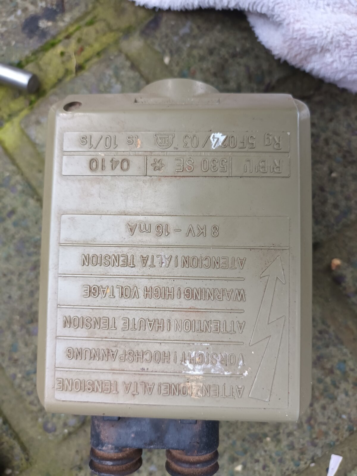

OK, I have the same 530SE control Box and took a few readings, the first thing I should mention in case I forget it is I think there are two types of photocell, digital& analogue?, mine measures 434/3890 ohms light/nolight so maybe compare your old and new with this.
Other readings (terminal box)

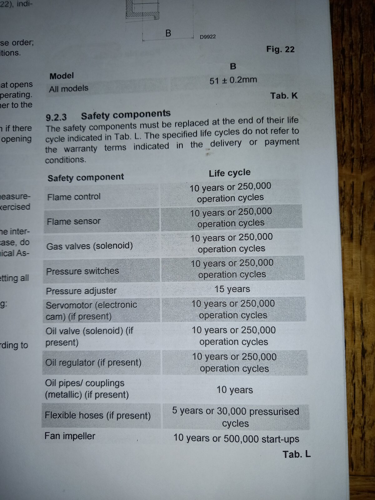

Today I was fitting a Grant boiler house model burner is supplied separately in a riello box. Included in box 2 manual for burner.
Picture is page 23 of manual.
As you can see Riello look to be recommending most parts are changed at 10 years!

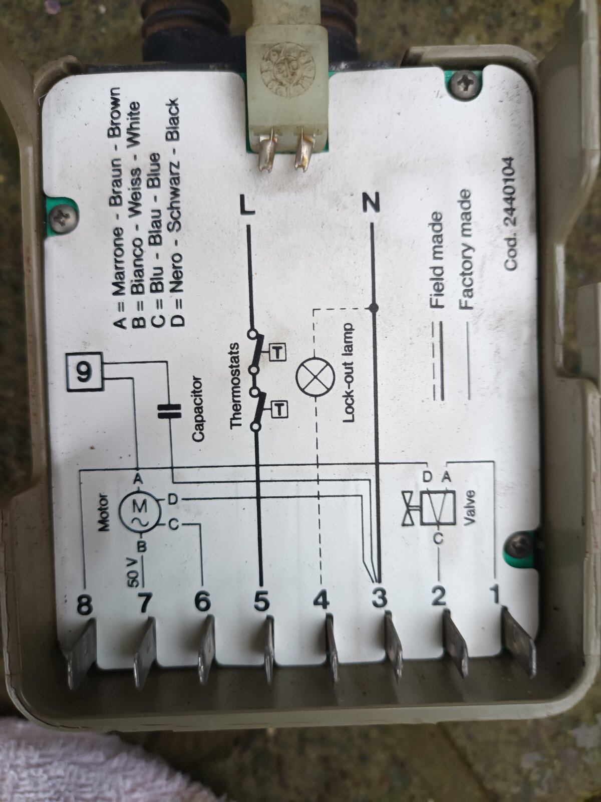

A typo above, its 1 to 2, brown to blue = 1450 ohms and 8 to 2, black to blue, is 1442 ohms so obviously 230V to pull in the coil and maybe 50V hold in voltage, so worth at least checking those terminal connections, it might be possible to monitor the hold in voltage somehow when the boiler is running?, stick a pin into either the blue or brown wire, at the coil and check both voltages with a M.meter?
I can now confirm with the help of my wife's small darning needle that the coil holding voltage is 54V via terminal 8 and the black wire, as shown in the schematic.
Its a bit surprising IMO that while it takes 230^2/1450, 36.5watts to close the valve it only requires 54^2/1450, 2.0watts to keep it closed.
Correction re coil resistances, black wire to blue is 1.7 ohms re my M.meter but per manufacturer 1.4 ohms) I'm told that during ignition 30V DC is supplied to the brown (1450 ohm) and 3VDV is supplied to the black wire (1.4 ohm). I,ve no idea why I'm getting 54VAC on this circuit, can't get any DC reading on any of the DC scales.
With boiler/ running, as well as the apparent 54VAC on the black wire (1.4 ohm),I also measured (today) 4.74VDC on the brown (1450 ohms) ,wire this means that IF this is the holding voltage then the coil power is 4.74*4.74/1450, 0.0155 watts, if one ignores the apparent 54VDC on the black wire then it means that the closing power, at ignition conditions is 30^30/1.4, 642.9 watts. Doesn't make much sense to me.
If 4.74VDC was feeding the black (1.4 ohms) (closing wire) at ignition conditions then the closing power is, 4.74*4.74/1.4, 16 watts
and if 30VDC was feeding the brown (holding wire) wire then the holding power is, 30^30/1450, 0.62 watts. This makes far more sense but not what I am measuring.
The manufacturers figures are 30VDC & 3.0VDC and 1470ohms (brown) & 1.4ohms. (black) which is more or less what I measured, (resistance readings)

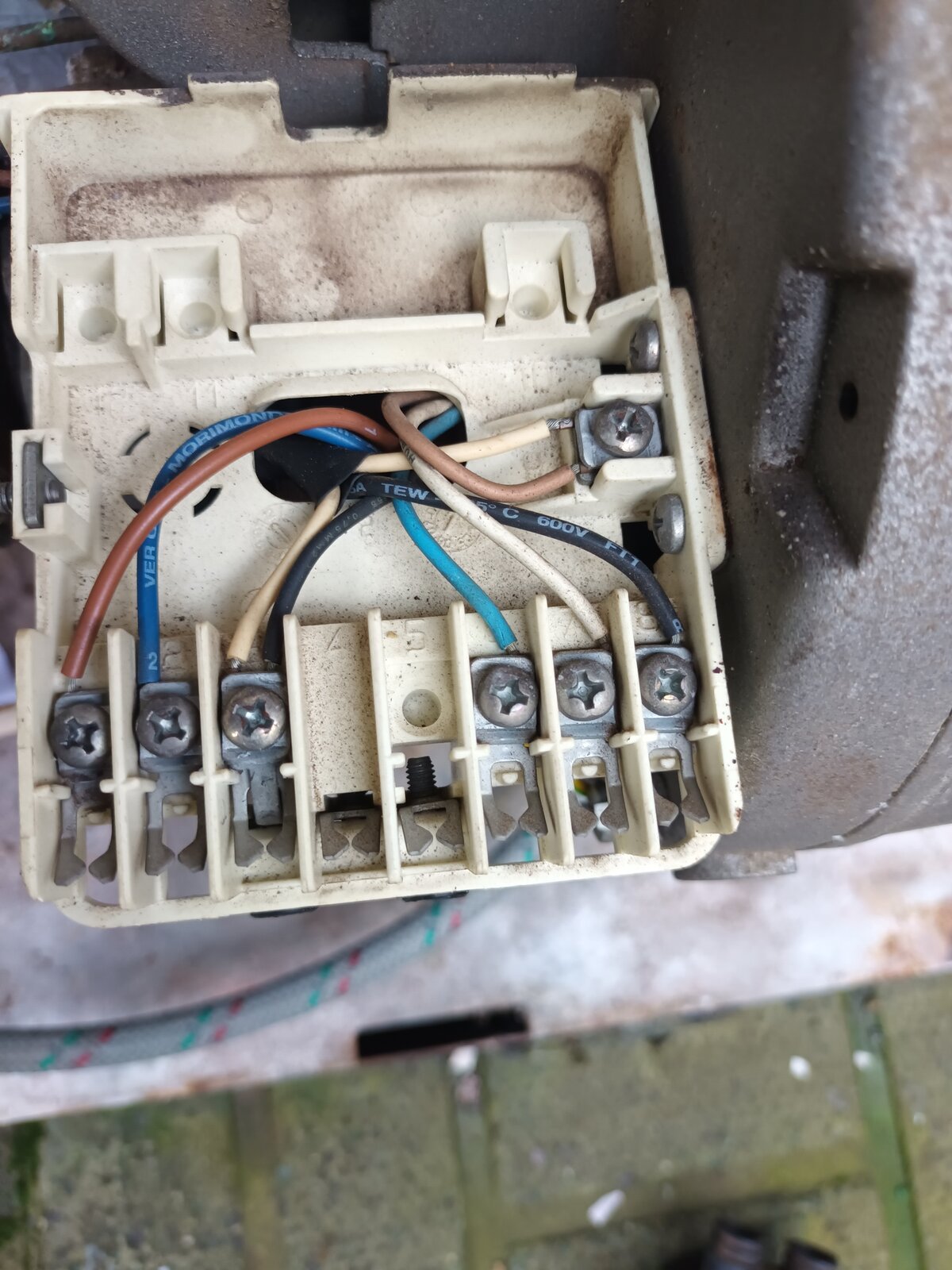

I ran 3 flying wires out of the terminal box bottom from 1, (brown wire), 2, common blue from the coil and 3 from 8 (black wire)
On start up I get 25VDC from the black wire (8) immediately on start up and this voltage remains there throughout the firing cycle. 12 secs after start up, pre purge. I get 5VDC on the brown (holding wire), 0 VDC up to this 12 sec which is correct. If I probe from the coil common (2) I get a continuous 25VDC from start up to finish.
This is not correct, to prevent oil dribbling out of the nozzle as the fan/oil pump motor is running up, the NO oil valve restricts the the pressure to below 5 bar and returns this recirculated oil to the tank, 12 secs after the prepurge is complete 25/30VDC should be supplied from the black wire, probably at the same time (by my stopwatch ) 5V is also spplied to the brown wire (this allows the oil pressure to rise to 8bar to 10bar running pressure) BUT the 25/20VDC to the black wire should then be switched out to the coil. Also if 25VDC is supplied to a 1.4omh coil then the power, theoretically is 446watts, probabl OK for a few seconds but not continuously.
I also get 54VAC as well as the 25VDC on the black wire and 24VAC as well as 5VDC on the brown wire while energised.
I also removed the burner from the boiler and ran it for 4 consecutive 9 sec periods, stopping it before each 12 sec prepurge elapsing/ignition, 36 sec in all, I couldn't see any sign whatsoever of a oil dribble from the burner which one would think should happen if the solenoid valve is energized from the very start.

You might consider doing the following sometime like what I did.
Connect 3 flying wires (short lengths of cable) out of the terminal box bottom from 1, (brown wire), 2, common blue from the coil and 3 from 8 (black wire)
Connect your M.meter between 8 and earth, start up the boiler, check that you get 25/30VDC immediately and until the burner either trips or keeps running.
Next connect M.meter between 1 and earth, start the boiler, on boiler start up you should get 0VDC, if the ignition sequence continues long enough (in my case 12 secs, the puge period) you should then get 3 to 5VDC.
Finally connect M.meter between 2 and earth, start the boiler, you should get 25/30VDC immediately on start up and until the burner either trips or keep running.
Even though I don't fully understand why (1) you get any voltage until purge is complete and (2) why I get 25VDC apparently continuously between 2 and earth as one would think that pin 2 must, at some stage connect to neutral, so voltage between 2 and N should then be zero, it doesn't really matter because my burner works flawlessely with the above sequence.
