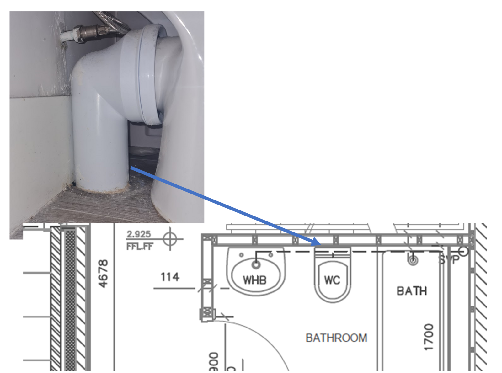

Hi,
I have a toilet on an upper floor, sit in a hollow core floor. The soil pipe is ground entry into the toliet, so to speak, not coming from the wall. The noise of the water rushing through the soil pipe can be heard below in the living room. It is not to my taste, so at a certain point when I install some home theatre gear I want to sound proof this soil pipe. I am thinking of an option a) wrapping in an accoustic wrap like Tecsound FT55 Acoustic Duct Wrap, b) or replace the pipe with an acoustic model. I am handy at DIY but I am not an expert on plumbing. Given the difficulty in getting a plumber when I live, I want to do this job myself, which option would be best in your opinion? Is replacing the noisy bend which creates the noise tricky to do?
Any mods to the pipework are likely to be tricky due to access. Pics or a sketch would help.
If it's a noisy 90° bend you might get some noise reduction by using a rest bend or 2 x 45° bends instead.
Packing the duct space (if its in a duct or boxing) with dense rockwool might be an easier starting point.
This might help

I have done some research on the acoustic wrap. It looks great, but it is very thick and heavy material. Hard to work with in tight spaces.
Stuff the acoustic rockwool around it and board around that with something heavy eg cement board or that purple plasterboard, ideally a double layer. Make sure the pipe is not touching any timbers, ideally clip to dense material only ie brick wall
