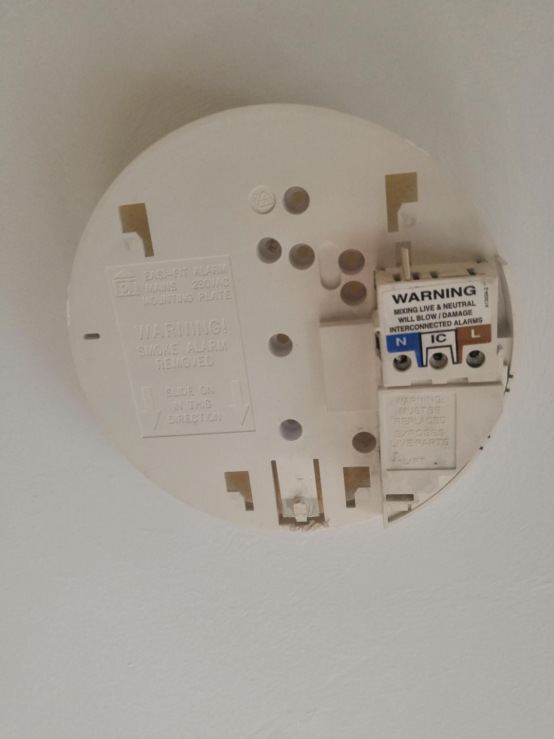

Not long moved in and currently decorating. We have two smoke alarm bases in the hallway, now redundant as previous occupier installed battery only rf smoke alarms. These bases are currently live. Can I just maintain their connections and poke wires into ceiling (it's a bungalow, but this bit is covered by tongue and groove board, so not easy to access)?

You can presumably disconnect the cable that runs between the two alarms. You might be able to remove it.
Is there a label in the consumer unit stating on which circuit it is?
Make safe with junction box and label what it is and when it was removed. Push up behind ceiling.
Other option is buy new ones and slide on existing base as they are mains powered and linked.
I've done that with mine
Just don't bodge up and stuff away with a bit of tape around.
Interesting choice to replace with RF units IF the old ones are connected by 3 core and earth
Maybe that's the answer? And ditch the RF ones.

Sitting room lighting circuit. And I'm sort of leaning toward sticking new units on the bases, or just replace the whole thing like with like and ditching the RF ones. One thing, had a little look on fleabay and there are loads of the bases for sale (just the base). Why would people want to buy new bases?

If you've ever had a terminal screw that doesn't tighten, or you've broken one by accident...

Buy smoke detector and slide on old base then put the new unused base on eBay.
Who would buy a new base? That's a good question you asked and I thought the same.
Also the brand I have changed the model numbers but I discovered the new type fits the old bases. Result... bingo.
