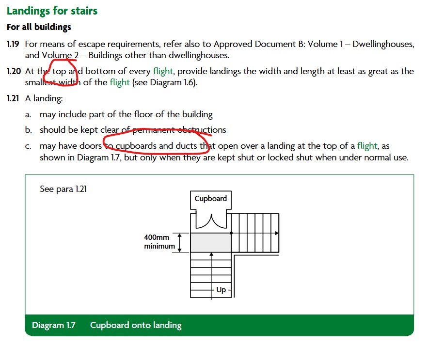

I'm looking to put a door, which would swing inwards, into an attic bedroom at the top of the stairs going up to the room. I've seen a lot of talk about the need for 400mm clearance between the top stair and the door, but looking at section K1 of the building regs, everything it talks bout and all the diagrams relate to a door swinging outwards. Additionally, all the rationale I can find for the building regs talks about the dangers of a door swinging out across the stairs and causing an obstruction.
So the way I read them, the regs don't actually specify anything for an inwards swinging door, and I've certainly seem some posts backing that up. But as I say, I've seen other posts which seem to ignore which way the door opens and say 400mm is required anyway.
(In terms of actual usability, rather than regs, the design I'm working on actually has about 250mm clearance before the door, so it's not like the door opens straight onto the step)
The landing width and length need to be at least as great as the smallest width of the flight. The 400mm bit is only applicable to a cupboard door not a bedroom door. It was discussed and part K links posted in this recent thread: https://www.diynot.com/diy/threads/...anding-and-new-door-regs.586817/#post-5922572

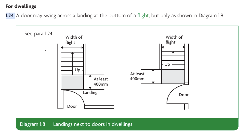

I still can't see exactly which part applies... there's this part, but it only talks about doors swinging across landings:
Your diagram only applies to the bottom landing. I thought you were asking about the landing at the top?
Yes, you're right actually, hadn't spotted that. But now I'm even more confused, as there doesn't seem to be anything at all about doors at the top of stairs?
It says the top in black and white, it may include a door swing within 400mm but only if its a cupboard.
Ah, gotcha... the references to doors are all essentially red herrings in this situation, it's purely that 1.20 that counts. I think I was distracted by looking for the references to 400mm etc!

You can open the door any direction you like but in any case the landing must be as already mentioned.
You approach the door coming up the stairs, it happens to be closed, you need (what Building control deem) is a safe area at the top of the stairs to open the door so that you can enter the room, for some silly reason they think you should have a full landing to enact that and not some slither of a landing or be half stood on the first step.
Same for exiting the room when closing the door behind you.
You're still not explaining what is unsafe about opening a door inwards from a staircase. And yes, I have searched for an answer and not found one, that's exactly why I'm asking... maybe if it's beneath your incredible intellect to give me an answer you could just link to all the other ones that I should have found?
Two main reasons. As you leave the room possibly at night, half asleep carrying a baby or maybe you are elderly, you need a stable platform where you can stand as you close the door behind you before you start to descend the stairs. Likewise if you are climbing the stairs you need a stable platform to stand on whilst you open the door whilst balancing a tray of tea and toast as you do it.
Trying to make that transition between doorway and stairs whilst perched on a narrow ledge or step is clearly not safe.
As with all statutory regulations they tend to be written to cover the worst case scenario and an analysis of common household accidents. Falling down the stairs is a common cause of serious injury and death, especially amongst the elderly.
