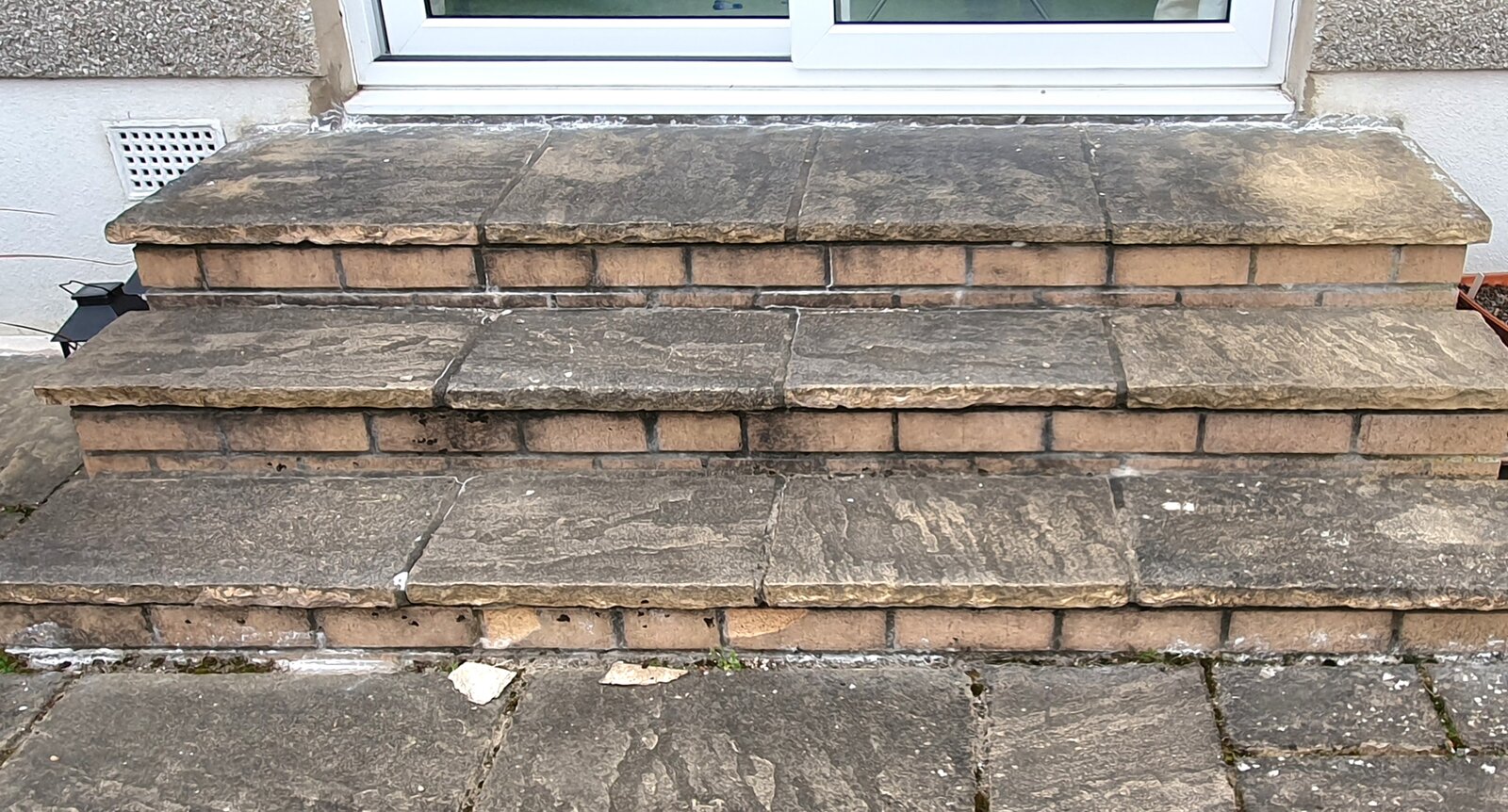

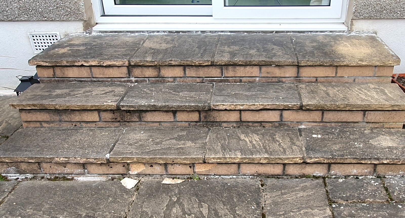

Thanks for the comments. Have measured the top step now, it's 560mm deep, from sliding door threshold out. Also added a picture. I could understand if someone fell backwards out of the doors they could fall a lot further i.e. down the steps which wouldn't happen if it extended out more. Or if the wind caught a door while someone was holding it, it could drag them off the steps. Anyone think it could be different in Scotland? Been told it could be installed with doors opening out but that we'd need to extend the step before selling as would be picked up on survey.

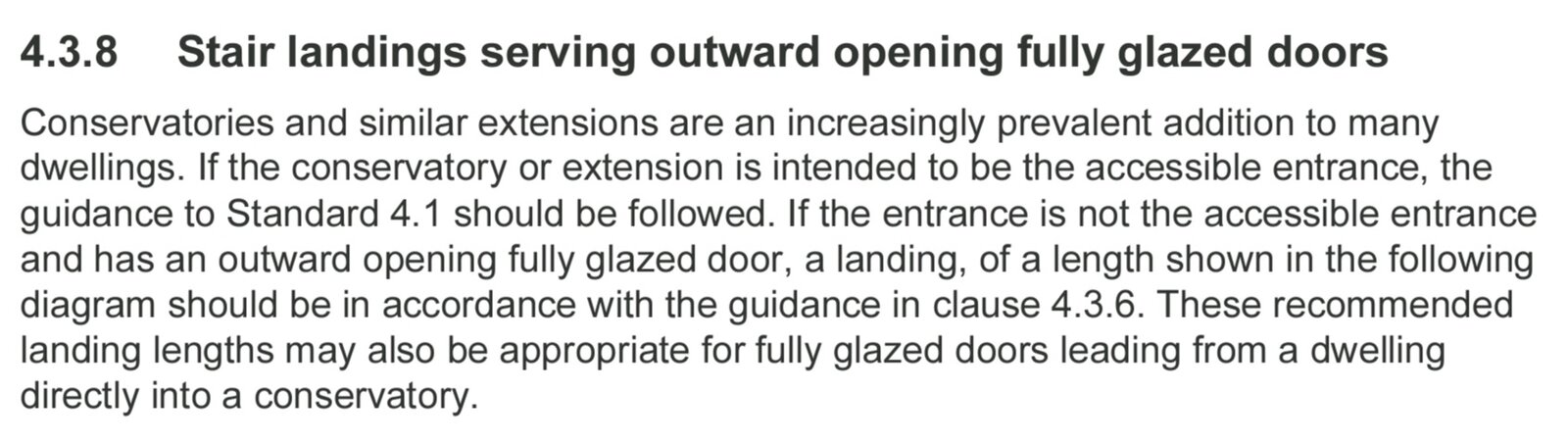

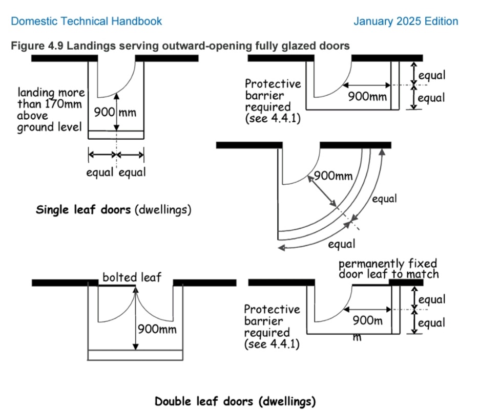

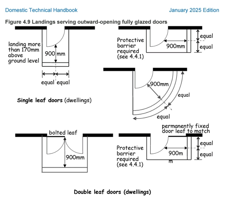

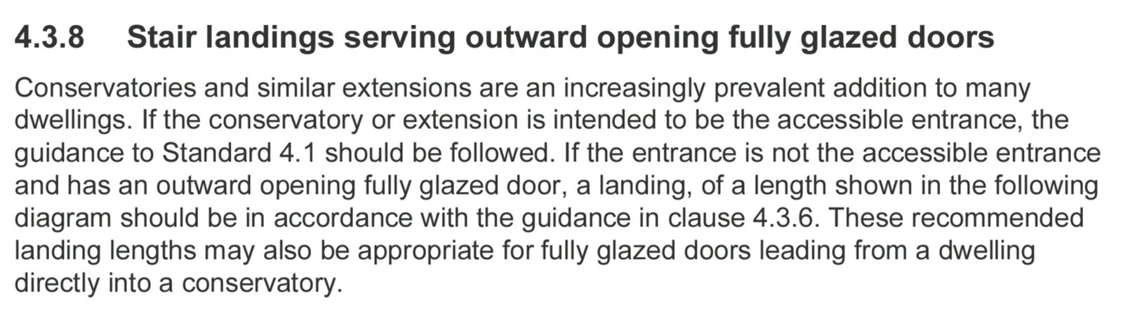

In case any one has this query in future. Scotland regs on this issue attached
